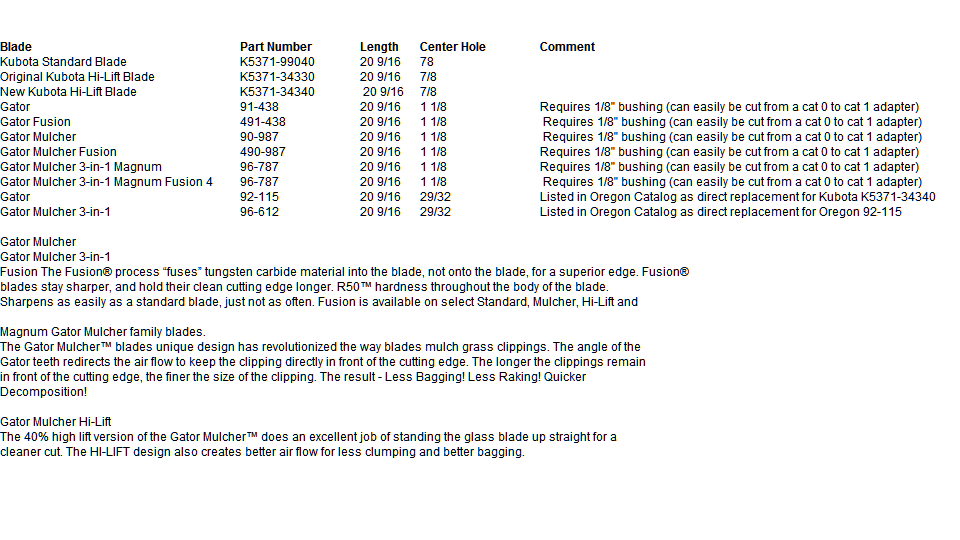

This list is dated but it was accurate when I put it together. I run the 60" MMM RCK60B-22BX on my 2004 BX23, it may be similar to the 60" MMM on your BX22.
I've run the gator 96-787 3 in 1 mulcher for several yrs with a cut down Cat 2 to Cat 1 bushing. I believe Oregon makes a gatorblade now that doesn't require a bushing to fit.
Good luck
Dave

I bought part number K5371-99040 blades from my local Kubota dealer for $18.23 each. I believe from the Volfandt post above that mine are the standard (not high lift) blades. Cuts smooth and sweet like a new machine. Totally satisfied. I had found sources for the blades $5 or $6 cheaper each blade but I like to support my local dealer, I don't like to fight half-assed almost right parts, etc. plus I can splurge every 16 years for a new brand name set.
Note: In chasing 3rd party blade possibilities I found a surprising variety of center hole sizes and equally surprising uncertainties as to what blades fit what decks. Mine are the 7/8" center holes. No bushings. No adapters. No nonsense. Do be careful that you get the "cupped washers" back on the same way they were originally or if they are very flat replace them too. Some other thread on TBN does a dissertation on why these washers are concave/convex and how they act as lock washers even though they are not what you would think of as a lock washer. Apparently the curvature is squashed by the torque as you tighten the bolts and maintain kind of a spring tension over time which helps prevent loose bolts. Some of the more senior authorities on TBN can tell you the name of those type of washers.
Good luck
Dave
Thanks for posting that detailed information Dave!

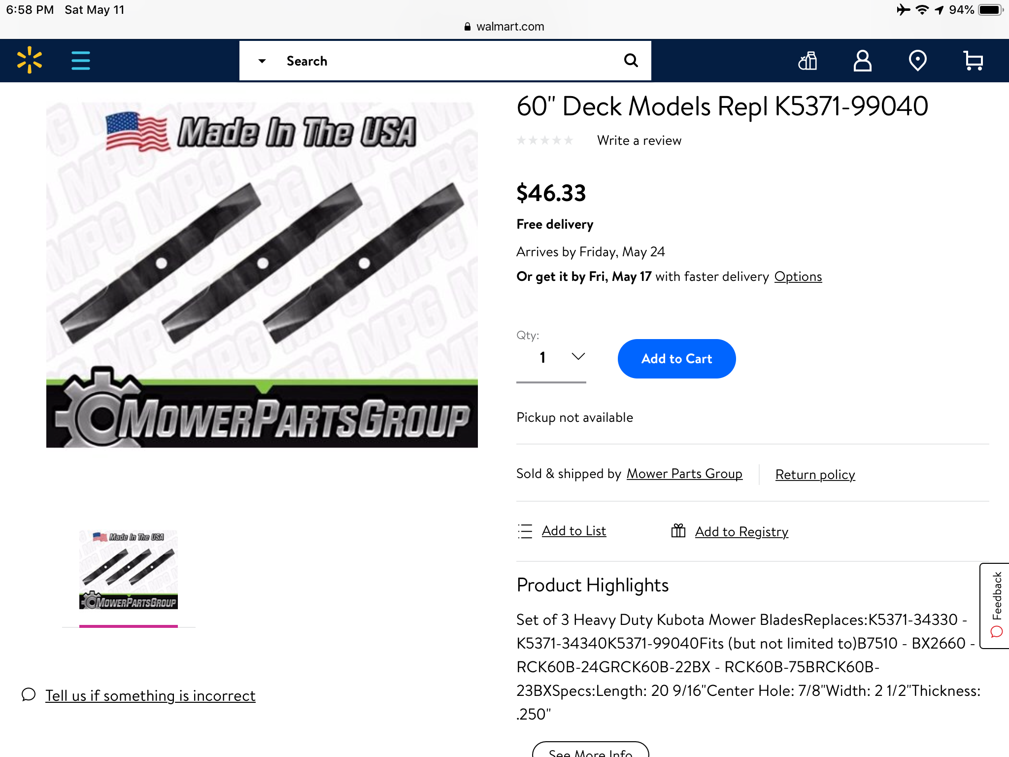

Well, on a whim I decided to order a set of these blades through Walmart.
Made in the USA from foreign steel I suppose.
They will probably arrive at my place about the same time I do, or sooner.
Wish me luck!
Wish me luck!
Good luck as requested ! I'm sure those will work fine since they have the 7/8" center hole and are listed to replace the K5371-99040. The price is not much cheaper than Kubota prices.
It was the free shipping that got me to move. I would have bought Kubota blades if there was a dealer closer to home.
I am using an iPad to post. I previewed this post and the 7/8" center copied&pasted from your quoted text shows up correctly, but shows up strange when entered from my iPad.
