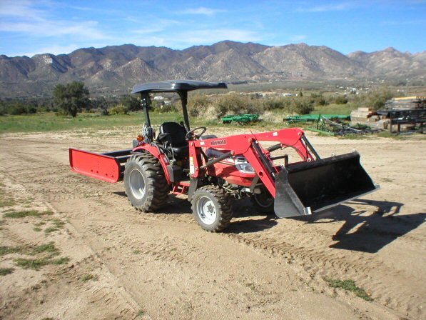

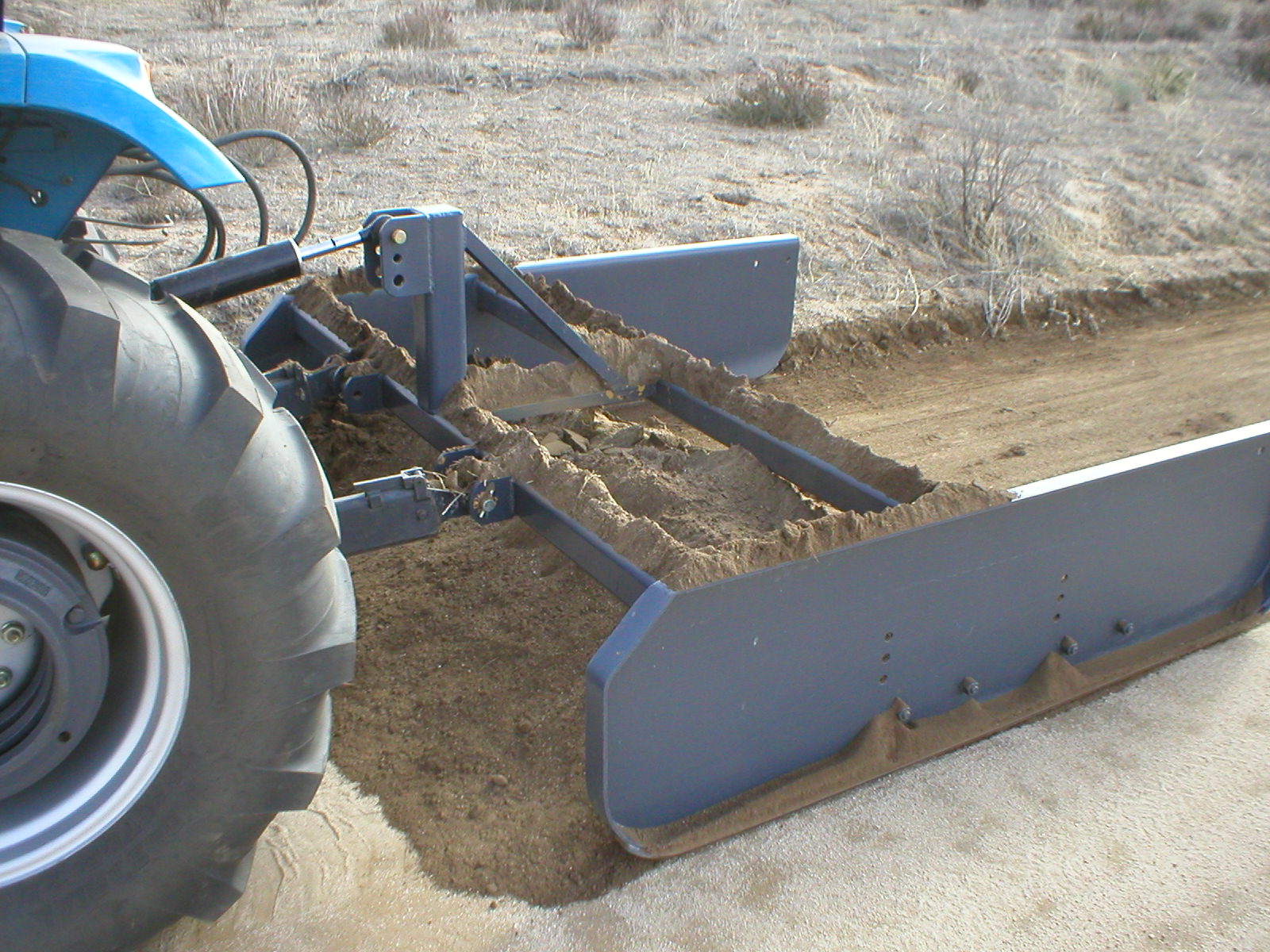

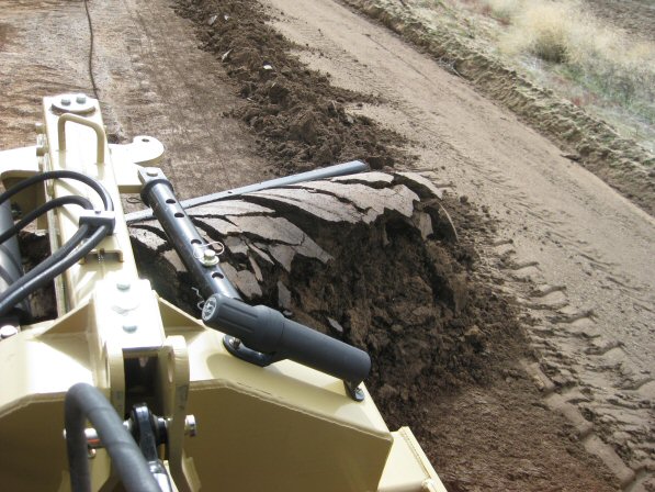

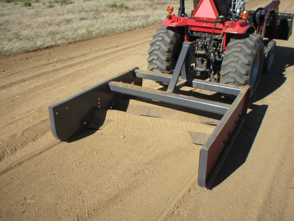

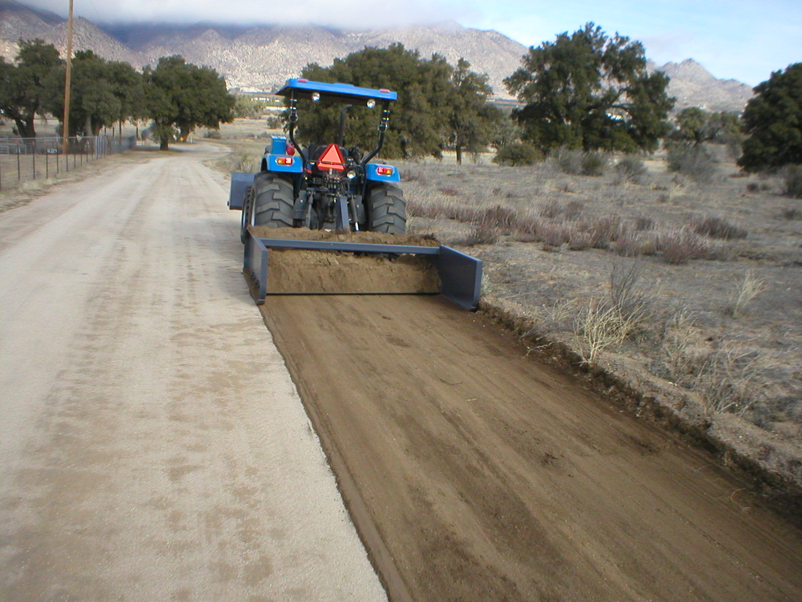

You say that you are maintaining. The best implement in my opinion for maintaining a drive is neither of the implements that you have asked about. A land plane grading scraper (LPGS) is the best , easiest implement to use for road maintenance.
There many manufacturers of these, the link is only an example. For your tractor, probably a 7 footer that weighs at a minimum of 1000lbs and the heavier the better. I would look for the sides to be no less than 16" tall. Mine (pictured) are 22".
Once you have gone over the drive, you can decide what other implements may help you in the future. I maintain over 2 miles of roads and fence lines, I have several different implements for working on these areas. My go to implements are my LPGSers. I have a 7' at 1400lbs and a 5' for my smaller tractor at about 800lbs.
As far as sizes for the implements that you asked about, an 8' for a rear blade, and a 7' for a box blade. Again as heavy as you can afford.
