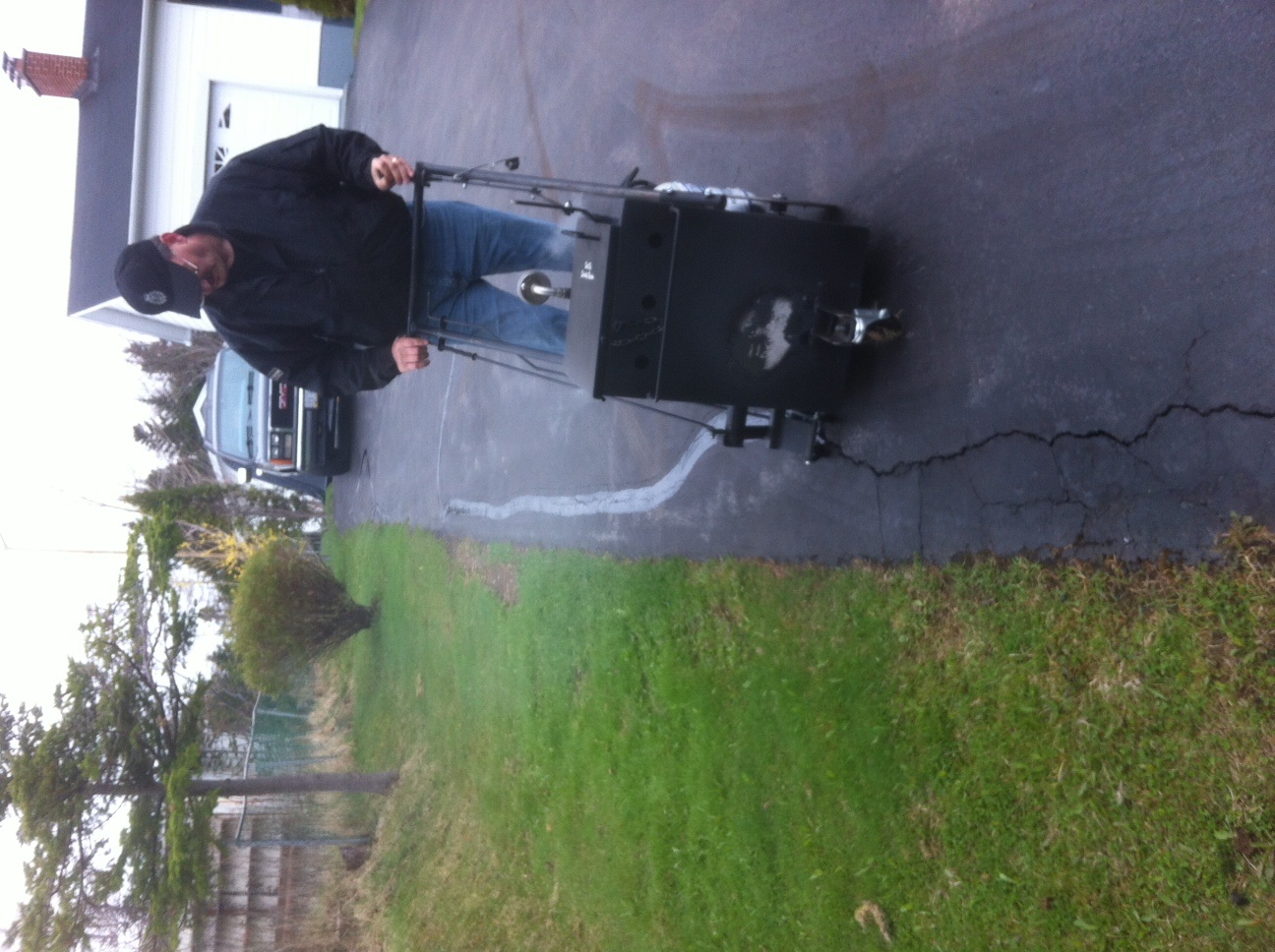

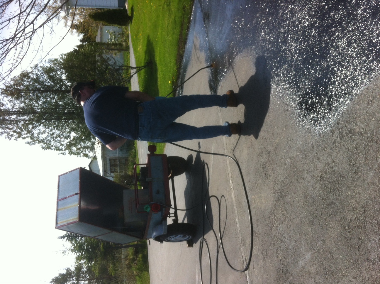

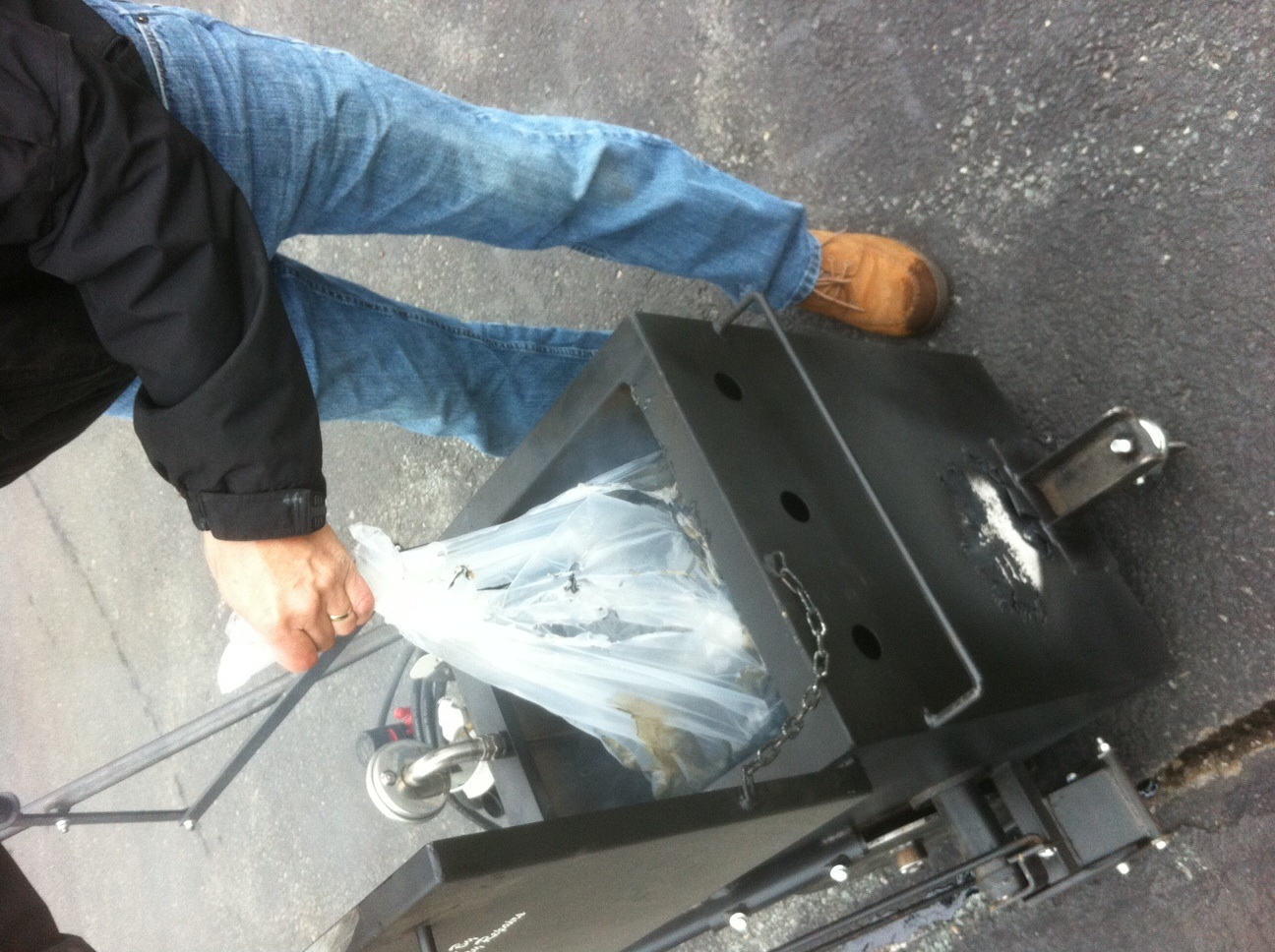

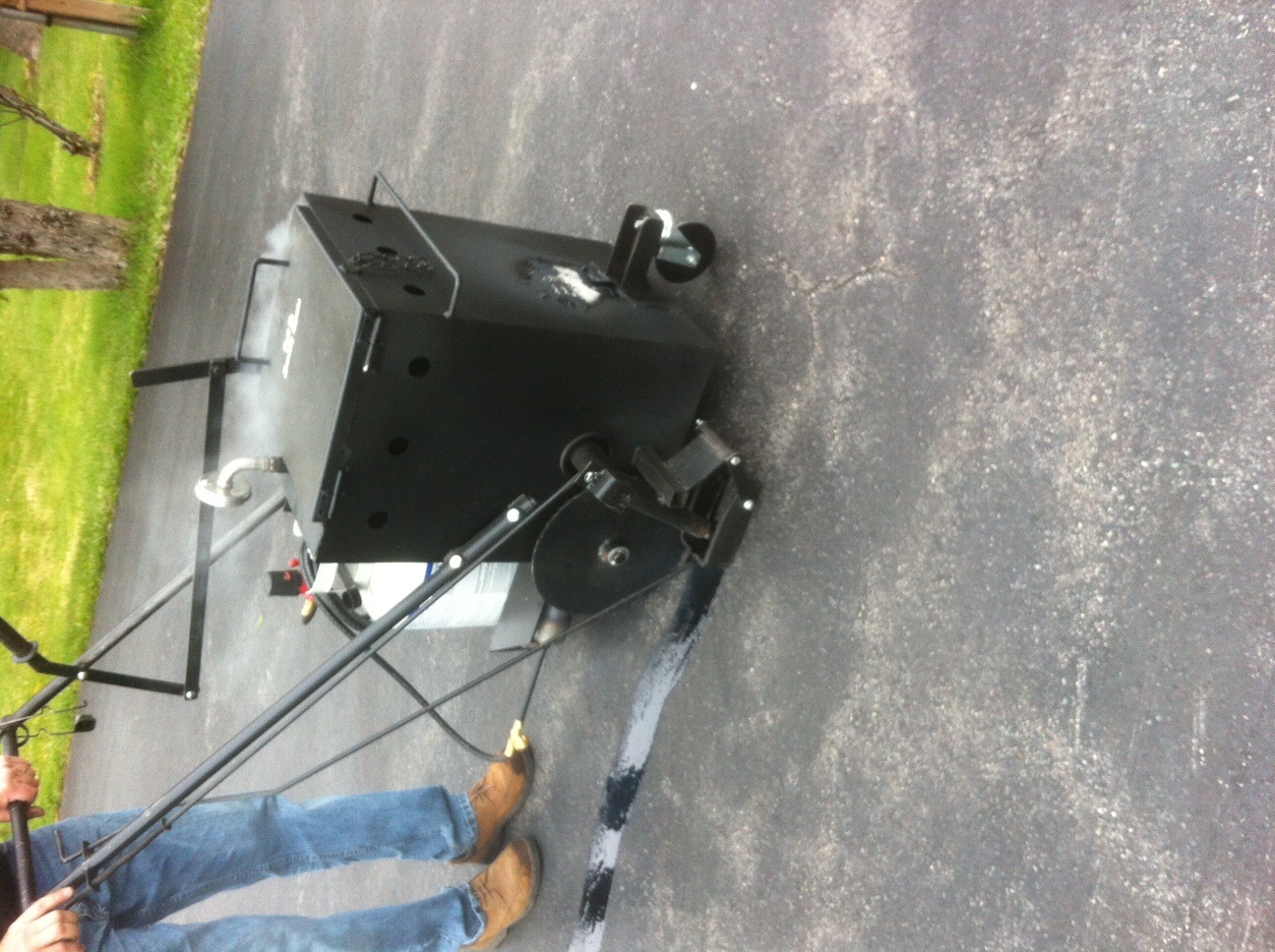

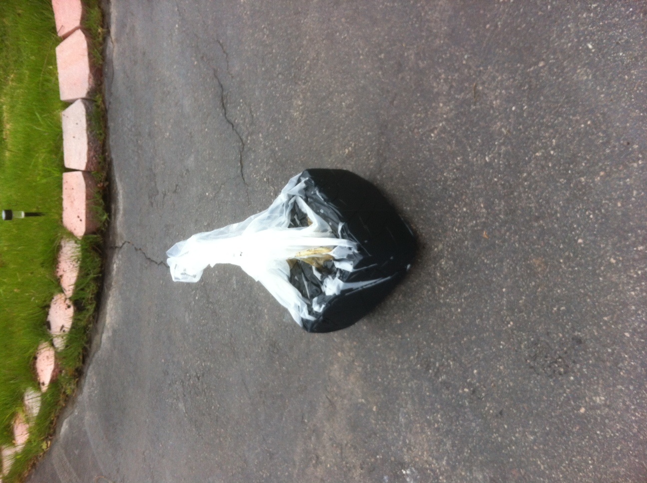

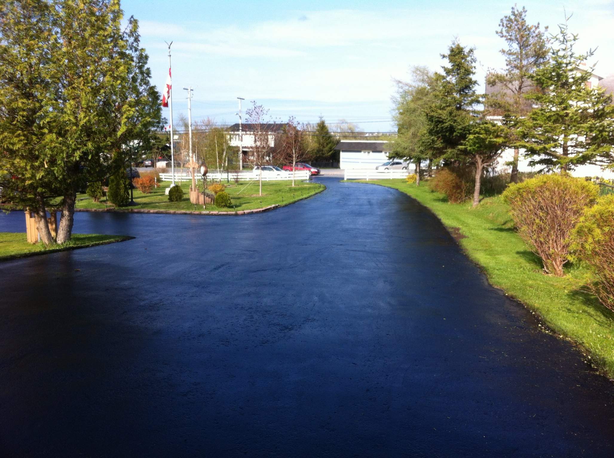

Sealing driveways is a big deal around here. There's tons of guys going around all summer doing it. I built my own machine years ago to apply the sealer and it works great. It do keep the pavement in great shape and keeps the water from getting down in the small cracks then freezing and causing more damage. It also helps prevent any major problems if there's a fuel spill and that can happen considering I run a repair shop behind my home. For any large cracks ill go over it with a melter machine. I'll put the rubber block in the melter and preheat to 400 degrees then spread it in the cracks. It flows in like water and a hour later its part of the pavement. After the cracks are done I seal the whole driveway and it looks new again.
Here's a few pics. If they are sideways it's because I'm posting this mobile ;)

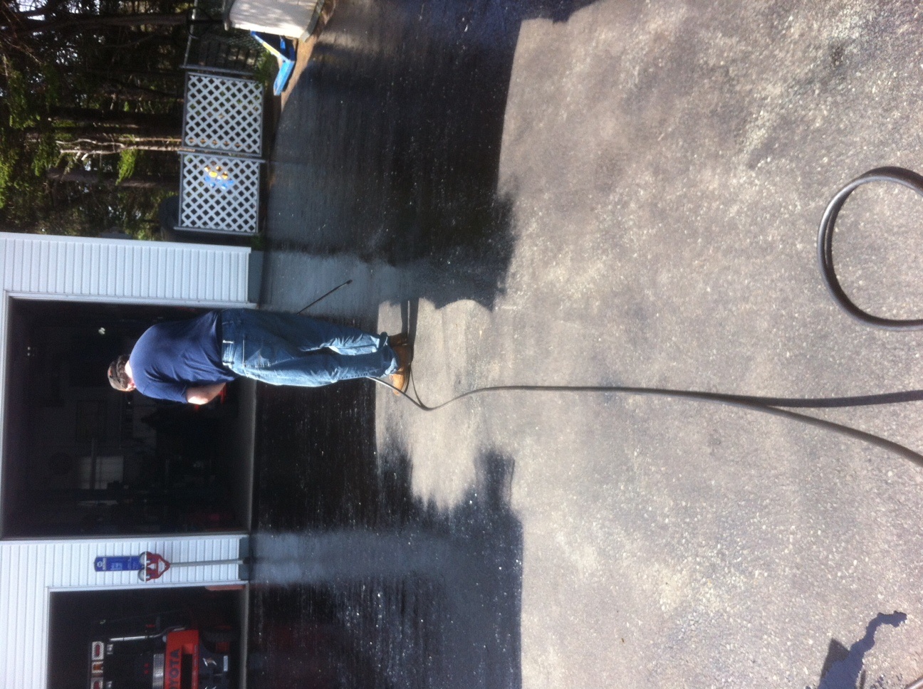

A few more shots.
