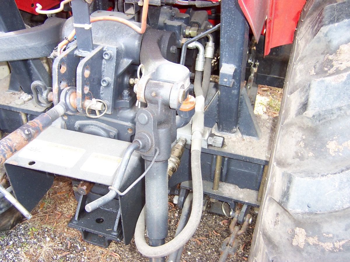

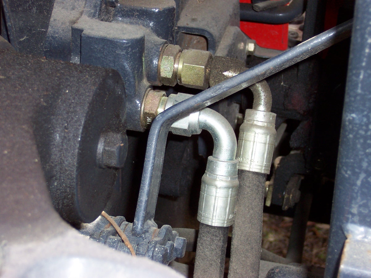

I'm not sure about the joy stick but to get power to the rear of the tractor there are two connections on the right side just above the axle. If you look at it, it has a figure 8 block off fitting on it. You remove this and buy metric fittings to go into the two holes. One hole is pressure the other is return.
I bought a Jinma Backhoe cheap for my 3510 and connected to these outlets. I put a pressure relief between the two hoses for my own piece of mind. IIRC the fittings, short hoses and relief valve cost me about $100.

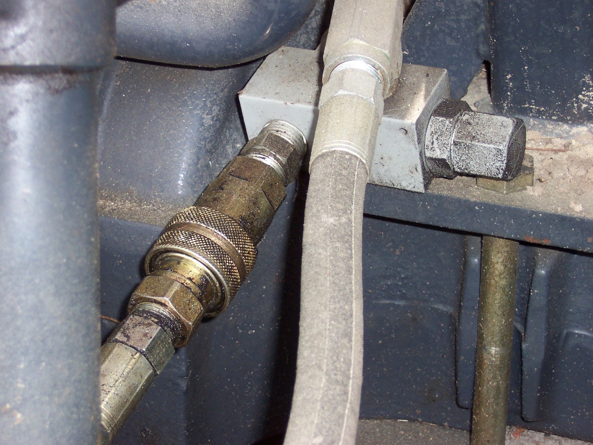

Here is pics of the remote hook up. The top/front fitting is the pressure, the bottom is the return. You can see the relief valve in the circuit. It is just laying on the rear axle. I keep them plugged in when not in use as you always should.

I put the hydraulic lines on to run a backhoe so I don't have any valves that are not on the hoe. The two hyd connections come from the factory with a figure 8 connector, pressure out and then back in.
What do you plan to use the valves for? That will determine how you hook it up.
