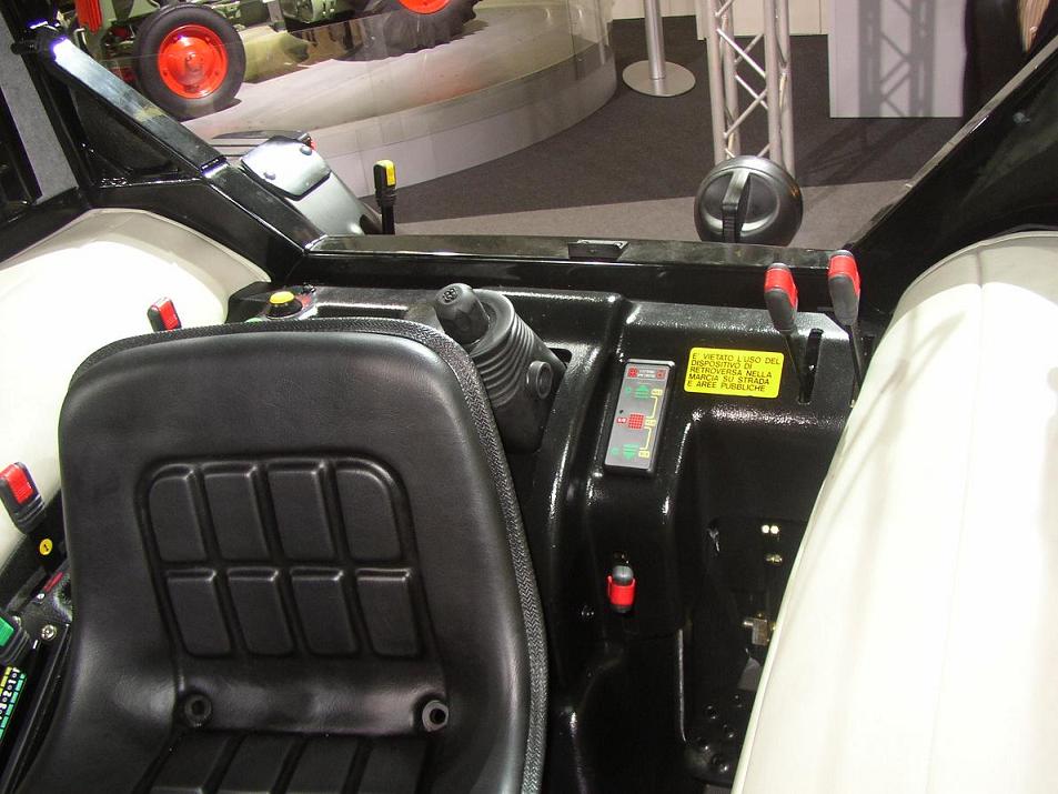

Also, is the joystick to controll your FEL right next to your hand? or is it the "traditional" location next to the steering wheel?? I would like a FEL controller that is like the joystick on a Skidsteer. any pics of it?

ledeburh1:
The joystick (and it is a joy to use) is mounted on the inside of the fender well right where your right hand rests, especially with the folding armrests down. I know that in all the Kubota ad material, there is no pictures of the location and when I purchased the tractor, until I picked it up, I myself didn't know where it would be mounted other than the fact that it was completely remote from the loader.
My camera was inadvertently left at my in-laws over the holidays so no pictures right now. I did want to post my new Lucknow 78 rear mount blower and that will have to wait!!
Actually, the "feel" of the joystick is very similar to the remote option on my 773 Bobcat.

5030, Thanks your joystick sounds just like what I want.
