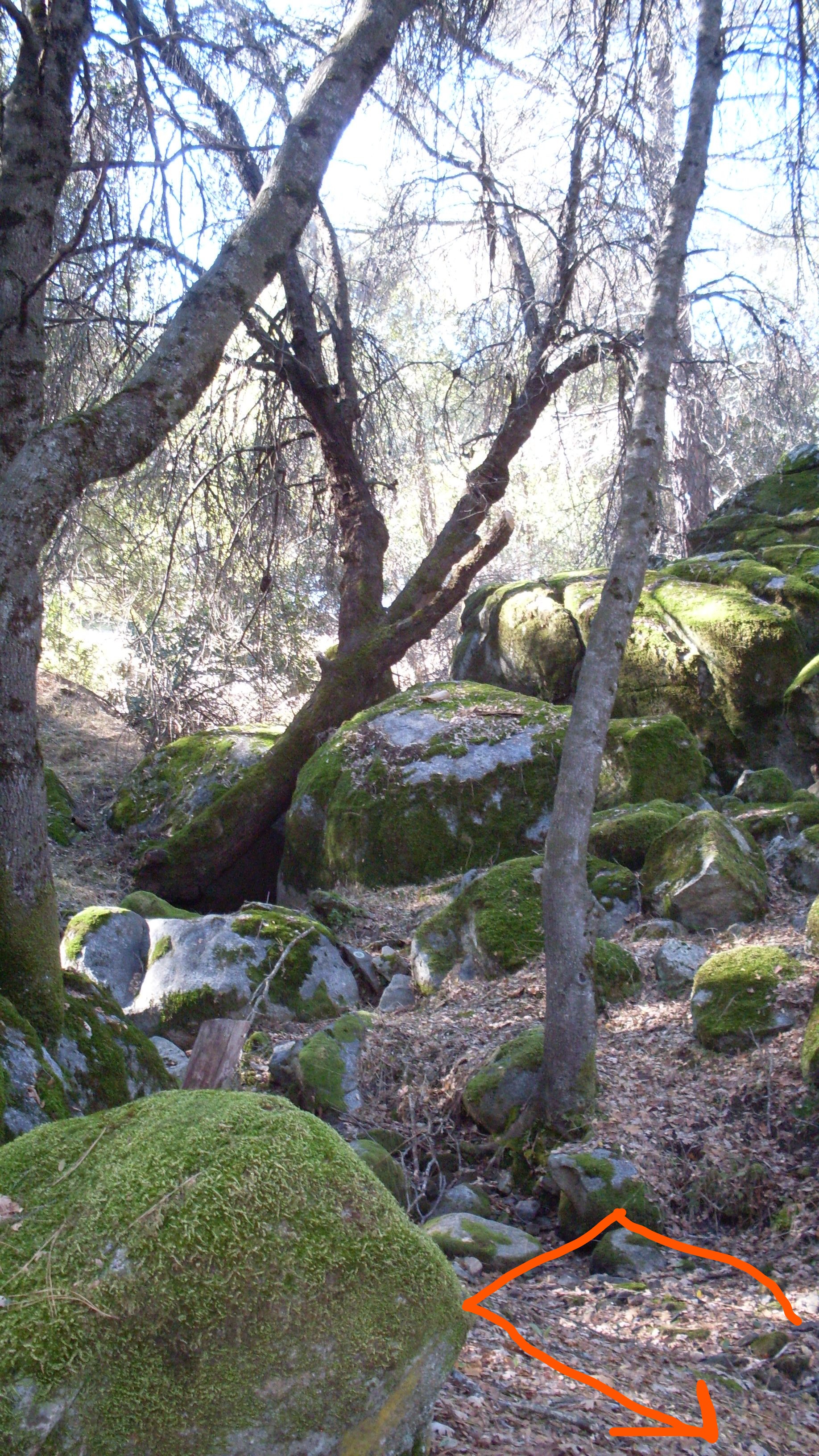

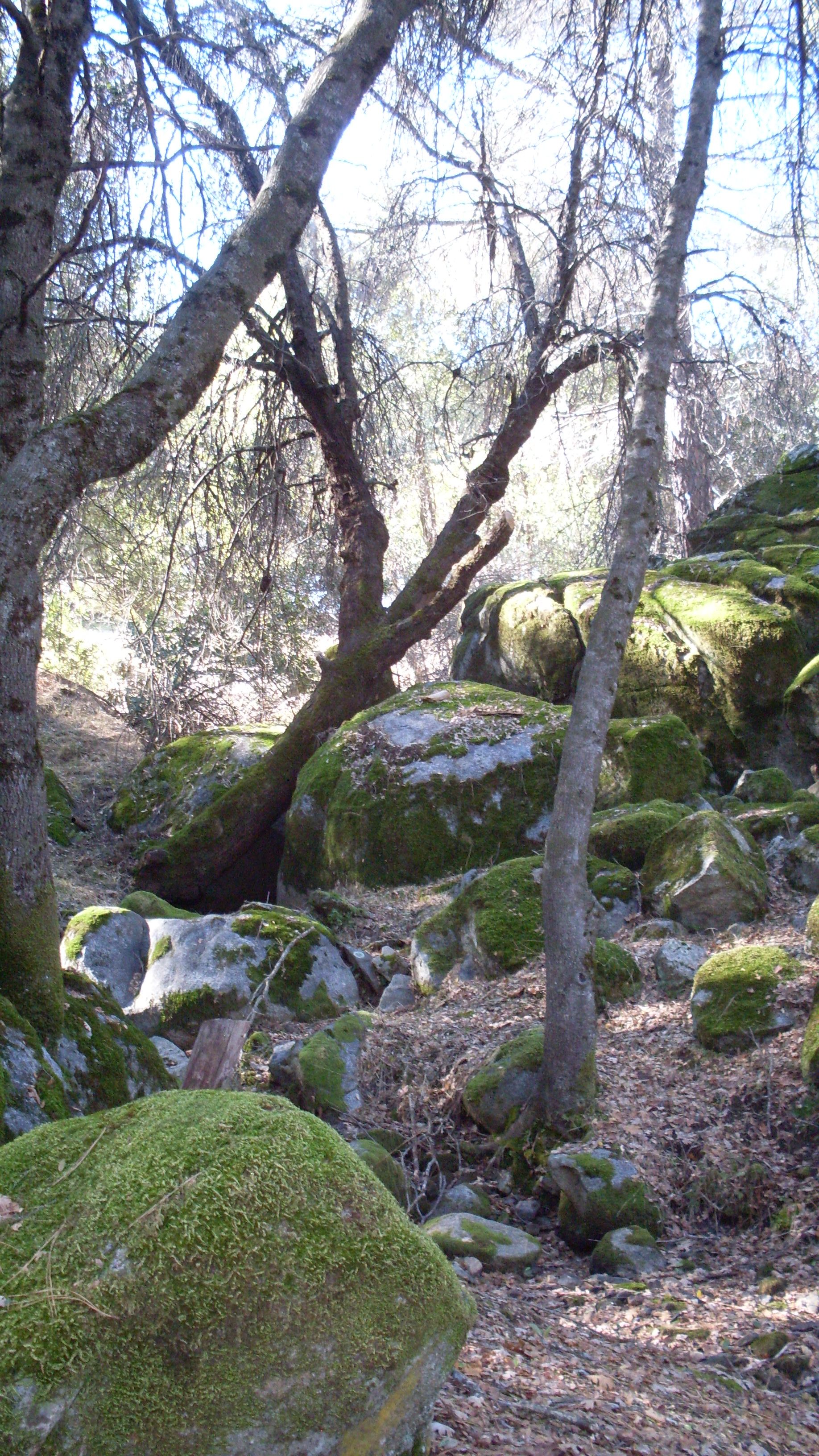

Please explain to me how I can get parbuckling rig in close to remove tree in picture... Yes it's the "Y" shaped one in center of pic... It's oak its very dead and there is no safe ground to use chainsaw to cut from.... And there is a creek about 3 feet behind where pic was taken from so it precludes getting a tractor Jeep with winch in there....
Dale

What about that place where the red lines are, looks like my ATV trailer would fit there nicely..........
All I need to do is winch those trees to that spot where the red lines are, then I would parbuckle them on my ATV trailer, a 5'x 8' spot for my ATV trailer is all I need, you mean to tell me you dont have 5'x 8' flat spot near any trees............ I have places like that here that's why I had a winch on my ATV, I could easily winch a 12"x 8' log, but a small tractor would work better to drag trees to a flat place and that is all there is to it.
Most small tractors I see could easily handle my ATV trailer, I have a couple of these old pictures, just cant find a picture where I have my parbuckling set up on it, this trailer is 4' wide, 7-1/2' long and it can fit in a very small place.
I now use a Rhino to pull my ATV trailer and load with tractor, parbuckling takes very little room. Rhino with trailer - YouTube

Because there is no way to get a trailer in there and the depth perception of camera is poor as tree is almost 75-80 feet from you marked location....
So far only solution seems to be having tree professionally dropped (risk factor because of area around tree trunk) and the cut to fireplace length and hand packed out....
