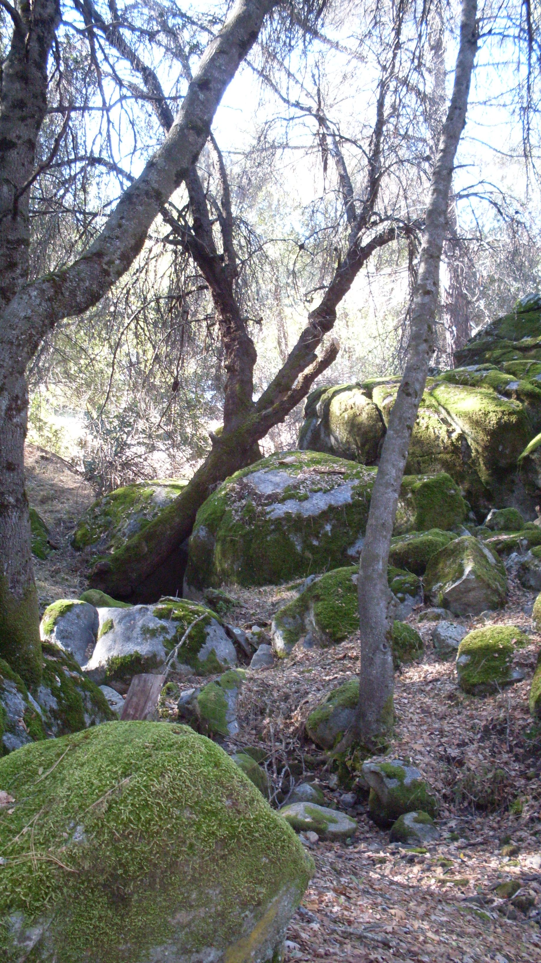

Please explain to me how I can get parbuckling rig in close to remove tree in picture... Yes it's the "Y" shaped one in center of pic... It's oak its very dead and there is no safe ground to use chainsaw to cut from.... And there is a creek about 3 feet behind where pic was taken from so it precludes getting a tractor Jeep with winch in there....

And you could find a picture of a thousand trees that it could work on.
   / Big Wood - Small Tractor. #47
You will find many MANY more times that it will work for even one that it doesn't!

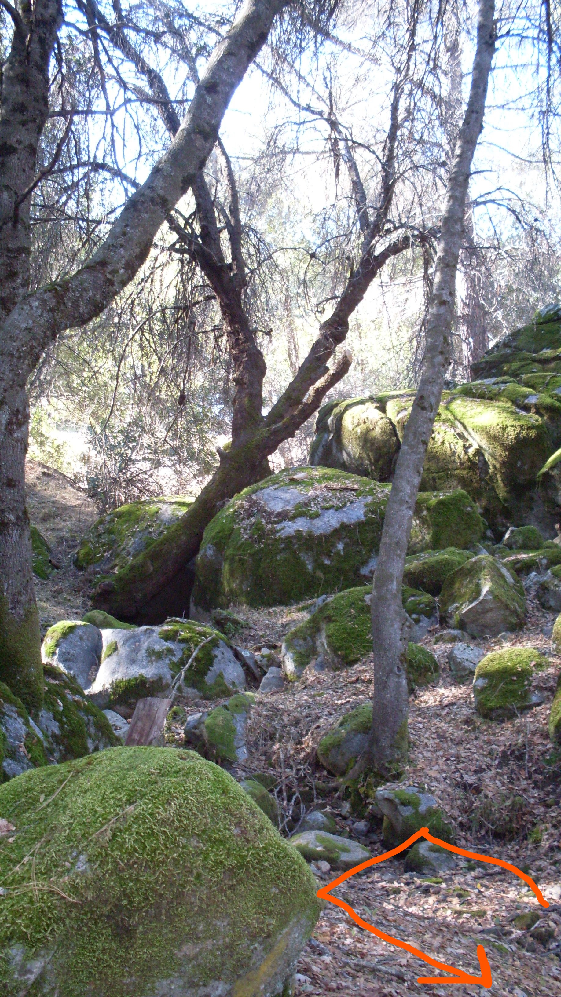

What about that place where the red lines are, looks like my ATV trailer would fit there nicely..........
All I need to do is winch those trees to that spot where the red lines are, then I would parbuckle them on my ATV trailer, a 5'x 8' spot for my ATV trailer is all I need, you mean to tell me you dont have 5'x 8' flat spot near any trees............ I have places like that here that's why I had a winch on my ATV, I could easily winch a 12"x 8' log, but a small tractor would work better to drag trees to a flat place and that is all there is to it.
Most small tractors I see could easily handle my ATV trailer, I have a couple of these old pictures, just cant find a picture where I have my parbuckling set up on it, this trailer is 4' wide, 7-1/2' long and it can fit in a very small place.
I now use a Rhino to pull my ATV trailer and load with tractor, parbuckling takes very little room. Rhino with trailer - YouTube

Because there is no way to get a trailer in there and the depth perception of camera is poor as tree is almost 75-80 feet from you marked location....
So far only solution seems to be having tree professionally dropped (risk factor because of area around tree trunk) and the cut to fireplace length and hand packed out....

Make a path?.... Those boulder are as big as a car....
Burn it of course... We do get some cold here....

Parbuckling is primarily a loading method, not a retrieval method.
Name any technique, and you will eventually come across something that it will not work on. If you are looking for a one-size fits all retrieval and loading method, please let the rest of us know when you've found it.

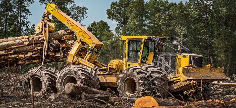

Well maybe your woodlot is in the wrong thread location, it's sounding more and more like you need a dynamite licence and one of these.................................

Its not a wood lot.... Its a single tree that is in a very awkward location that need to be remove because it is now a torch waiting to be lit in the dry Sierra Nevada Mountains of Cali where forest fire danger are listed as "extreme".......
