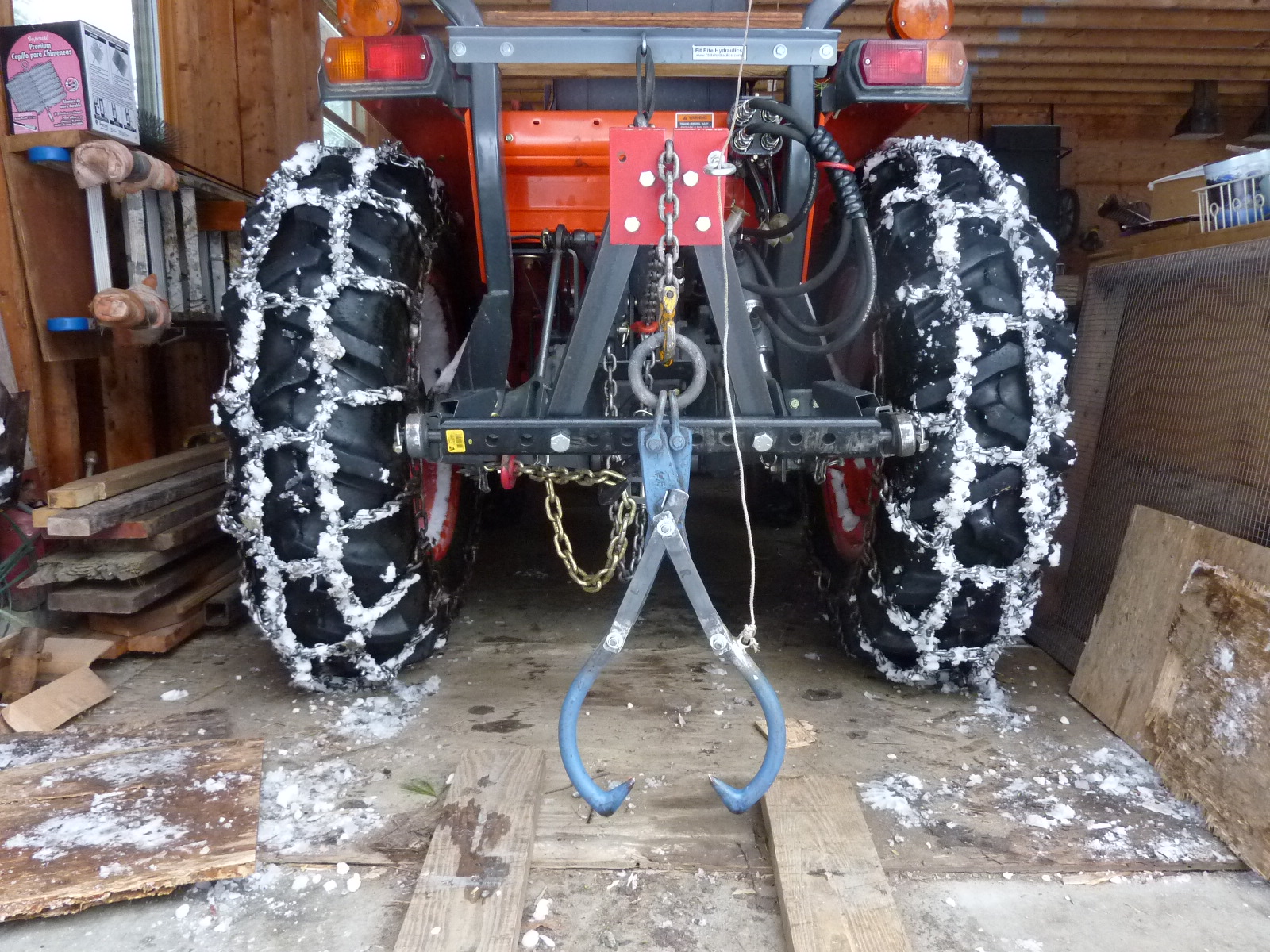

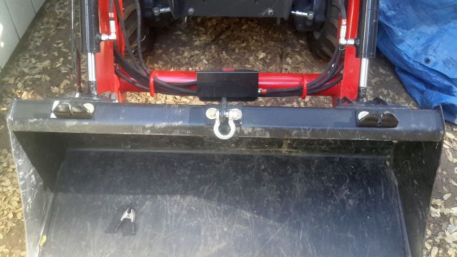

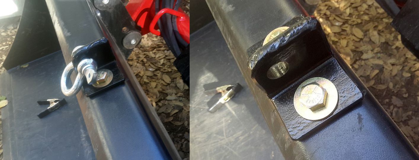

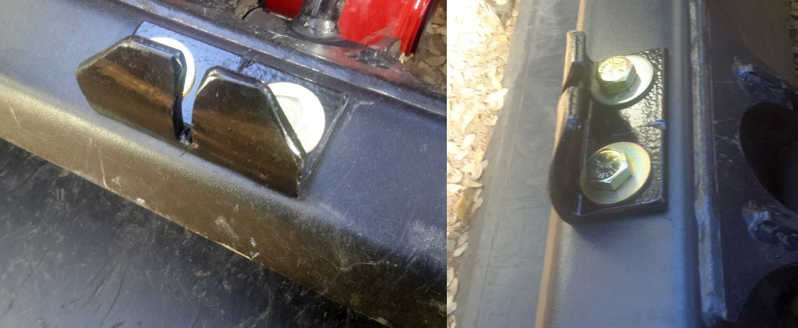

What I often do is use the loader as a winch where there is no place to maneuver and I cant get close to the tree.
Hook up the tree to those bucket hooks and raise the loader then curl it to gain another foot or two. Shorten the chain , rehook and repeat.
It is slow and tedious but it beats fetching it by hands IMO

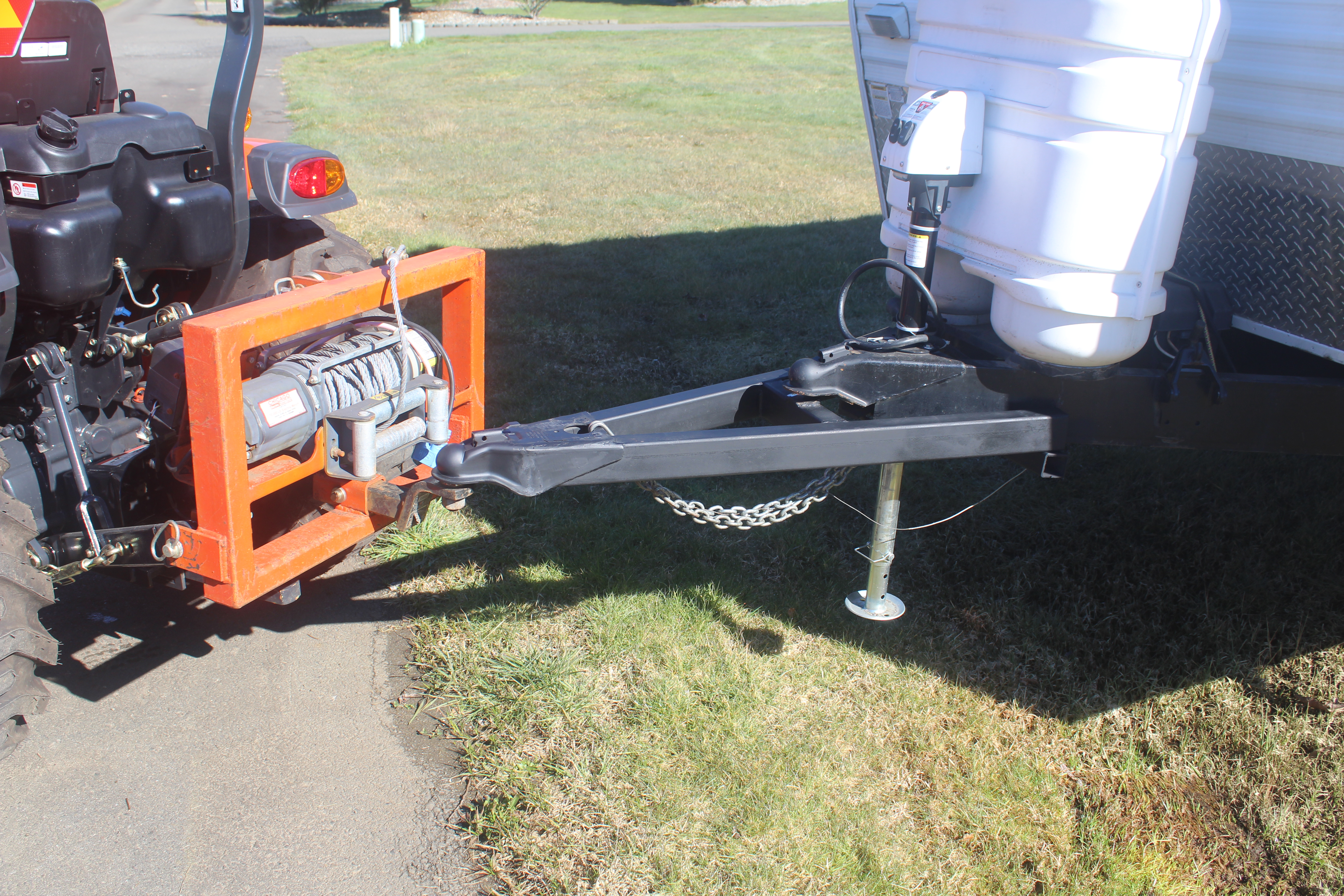

One thing you will notice with an electric vs a 3pth winch is the speed; if you were using it on a regular basis waiting for each log to come in would be tedious. However I know several people who have cut 10 cord loads of tree length pulpwood using just their ATVs so it is doable; and beats backing up to every tree or dragging each out with a chain. (And don’t ask me how I know that.) ;)

An electric winch is not a great choice for winching logs for anything but very occasional use. They are very slow, and the duty cycle on most of the inexpensive ones (and some of the not-so-inexpensive ones) is low enough as to make it impractical for logging use. I own the HF Badlands 3500# winch Which I have mounted on an antique UTV. From the owner's manual: "Duty Cycle Rating: 5% (45 sec at Max Rated Load; 14 min, 15 sec Rest)". Pulling in the full 50' at the full rated load would take hours. You don't necessarily pull every log at the full rated load, but logging tends to be a long, continuous pull. These winches are generally better for short bursts: raising and lowering a snow plow, or getting unstuck from a mud hole (where you generally only need to move a few feet to get yourself out of trouble).
Add to that issue the fact that your tractor battery can't take the deep cycling, and that your tractor alternator is woefully undersized to recharge that battery in a reasonable amount of time. The solution just isn't practical for anything other than very light logs or moving heavier logs out of the middle of your trail (as opposed to dragging them 50 feet from off the trail).
If you do go this way, a skidding cone will significantly reduce the drag from the log skidding across the ground, reducing the load on your battery and increasing the distance you can pull without stopping to let the winch cool. Even better is a logging arch, particularly one designed to be pulled in at the end of a cable (in addition to being towed by your tractor). IMO, neither of those comes close to what a real PTO-driven logging winch will do for you. Once you have used one of those, you'll wonder how you ever got along without one.

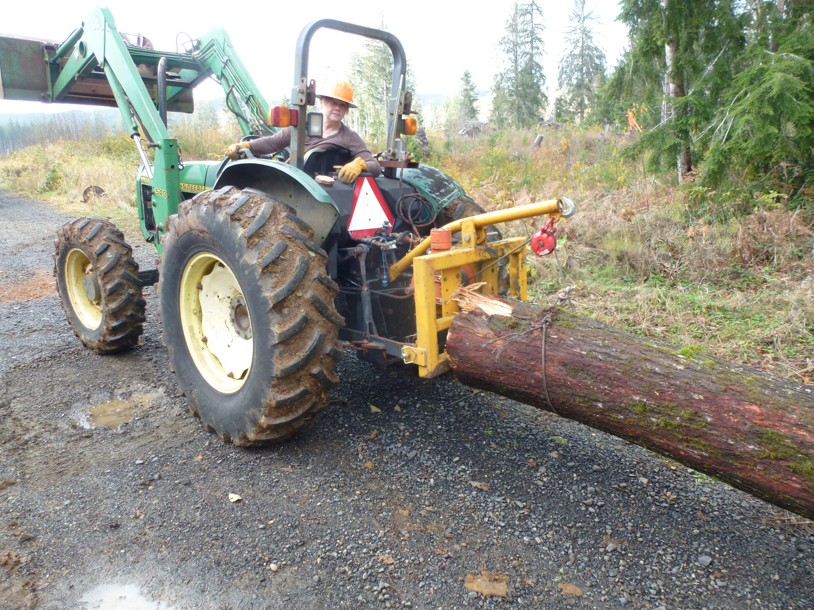

How heavy a log it can pull is STRONGLY dependent on ground conditions, and the shape of the log, and how cleanly it was limbed. A skidding cone or skid plate / skid sled under the front of the load can significantly reduce the pulling force required. I've seen homemade skidding cones and a lot of homemade skidding plates (looks a bit like a sled or toboggan that slips under the leading edge of the log). Sometimes I'll bevel the leading edge of the log to help keep it from digging in - kind of a poor man's skidding cone.
I've whole trees out (20+" DBH Red Oak) without a problem with my 7700# logging winch. I've also had trouble pulling out 1500# logs with it, when the conditions are just not right (though I can almost always figure out those 1500# logs, I just have to jockey things around a bit). When cutting firewood, it's easy: If I can't move a log without a lot of hassle, I just cut it down to a shorter length that I can move. If it's a sawlog that I need out in one piece, sometimes I have to get more creative.
