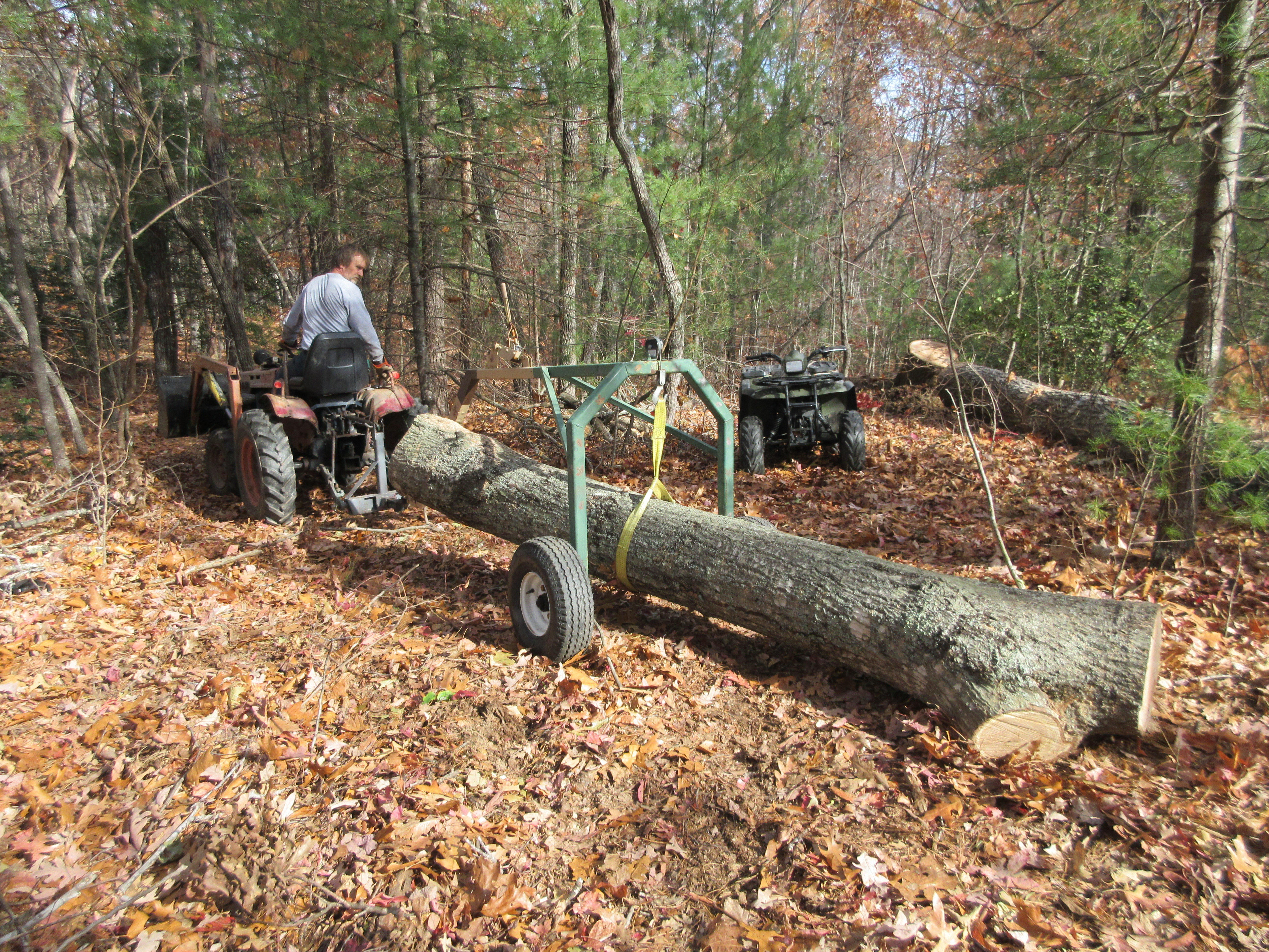

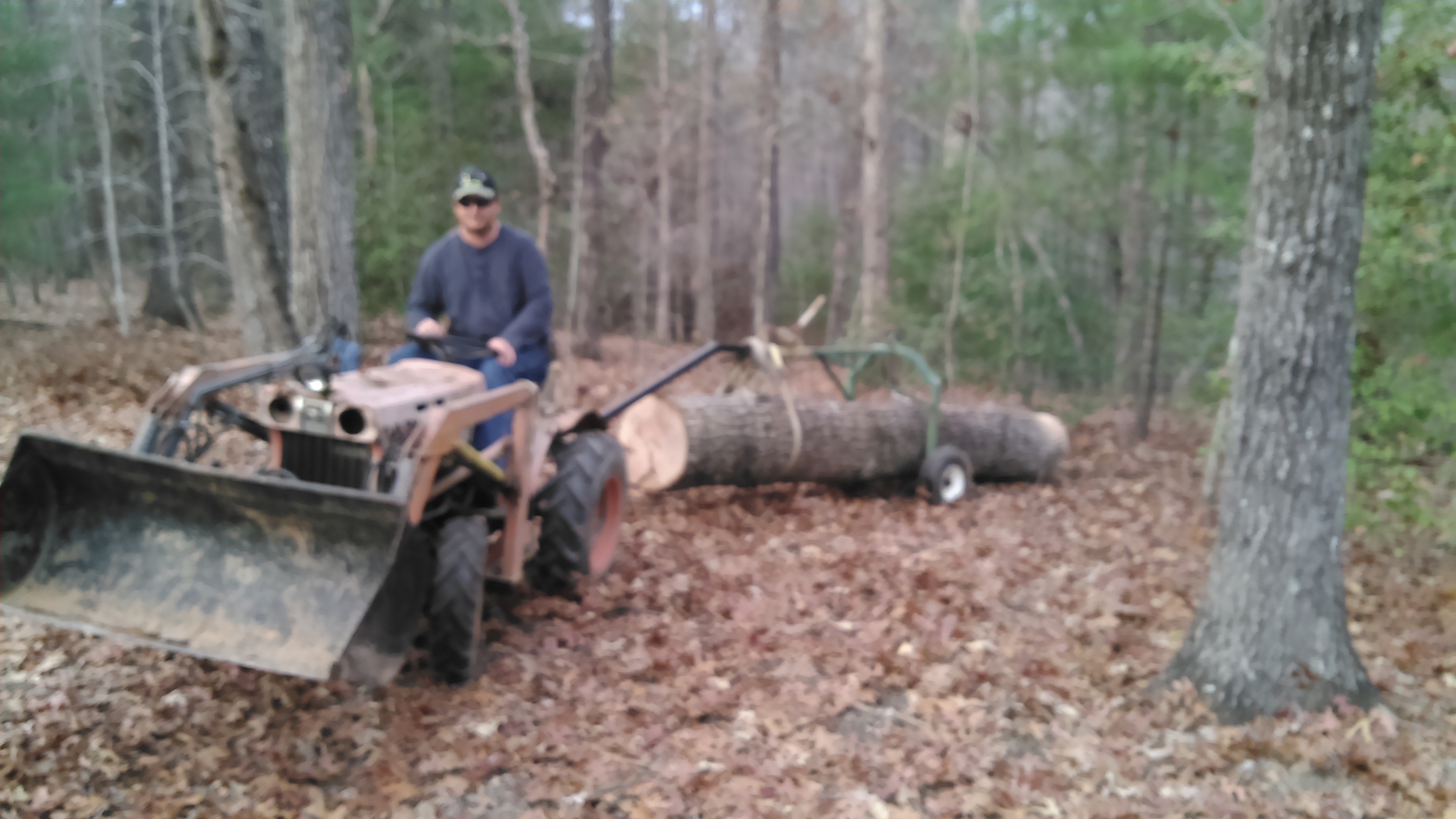

I don't do much in the way of logging. I built and use this when I can get to the logs.
/ Big Wood - Small Tractor. #3
Several hundred feet total of various cable lengths, and snatch blocks. Set the blocks so you can drive along a road or trail, and pull the logs to the road. Sometimes rigged for doubling the pull.
I used a Jeep for years, now a Kubota BX. Firewood logging. Logs up to 20 inches or so diameter. Flat or slightly downhill pull.

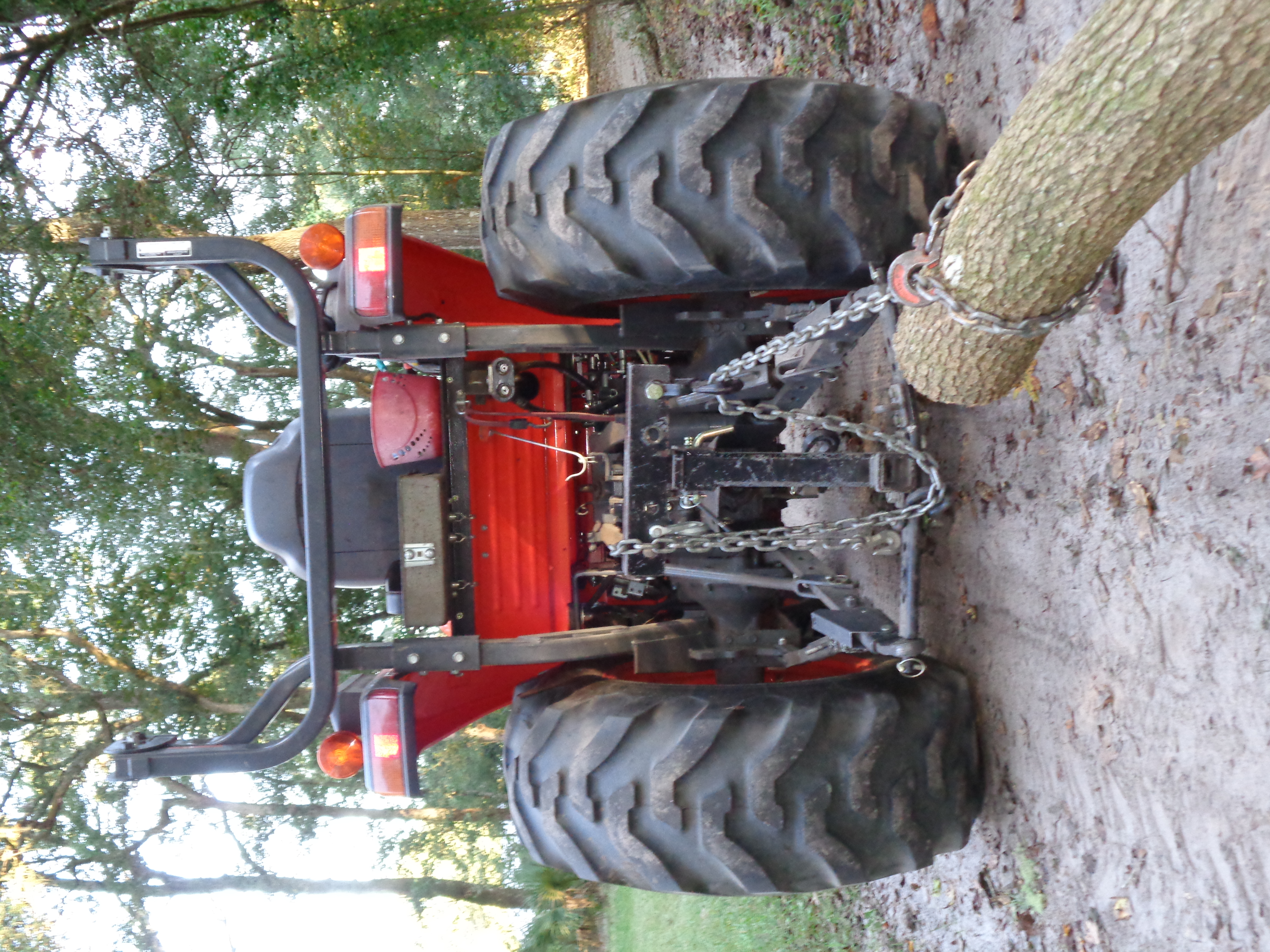

/ Big Wood - Small Tractor. #10
1) So far I have resorted to just chain and just dragging out pieces but then again it's a issue of how close I can get to logs, how far I can travel in one direction and how long my chain is...
2) Also considering putting a bracket on front of tractor so I have something to attach chain to other the eye on FEL... Does anybody "back out" of woods while dragging logs out???

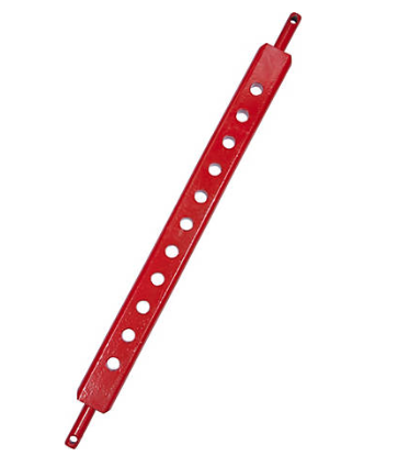

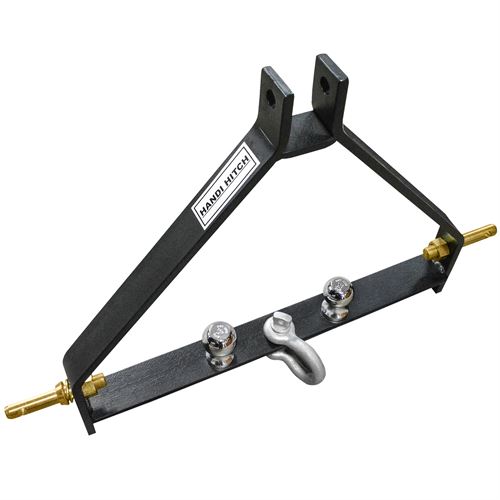

1) What is your tractor attachment point? A $30 to $63 Cross-Drawbar will allow you to safely elevate the load safely about 6". Often 6" lift reduces friction between the log and ground by 50%. I have a Ken's Bolt On chain grab hook bolted to my cross drawbar.
CROSS-DRAWBAR: https://www.tractorbynet.com/forums...rs-cross-drawbars-illuminated.html?highlight=
VENDER: 3 Point BX Trailer Hitch Compact Tractor Kubota Handy Hitch Attachments 89581383465 | eBay

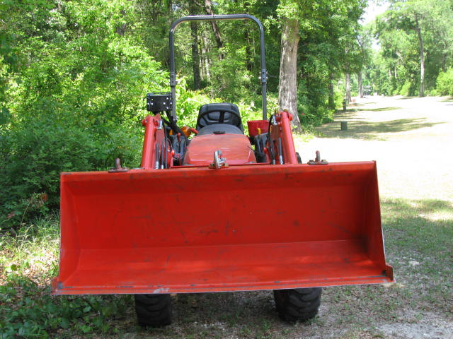

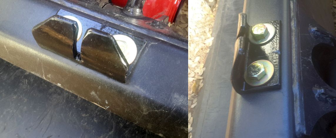

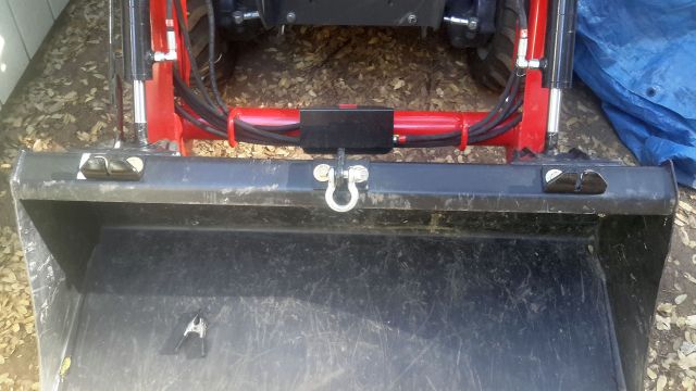

2) I speculate half of the tractors discussed here have chain grab hooks bolted or welded on the FEL bucket.
Chain grab hooks are highly useful for teasing logs out of thick underbrush, as you add vertical plane to potential maneuvers, however imprudent use could leave your FEL involuntarily parted out.
Ample Three Point Hitch counterbalance advised.
KEN'S BOLT-ON HOOKS: Ken's Bolt on Grab Hooks <<Bolt-On>>

Attachment points to tractor is not a problem have many solutions to attach cables, slings, chains, and ropes to tractor...
I have various attachment points as brackets with holes for shackles and chain slot hooks on FEL, putting angle iron bracket on front subframe that will take shackel(s)to keep from pulling with FEL. It's in self etching primer as we speak, to be installed after final coat of paint...
On rear, the MF supplied straight draw bar (actual nothing bigger than will take trailer hitch ball), Cat 1 QH that will take my cross draw bar, also 500 LB ballast weight and bracketry on rear of weigh that can take various shackles, hooks and bolt on accessories....
It's all about what techniques works best between tractor and chunk of wood I want to move, keep in mind it is not "logging" per say, it is occasional removal of dead and down and a few "cut" trees, occasionally... Does not really justify cost of logging winch..

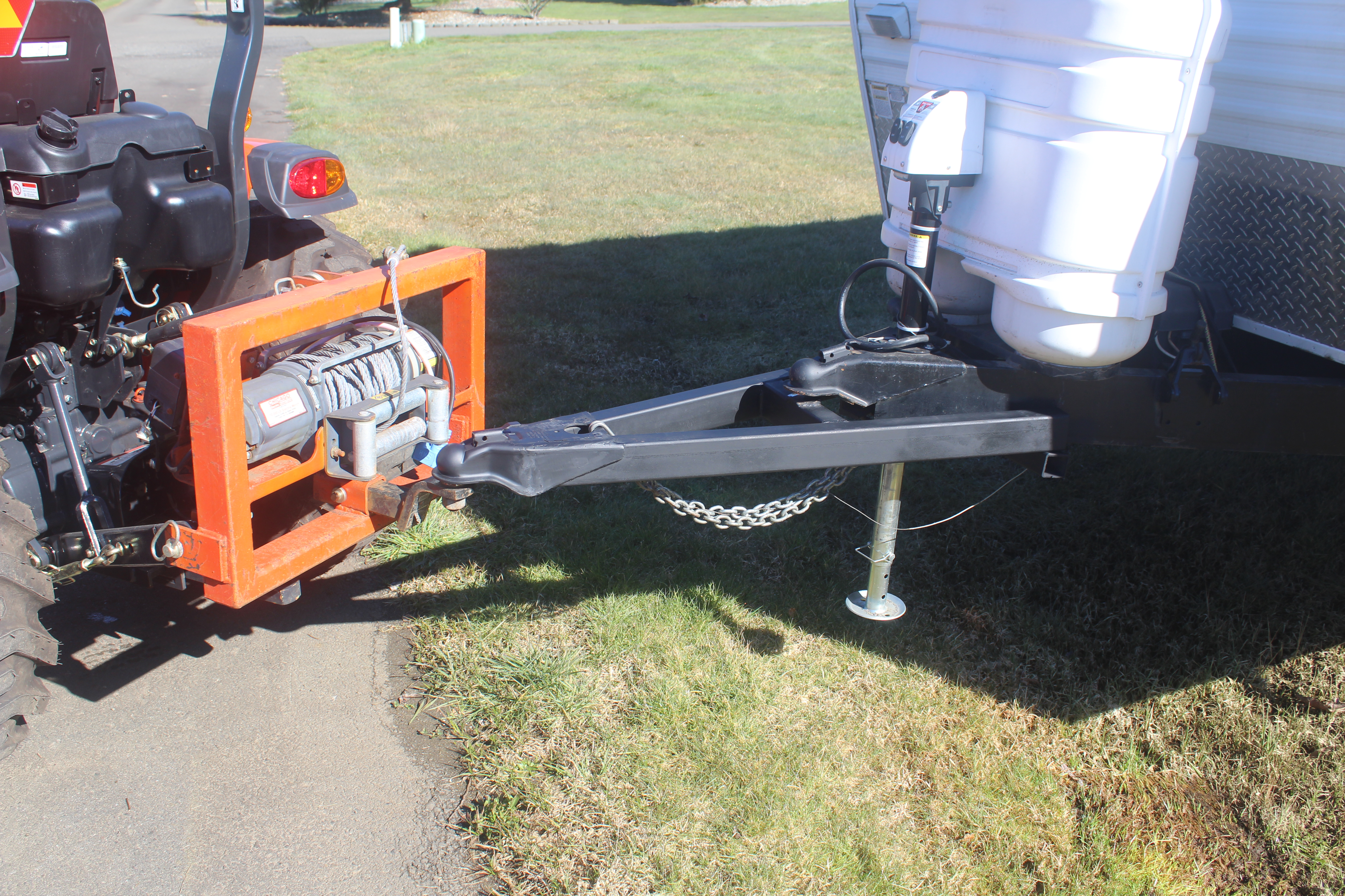

These work well.
/ Big Wood - Small Tractor. #20
^^^I like that electric winch setup. Have no experience with one but the battery issues mentioned earlier, this should be a non issue for intermittent use?
That JD looks like hydraulic winch?
