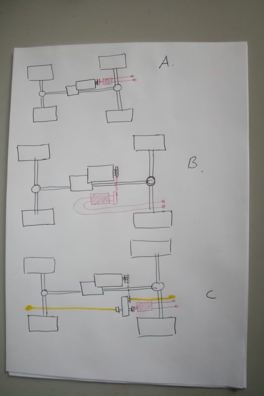

Hi,
Lovely project.
Looking at your Suzuki axles, I built a 4 x 4 x 4 years ago using two Suzuki front axles. If your looking to have a narrow track, you could have used two front axles, but chop them down to use two short halfshafts. Instead of using a transfer box, you could use the engine and automatic gearbox from a front wheel drive car, remove the diff (or weld it up so the planet wheel don't rotate) and rotate the engine/gearbox 90 degrees so the outputs from the diff face the axles. This will give you low ratio with good torque and low speed.
Here's my transmission layout.
I also used a single point attachment (similar to the front axle on a tractor, but sprung).
More info >>here<<

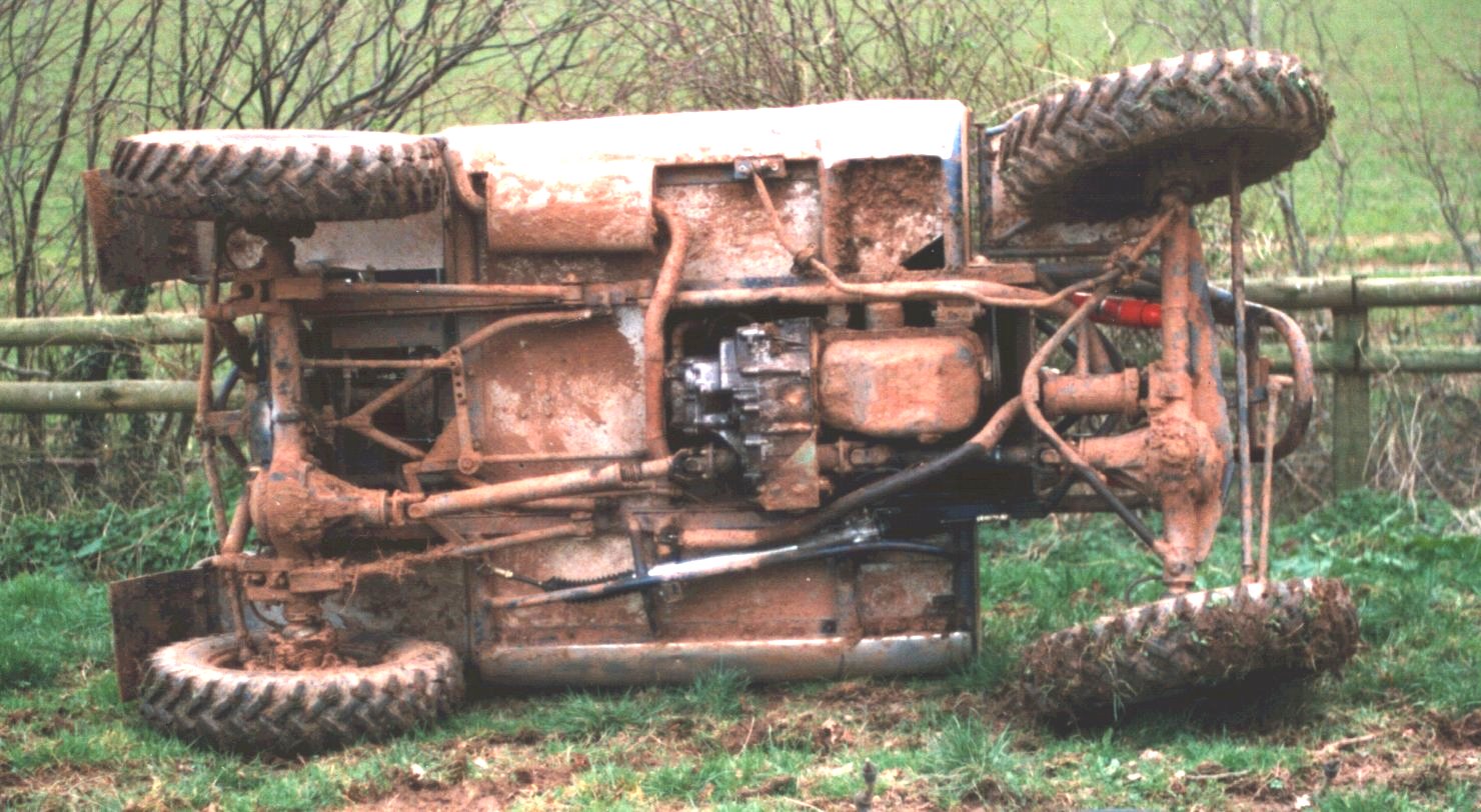

hello Marcle
the mower is as you describe, a cut down suzuki axle using 2 short shafts on the rear and a front wheel drive car engine and box,
and l do like suzuki bits, nice and light, when l started my little rockcrawler l experimented with all sorts of layouts such as this subaru engine and box midmounted with suzuki axles
and whilst a central engine might seem a good layout it dosent work going up hill dose it ? lol
l worked my way through several different layouts on the garage floor including this one with ford diffs and a fwd engine and box
but in the end l came back to an all alloy fwd engine and box and suzuki sj axles, about as light as it comes
as you can see from this pic the engine and box were pushed well forward to try and keep the nose down
not much room for the passenger but just enough
my pal built one as well
this vid shows some of the abilities of a transaxle buggy
20090205-040620.mpg - YouTube

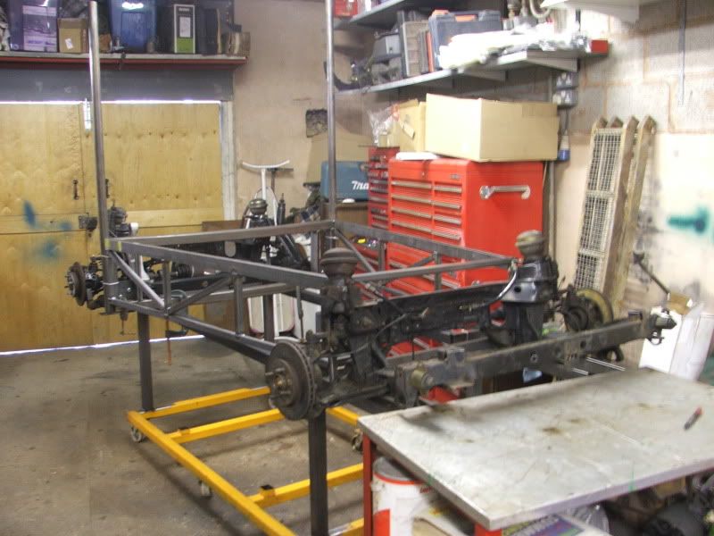

well things have changed a bit recently, by accident really, l bought a vitara ( sidekick ?) rolling chassis for $120 just to get the alligator tyres that were on it
once the wheels and tyres were off it and onto another project l was left with a rolling chassis that l dident have any plans for:confused2:
well that dident last long l have decided that it might be usefull on the mower project, originally the mower dident have any suspension but was going to rely on the big tyres for a bit of flex plus a tilting back axle, not any more :laughing: l am going to use the sidekick chassis and suspension
l did start off thinking of using the drive train too as it is all there
however low box just isent anywhere low enough to get the slow ground speed l need :thumbsup: so its back to the diesel engine and box from a front wheeldrive car that gives me a 4 to 1 reduction on the gearing,
it was a little to long in the wheel base to to l chopped a bit out :eek:
not quite as much it appears in the pic as l used some of the chopped out section to taper it back towards the rear
then l took 17" out of the width of the rear section to give me clearance for the wide tyres
so the chassis ended up a bit like this
it is now front wheel steer using all the standard suzuki suspension which makes it pretty wide at the front while at the rear is a much narrower than usual axle with a limited slip diff
the diesel engine and box have been back in it just a couple of little jobs to do before it goes off to the shot blasters so as l can get it painted up in a nice shade of green
