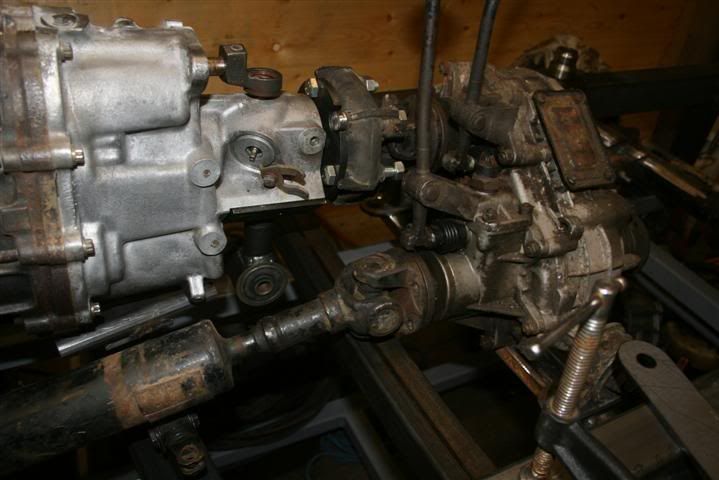

How are you going to power the mower decks?
well l was thinking that a driveshaft running straight off the front crank pulley out to the cutting deck would be simplest and l like simple as what you havent got wont break !!
but that links the cutting deck directly to engine speed and is a bit inflexable, l think that aczlan is right when he say hydraulic drive has some benifits and perhaps this is the way l should go
mounting a hyd pump infront of the crank pulley (A) is the easiest construction wise but l may have a direction of rotation issue there and no way of disconnecting the pump when l am not using the cutters
(B) would solve the direction issue by chain driving across to the pump but again l have no way of disconnecting the pump drive when l want to
and (C) looks like it has possibilities, a standard suzuki sj transfer box will give me 2 ratios to alter the speed of the pump and also 2 pto out puts, front one at engine speed and the rear one at engine speed or half engine speed but what l like is l can put the transfer box into neutral and disconnect the pump when its not wanted
the bit l dont like is the chain drive across the vehicle around the front drive shaft, so expanding that further switch the sj transfer to the other side and direct drive into it, the pump will probally need to mount on the back of the transfer box to get the rotation right
this means l will have to relocate the power steering pump and maybe altenator but that is all doable
