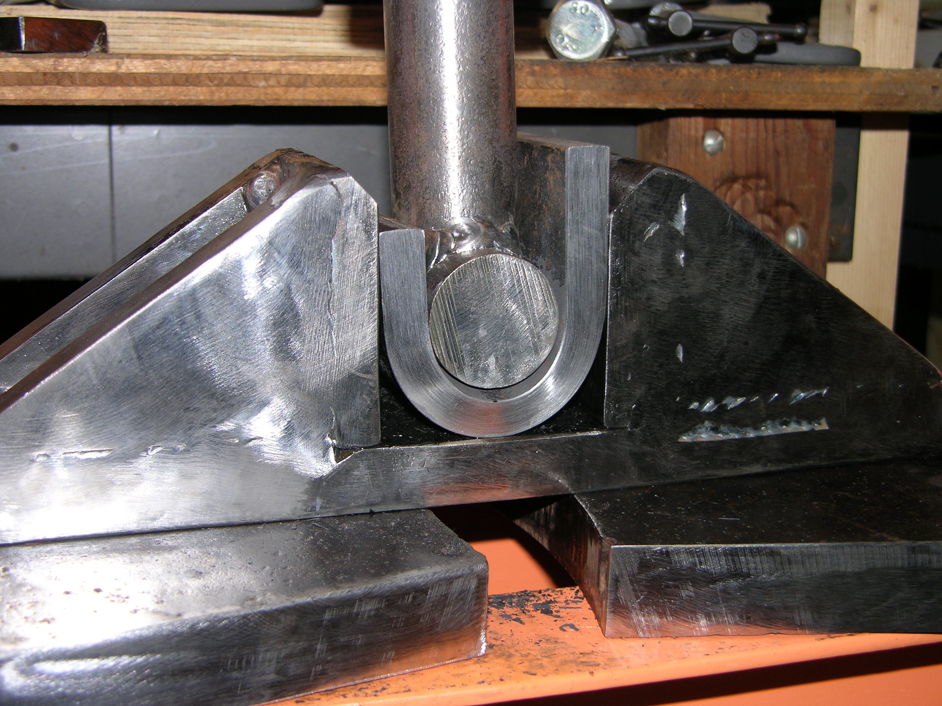

used 'em whole for parts of my loader QA setup (not finished yet) and sliced 'em into 3/4" thick weldable bushings for other parts (horizontal band saw)
DSCN1324.JPG Bent 1/2 x 3 FB "U" brackets into 1-1/2" ID for upper pin attach using my 20 ton press DSCN1327.JPG DSCN1296.JPG
