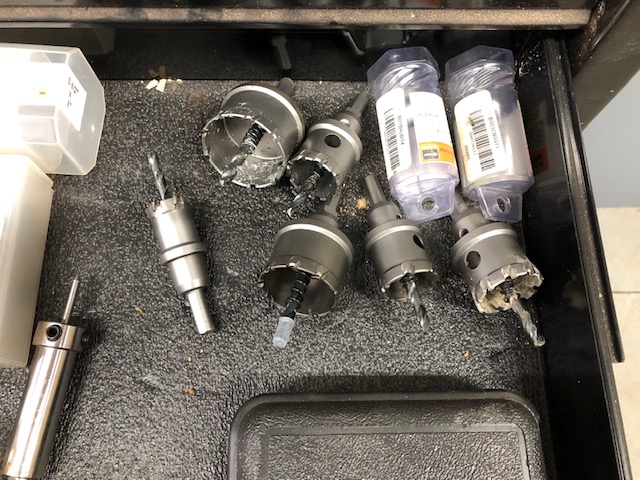

I generally use these Champion hole cutters. Carbide tooth annular cutter combined with a pilot bit. Great for hand held and drill press.

I am wondering why more folks do not use carbide tipped annular cutters with pilot bits like I referenced. They are (relatively) inexpensive, available in sizes from 9/16 to 4 1/2, easily manageable with a hand held drill, leave a round hole correctly sized, and cut fast. I use my old Milwaukee 1/2 hole shooter and black plumber's cutting oil or tap magic.
Large hole drilling can easily become a ^%$!*))&%$ in a press. I've not tried this style of holes saws and now you've peaked my interest in these carbide tipped ones.....
/ Big drill bits #36
I think ease of use may depend somewhat on the quality/speed of the drill press itself.
/ Big drill bits #37
maybe because the pilot bits easily break when drilling using a hand drill!!.. all it needs to do is slide around enough to make the pilot hole larger than the pilot bit, then the outer bit takes over, and breaks the pilot bit!..
