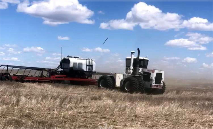

What engine is in a Big Bud tractor?
Image result for big bud tractor specs
Detroit Diesel 16V92T 16-
Towering over today's largest 4WD tractors, Big Bud is 27 feet long, 25 feet wide and 14 feet tall. It holds 1,000 gallons of fuel and weighs more than 135,000 pounds when fully ballasted. The engine is a Detroit Diesel 16V92T 16-cylinder, two-cycle engine.Aug 13, 2020
