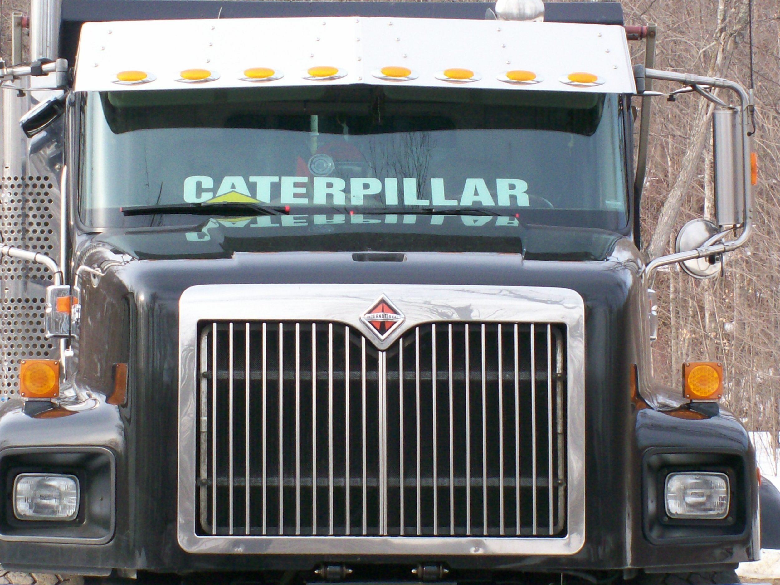

The front of my Paystar shows where my love is, LOL
I hope I can succeed in getting this one going, but its a 9.3L IH engine.
Many years of abuse. I had to save it though.
I think it’ll be most of 2023 to get it finished.
Sorry, back to Big Bud tractors!!!
