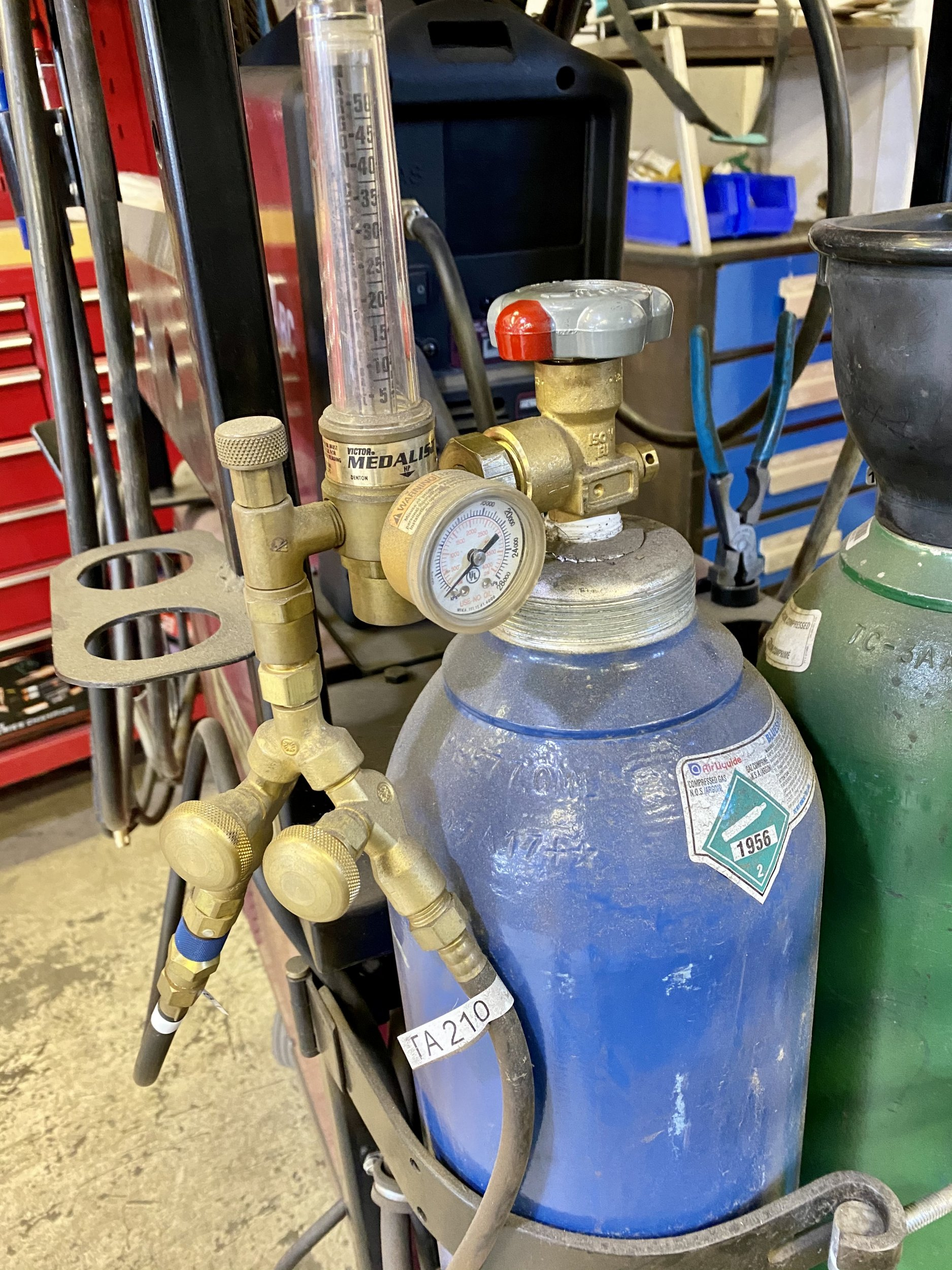

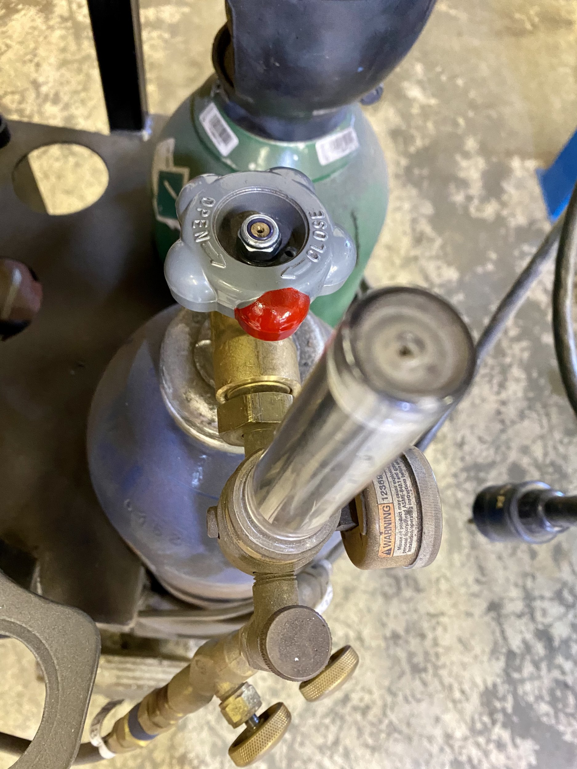

This is an idea from TBN member SODO.
He stuck a piece of tape on the tank valve handle to provide a quick visual of the valve in the "closed" position.
I painted mine so that CLOSED is directly in line with the valve stem and flow meter.
I only ever open the valve a part turn to use.
   / Big Barn’s Retirement Farm Shop #4,585
I like the paint on the knob idea. I was taught that you should always open your compressed gas valves all the way to seat the valve. Is this a myth? If so, my luck is the paint will line up the same whether open or closed.
#4,586
This is what I go by:
1. Open all the way to seat the valve as many of us were trained for years.
2. Open part way because new o-ring technology makes the old way unneeded.
   / Big Barn’s Retirement Farm Shop #4,587
When we were taught lab practices around gas cylinders, we were told open it all the way then back it off like 1/4 turn. You would not believe the number of times people were wailing on an already open valve trying to "open" the obviously "stuck" valve as it was hard up against the full open stop (and occasionally damaging one). This way, either way you go to move it, you know it is free and open. There were no concerns stated about sealing only in full open, and we could be using some pretty toxic stuff at times, so if they had to be fully open to seal the valve stem, they would have said that...
