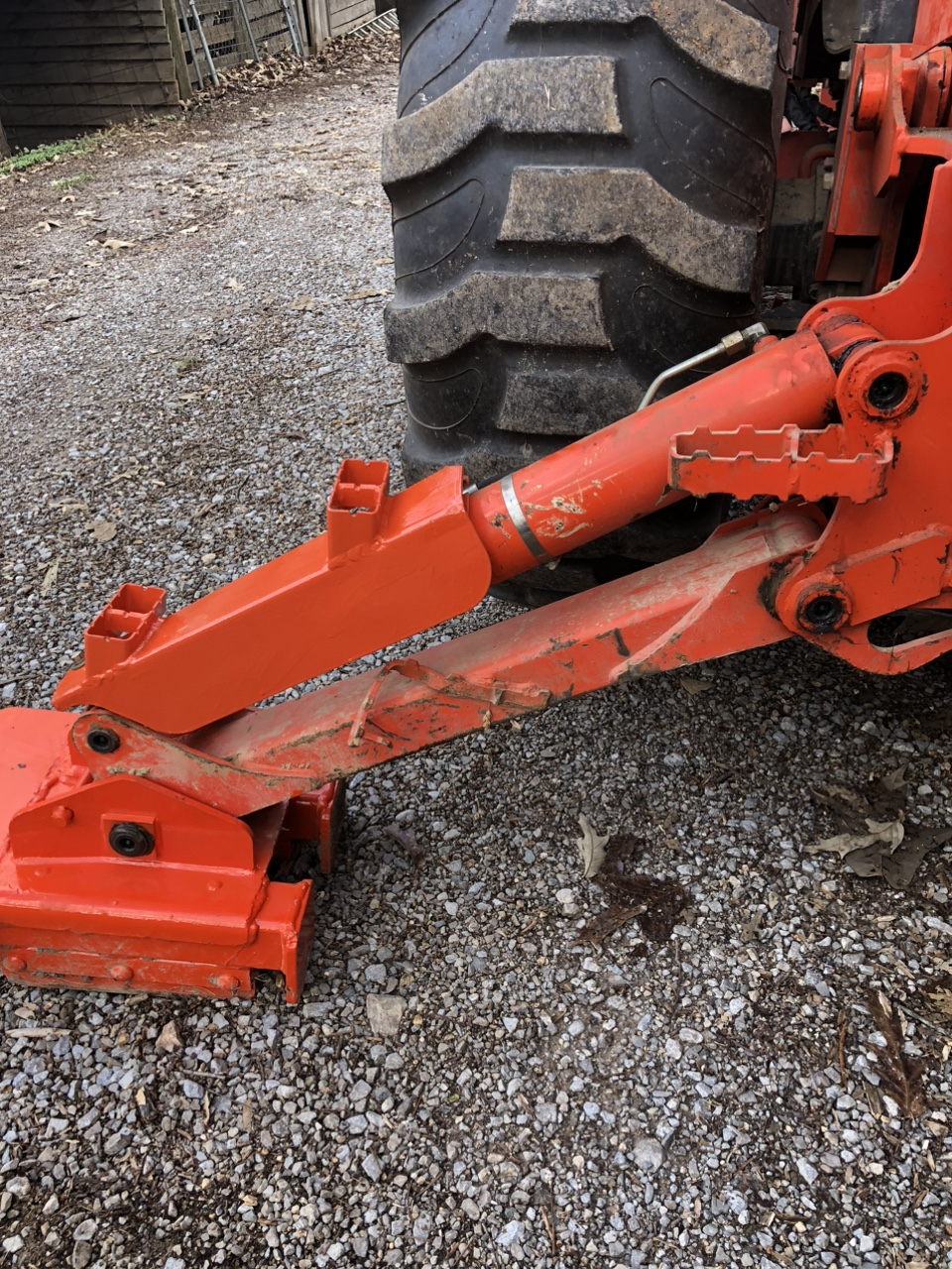

I have a new L2501 with the BH77 back hoe. It had .5hrs on it when delivered. I was digging stumps and when I lifted one and swung it to the side it caught the hose on the end of the out rigger arm. 2hrs and I broke my new tractor. Not covered by warranty. Now every time I swing a tree or stump it is my biggest fear. Does anyone have an idea how to make a shield to protect these hose's?
I am clearing an area about 2 acres for planting clover and wiled flowers. (food plot and pollinator area)
Most of the trees are about 12" around and there are a lot of them.
I remember when I had my business the backhoe had a step covering the hoses. I am looking for something like that?

Looking at pics of the BH77, most show the retract hose exiting out of the top of the cylinder which I assume is your config? I've got a B26 TLB with BT820 BH and that port is on the fwd side of the cylinder putting the 90 and the hose pretty much out of harm's way. Besides remembering to extend the dipper stick / boom out a bit more before you swing or a homemade guard, a couple of additional 90's would allow the hose to be routed down and in front of the cylinder. You've still got to avoid the 90's but the hose would be better protected.

All the hoses and fittings on a backhoe are in harms way. If you plan on digging un the brush and handling stumps and trees and limbs, I doubt this will be the last. Its something that just happens from time to time....this time outrigger, next time might be the dipper cylinder, next might be a bucket cylinder.
Just chalk it up to experience, and live and learn. Cause not really a good way to guard it on the BH77

Recently put some steps and straighten out some dings from the previous owner on the M59 stabilizer guards. Really made to keep dirt or rocks off the cylinder rod or maybe a light bucket strike. You could rip them off if you are not careful.
Buddy with a B26 also would like some guards too.
Thinking I could split a -26” piece of 5” square tube to make two guards. Weld a black 1/2” thread coupling nut where the cylinder rod attaches to pad. The cylinder side slide a little more complicated but doable. Few pieces of flatbar to make the slides. The hard lines on B26 stabilizers are on the backhoe side not the best design.
Could source the covers from Kubota m59 or L47 parts. Not sure how much $$$ but Messicks online could find out. Think Paul Short made some and offered for his model of Kubota. Still would have to fabricate the slide and attachment points and no guarantee they fit. $50 material to make from scratch.

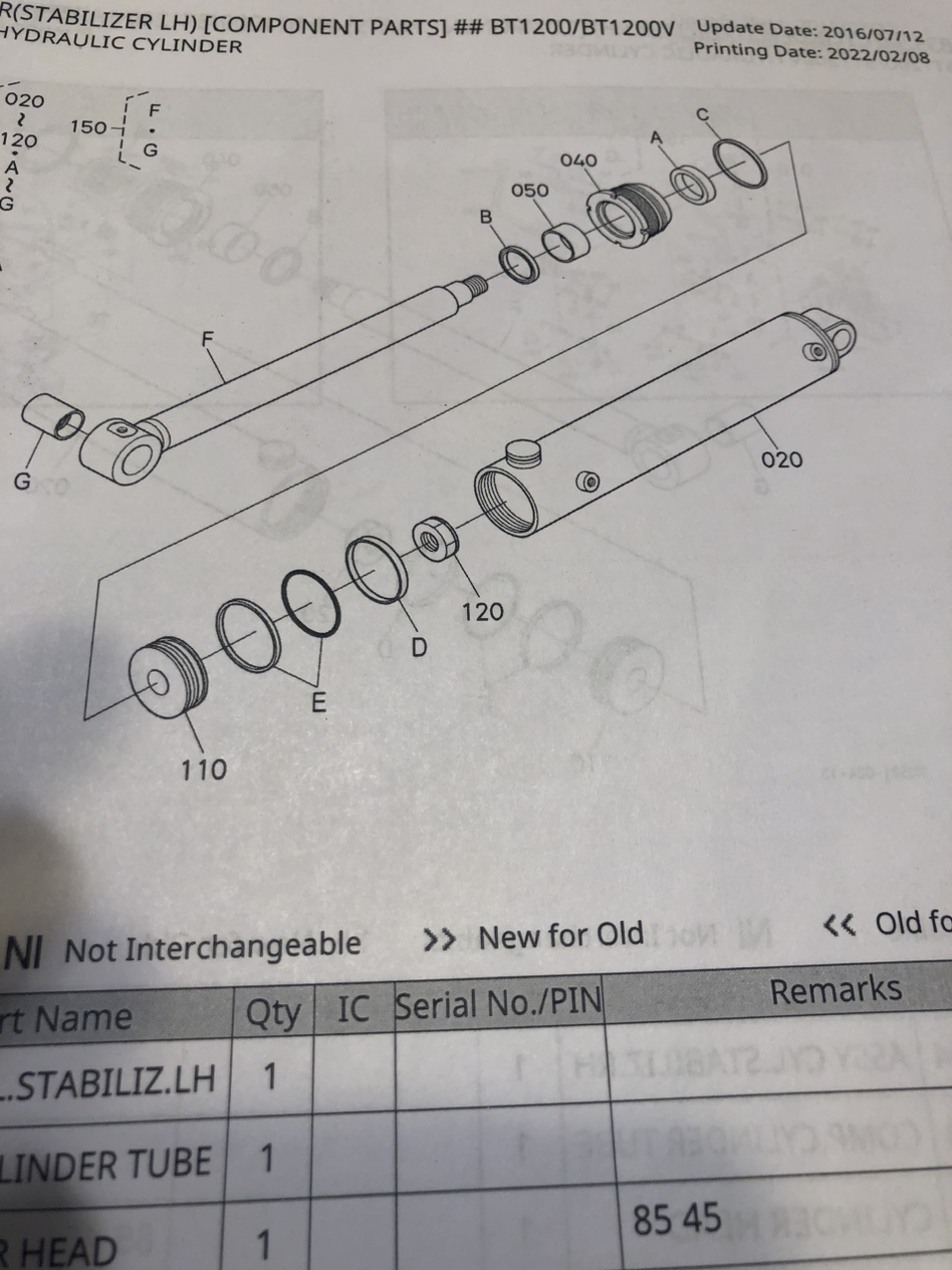

Bolt hole at bottom attaches to cylinder rod end. The bolt is fastened into a tapped hole that has been drilled where the outrigger pad pivots.
Top you may see the track that slides on “T” fixture welded to the cylinder barrel.
Messicks parts may show better detail.

Think you will have to make your own cylinder modifications. Maybe make a no weld attachment?
Paul and Kathy make several modifications for the BH77. Didn’t see outrigger cylinder rod guards but might find inspiration.
Even my old Ford 4500 BH had outrigger guards as do most commercial machines. Outriggers often get buried grubbing out stumps and attacked by rocks.

Taking the stabilizer pad off and slipping a piece of PVC pipe on might work. Maybe cut a slot in the bottom of the tubing without removing pad? Less likely to harbor dirt or mice. Have to watch how it clears the lines. Tie to the pad with wire or zip ties. Black corrugated drain line pipe might be tougher and less likely to break on impact. Kinder on hydraulic lines? Comes in 4&6” diameter. Often the KISS option is the best option.

I looked at it yesterday in the snow and my cylinder's don't have the hole in the end.
