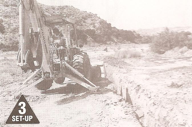

I have this in the Kioti forum, but haven't received any responses. Thought I'd try it here since it's not specific to any brand of tractor.
I dug a trench the other day for the gas company to run a line to my place. Due to obstructions (garage at west end, and fence at east end), I could not straddle the line, dig the trench, and drive away at the far end. I had to dig the east end as far as I could go, turn around, dig by the garage, and then connect the two trenches.
I tried angling the back of my tractor (Kioti CK25) with the backhoe swing pivot centered over the line, but that would have put the back tire in the trench. I ended up backing square to the line so both back tires were on solid ground. This meant the stabilizers were right on the edge of the trench. As I was digging, the stabilizers kept breaking down the edge of the trench. I finally ended up raising them and dug with the tractor on it's wheels (front bucket down also).
It was a rocking and rolling ride to complete the last bit to connect the trenches. Got it done, but had to gently peck at it so the hoe wouldn't drag the back of the tractor around.
Any tips on what to do in this case if I run into it again? Maybe find a couple of beams to set across the trench so the stabilizer pads have something to land on? What do you guys do?

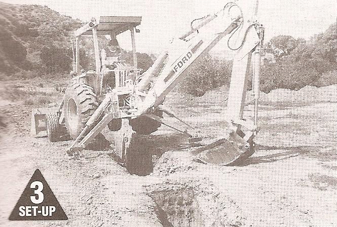

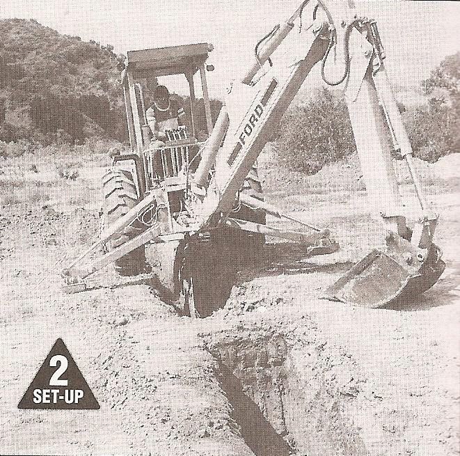

Here you go Lbrown. I scanned these pics from the TLB training book I mentioned in the "FEL Operation thread" from www.equiptrain.com. I used this technique once with my L39 and it worked great. minimal pucker factor.:D

/ Better way to do it? #8
I do it the way BX2230Dude posted works fine you have to have good soil so the sides don't fall in.
The other concern is 12" cut below some thing 48" wide doesn't leave much on the sides but it is doable.
After you do it a couple times it will get easier I usually just lift the stabilizers clear of the ground not all the way up.

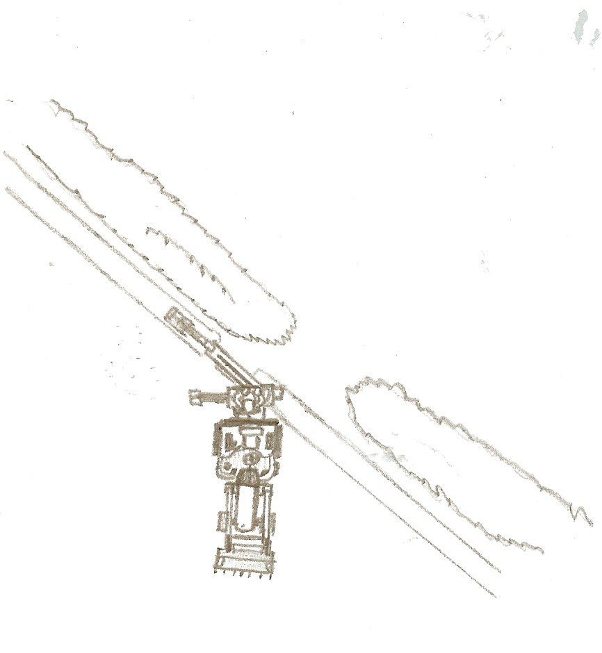

I would dig the trech untit the two ends are close, move the tractor at a 45 angle and dig the rest of the trench. It may sound confusing but it could work.
/ Better way to do it? #10
like this... notice the right stabilizer is up and out of the hole.
