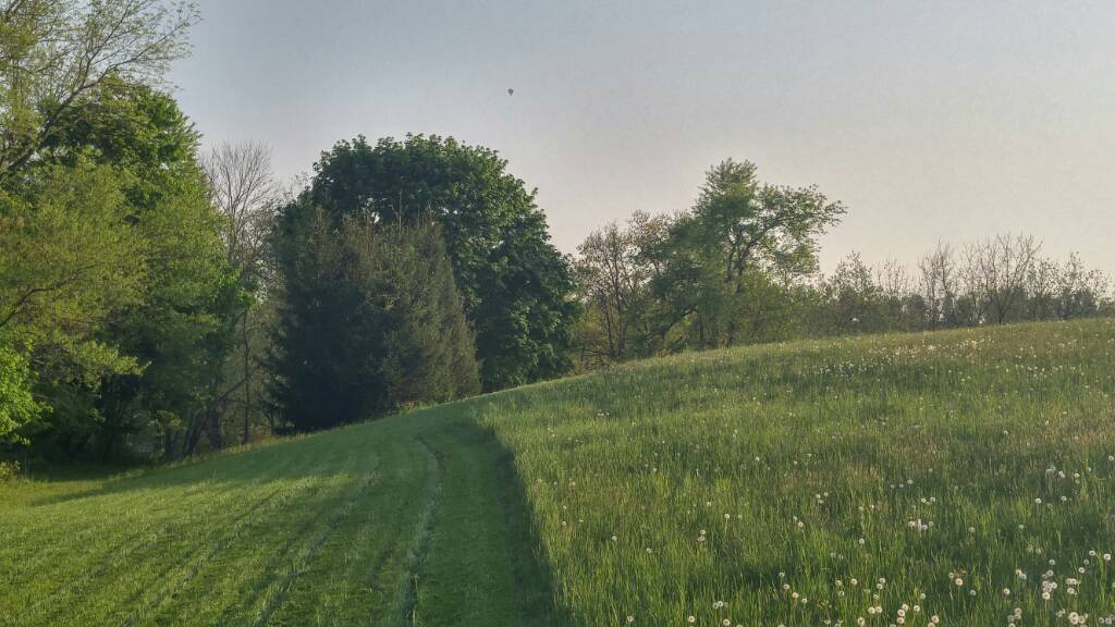

I have kk 72" side discharge mower. If It's a finish mower, no way will the belt slip if used right. With that said, i mow my field with mine, if grass is too tall, raise front end up some. Only replaced belt once in almost 20 yrs. Have to slow down in real tall stuff. 0508181856_HDR.jpeg
