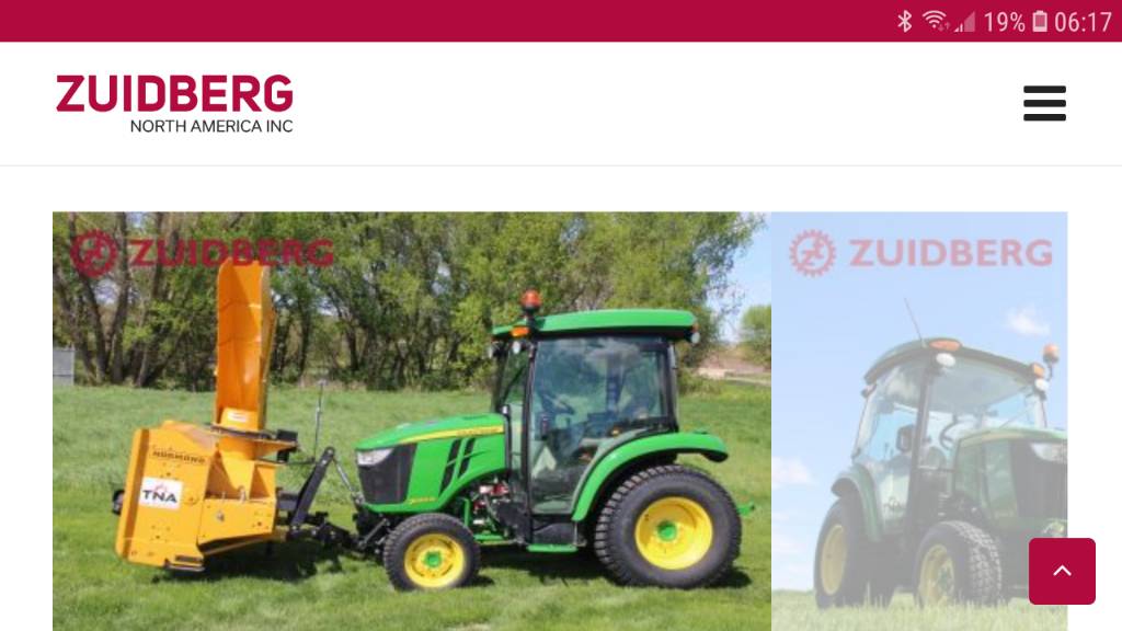

I would recommend a front hitch from Zuidberg. It allows you to run any 3pt attachment at the front at 540rpm. Get a snow 7ft blower and your banks will never build up and you're driving forward. Screenshot_20190503-061754_Chrome.jpeg

I would recommend a front hitch from Zuidberg. It allows you to run any 3pt attachment at the front at 540rpm. Get a snow 7ft blower and your banks will never build up and you're driving forward.View attachment 603160
Thought I'd heard of most options, but that's new to me. I'll research it further, looks like they have kits that allow a loader to still be attached. Wonder if this is cheaper/better/stronger than a snowblower on a loader powered by a hydraulic pack on the 3 pt hitch, or even one mounted on the frame powered by the mid-PTO.
/ Best set-up? #14
As far as I know, at least on bigger models, they are loader loader compatible. They're driven off the front pulley. You're loosing ground clearance in the area around the front axle but under the tractor it pretty much stays the same. No dtiveshaft under the tractor from the transmission to the front.
You can attach any attachement that you usually mount to the rear. Specifically on snow blowers, you don't have to use what the manufacturer dictates with their proprietary front attachments.
