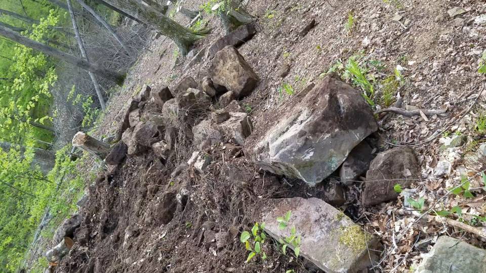

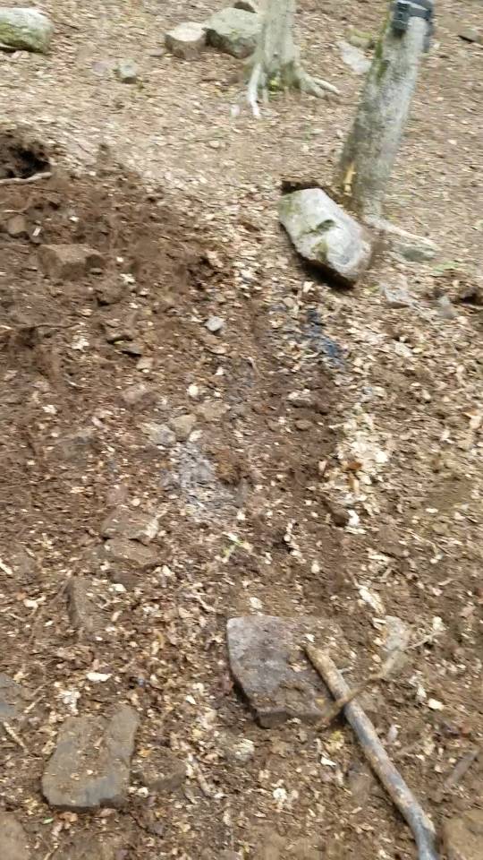

What is the best way to remove these rocks? Yes I'm able to dig them up but it's one after another and doesn't end. I feel like I could be here rest of the year. Got to be a better way. Looking to till this land up for a food plot and plant shrubs on the hillside like blueberries and blackberries.
Kinda want a rock bucket but afraid on my tractor it wouldn't dig in enough to make a difference. Kubota b2601. Screenshot_20200512-175548_Video%20Player.jpegView attachment 655184Screenshot_20200512-175443_Video%20Player.jpeg

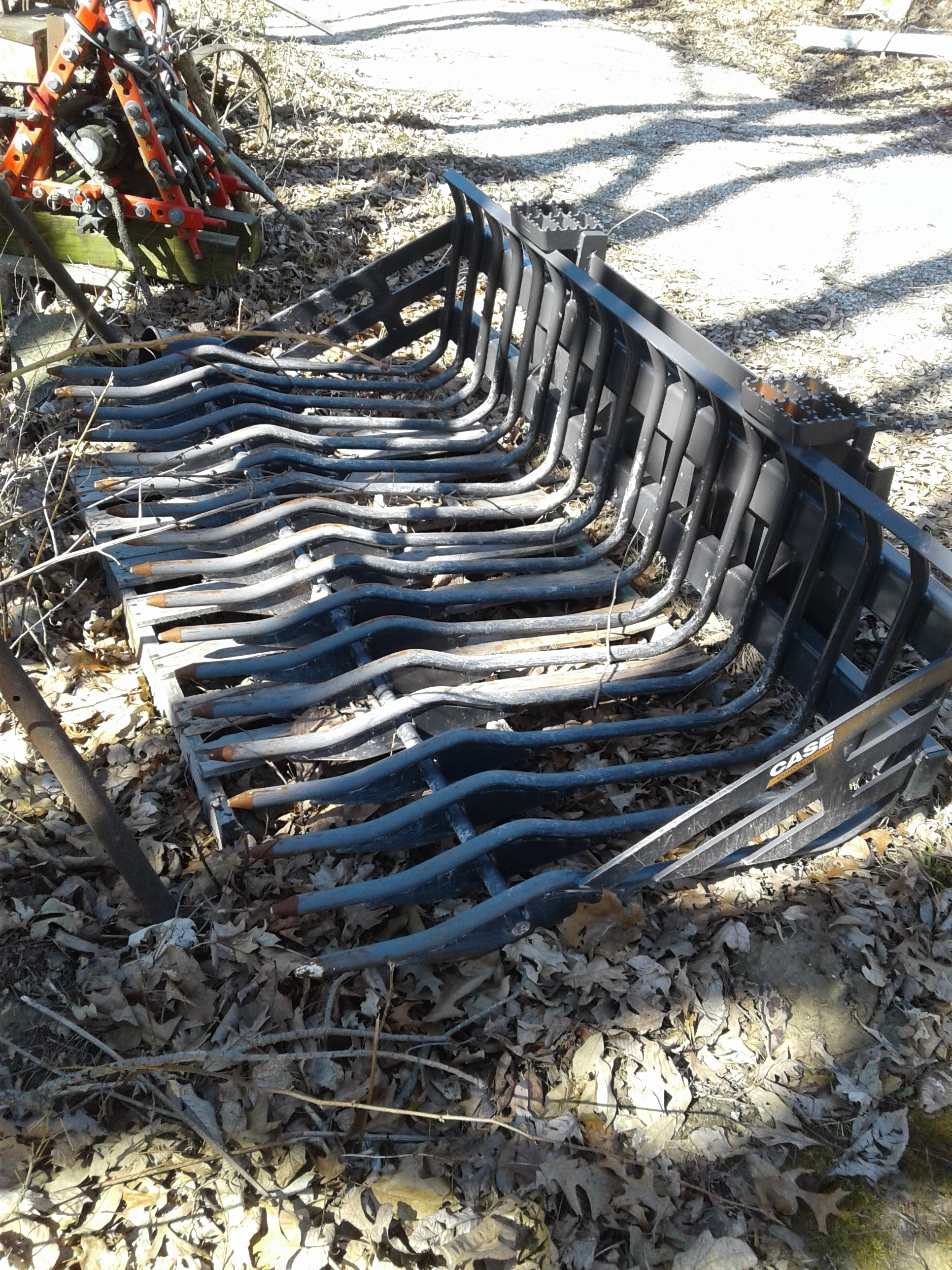

My B2650 lifts about 200lbs more than B2601. This Bradco built bucket is a little larger than recommended, perfect for the next tractor. Where I live can't have LTL deliveries (semi's) showing up. If you can, Tomahawk makes a rock bucket that maybe what you're looking for. I get cement truck washout (cheap fill material) and separate the boulders from the fine stuff. Ask dump truck driver to keep rocks under 500lbs, cement co. has a general idea about the max size.

Take a hammer and knock off a chip. Is the fresh surface a dark bluish black? If so, you might have a layer of fractured basalt. You are never going to plow that. And don't think you'll ever "remove" the rocks: Cause that's mostly what you have and the rocks only get bigger the further down you go.

Get a set of forks and move one at a time. If you cant lift it then get a sling and drag it out of the way hitching to the draw bar.
/ Best rock removal #6
If that's your entire "collection" you could try putting one or a few at a time into your FEL. That's how I moved my "collection".

No, there's way more in the ground yet... I may be fighting a losing battle. I have a guy coming to dig a trench for a pipe, may see if he has skid steer with a rock bucket??? Not sure how long it would take and I don't want to fork out a ton of money for rock removal....

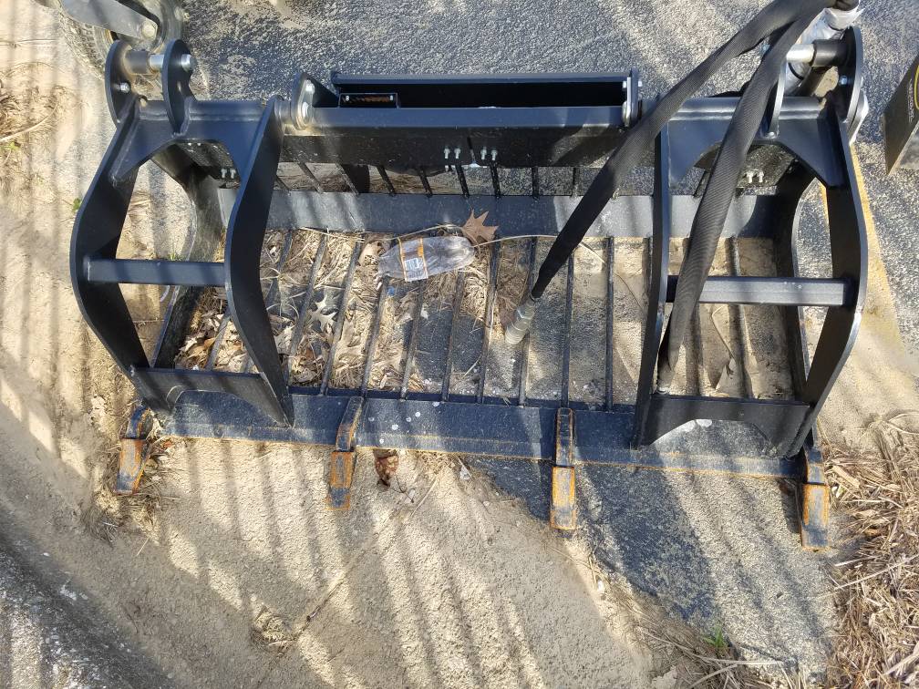

This is at a local rental place in town. They have skid steers that weigh over 8,000 lbs. This would have to be an easier way? 20200514_175007.jpeg

I have a 4720 Deere and a grapple with filled tires, I can pick up and move one ton rocks. Digging a trench is more efficient with an excavator, if there's large rocks an excavator with a thumb can move those to the side.
