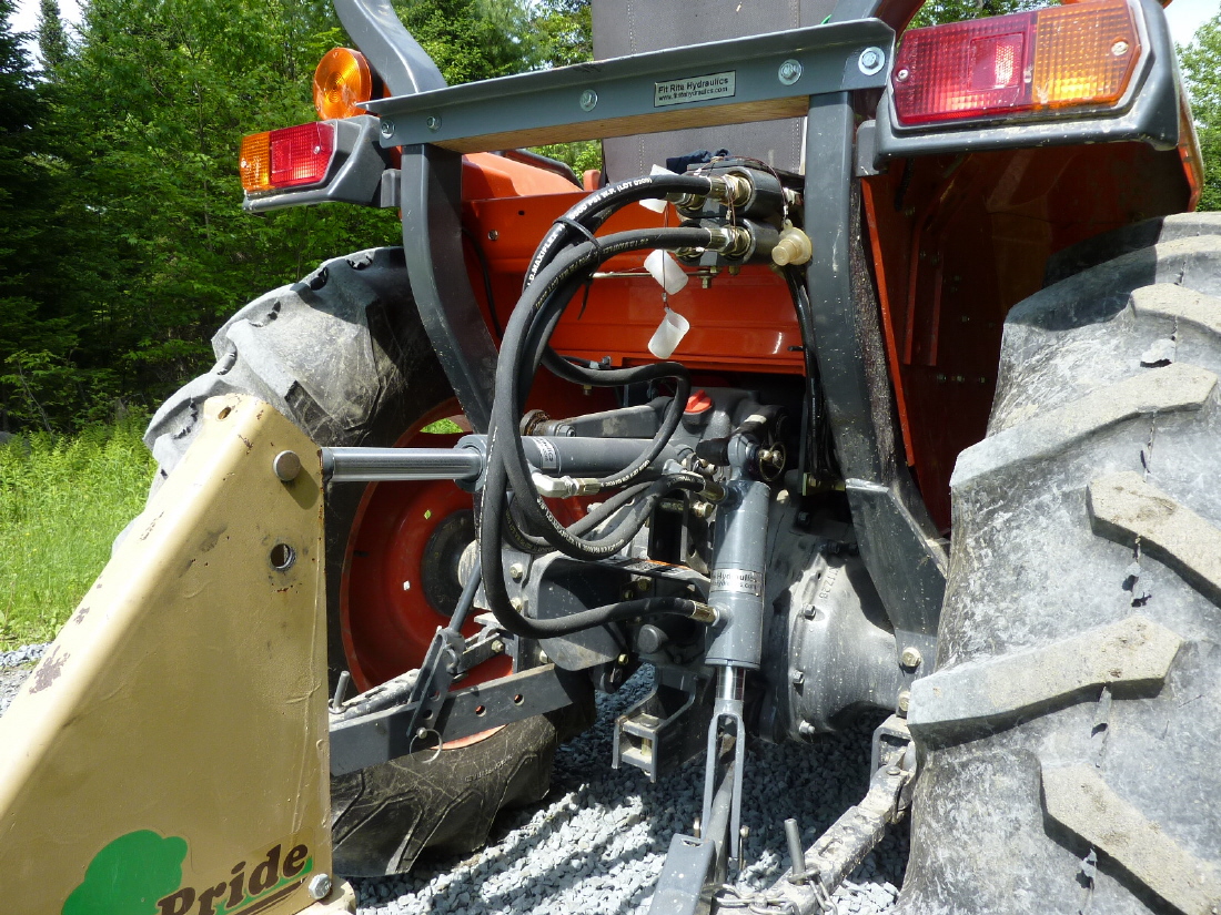

/ Best Hydraulic Top Link??? #5
I got mine from FitRiteHydraulics.com
Excellent quality and knowledgeable friendly service.
I don't have check valves on mine and don't feel the need for them.
There seem to be a lot of opinions on them but never having used them I can't say which I like better. I have heard that they make it harder to feather an adjustment because you have to overcome the pilot pressure before the cylinder moves but I am not sure if this is true in all cases. Some people use flow limiters to help with feathering if their valve does not have good control at low flows or if they have check valves.
