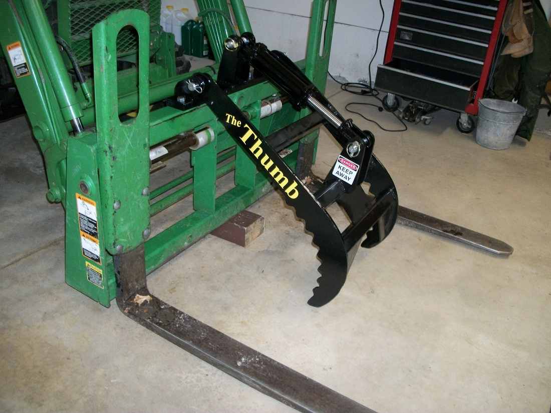

I didn't want to overload the FEL with a lot of extra weight in steel.
I find "The Thumb" to be more than adequate to grapple brush and logs, as well as rocks, and adds little weight to the front end. Can pick up huge loads of brush from tree tops, as well as anchor logs to the forks for carrying and for holding while bucking off firewood lengths.
That is a great setup for exactly what you describe; makes a man want TWO grapples... o_O
This is what I want to do! With a set of forks from either mytractortools.com or AI2. With one of their quick attaches.
