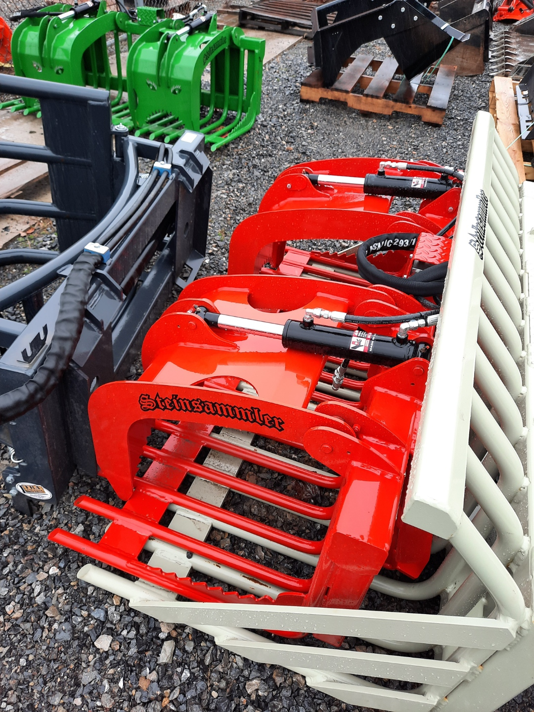

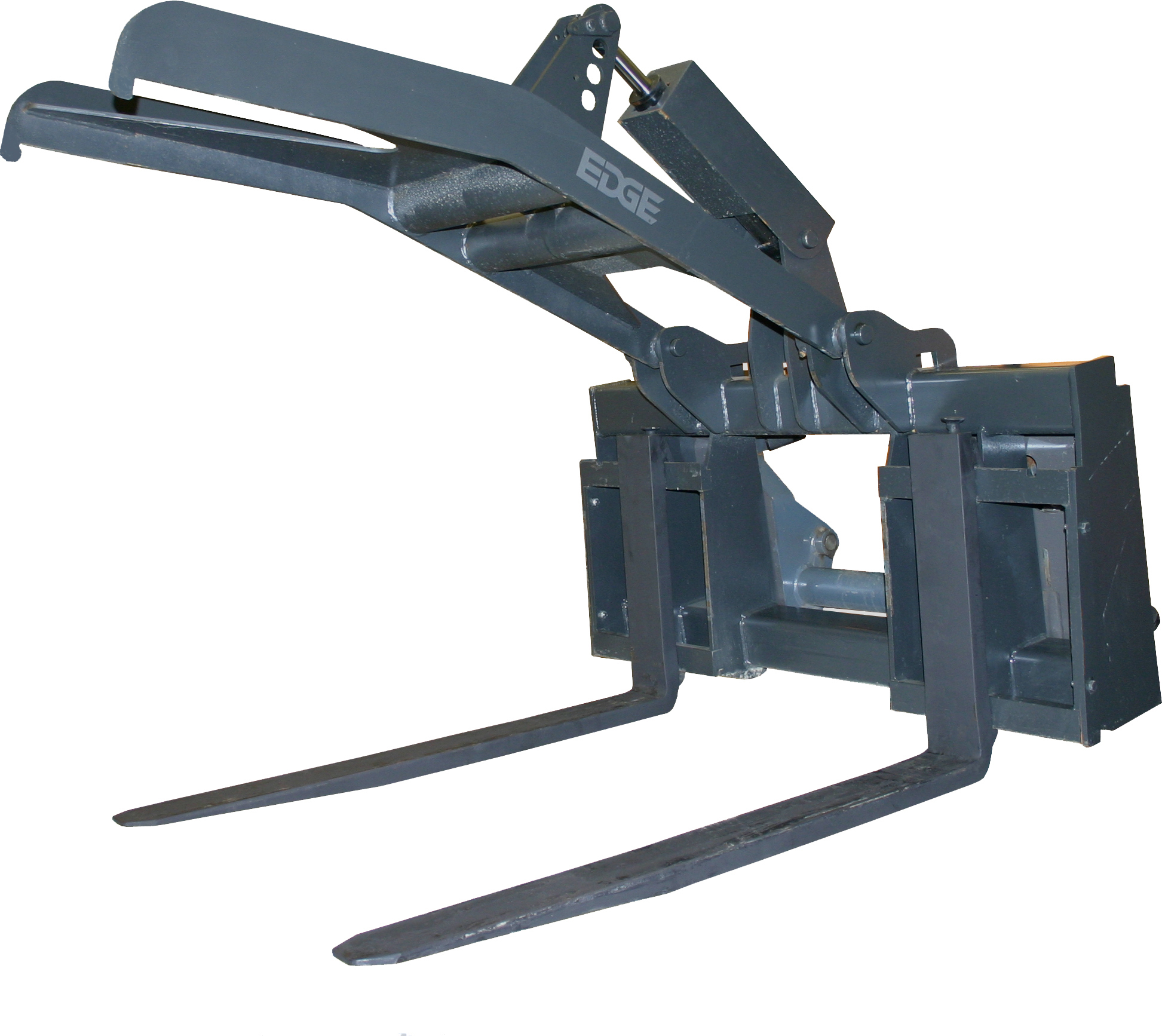

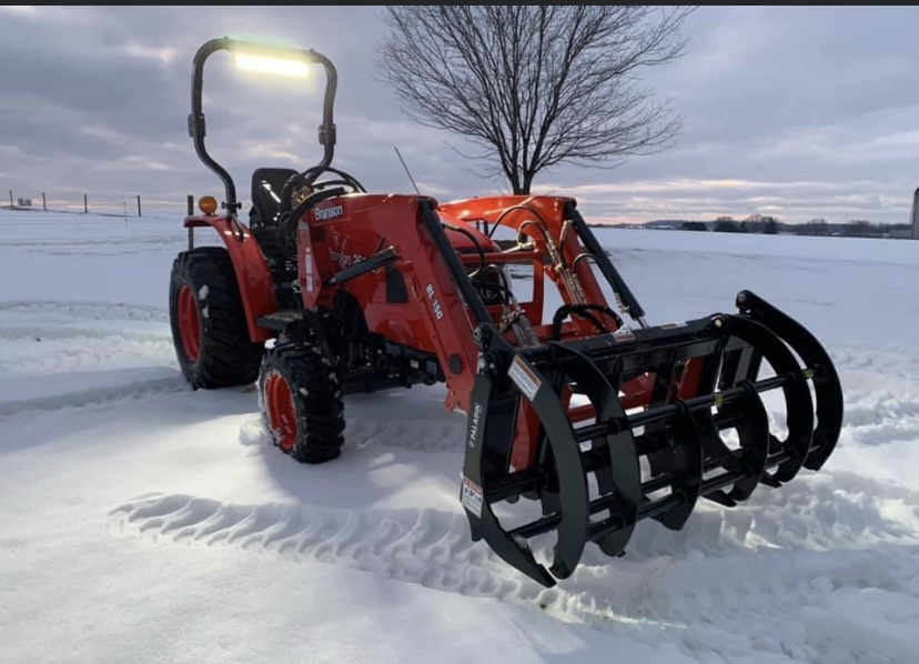

I have a lot of brush piles and down trees I’ll want to move. I can get two styles of grapples I’m wondering which one y’all would recommend.
Here is a photo of an example brush pile and the two styles of grapple.

Based on its construction, I’d go with the second one.

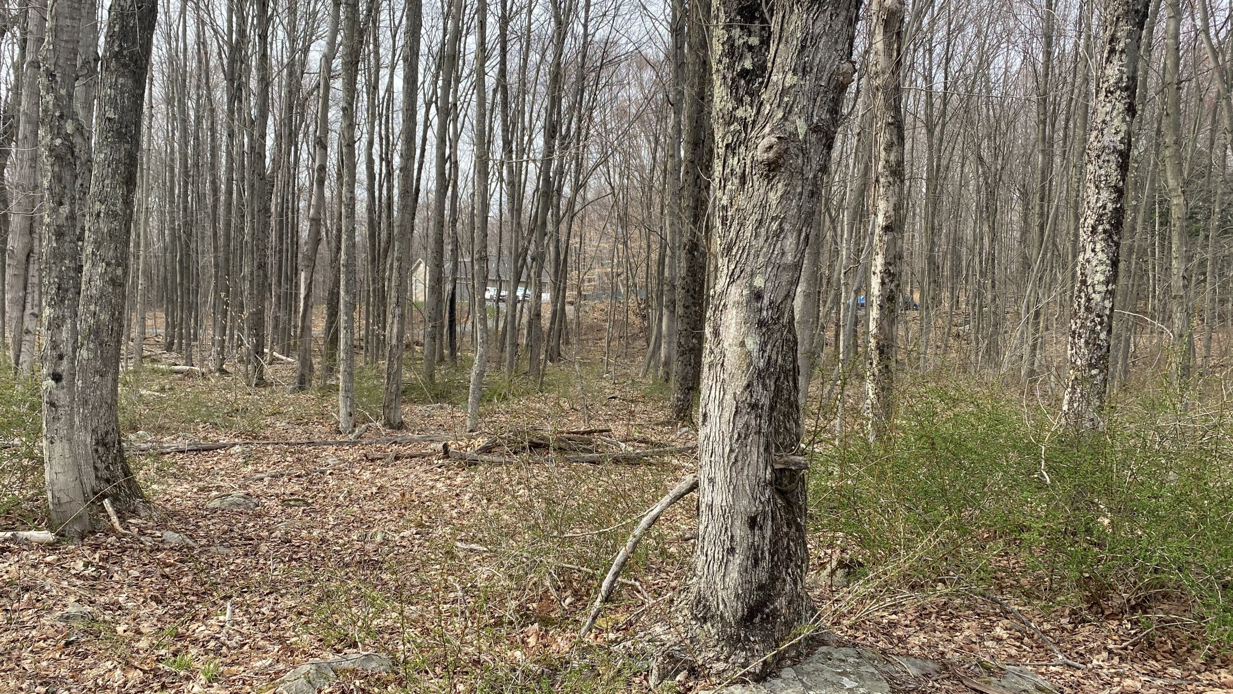

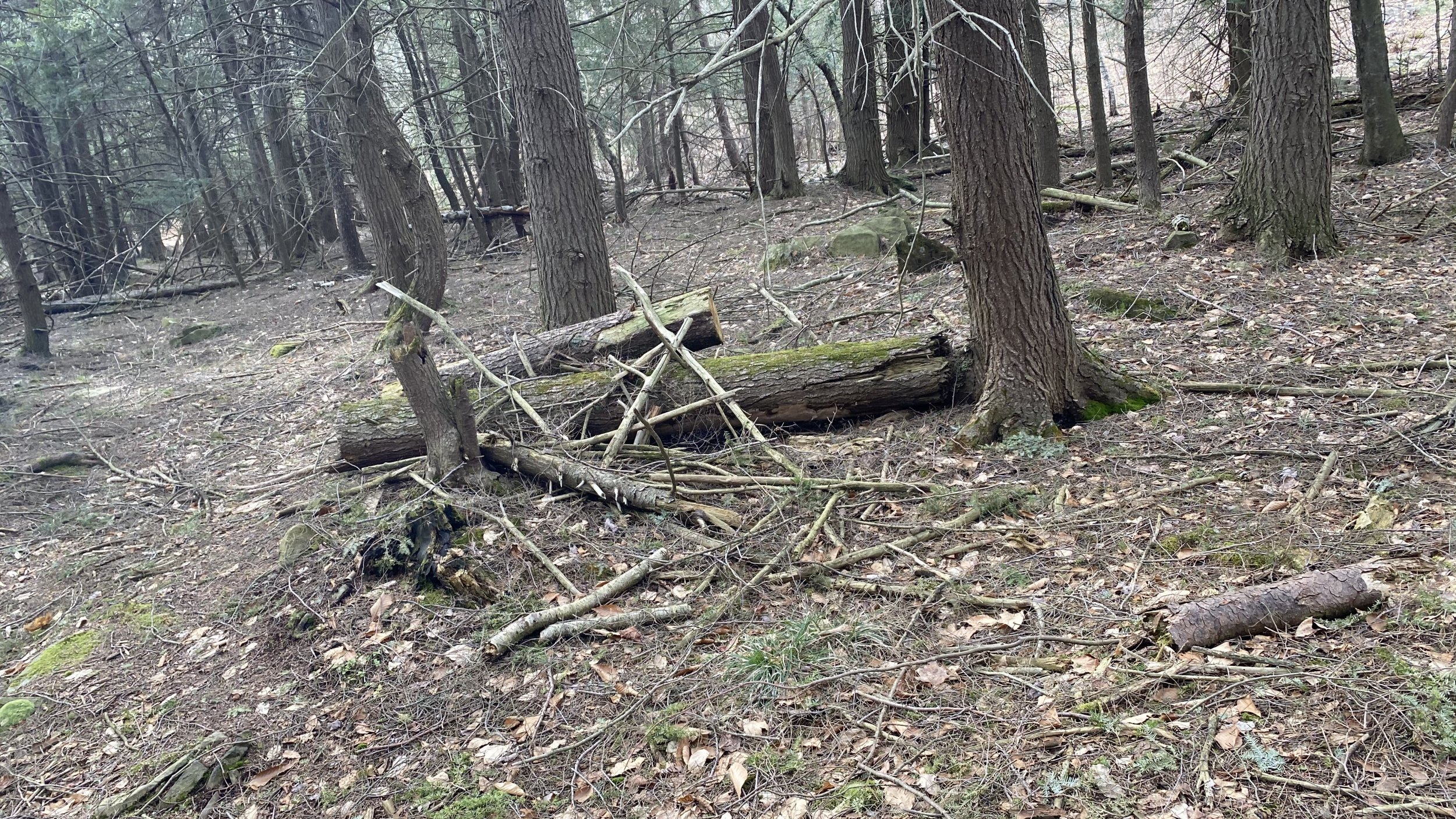

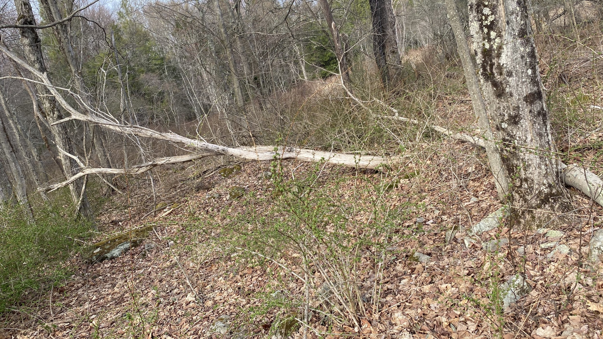

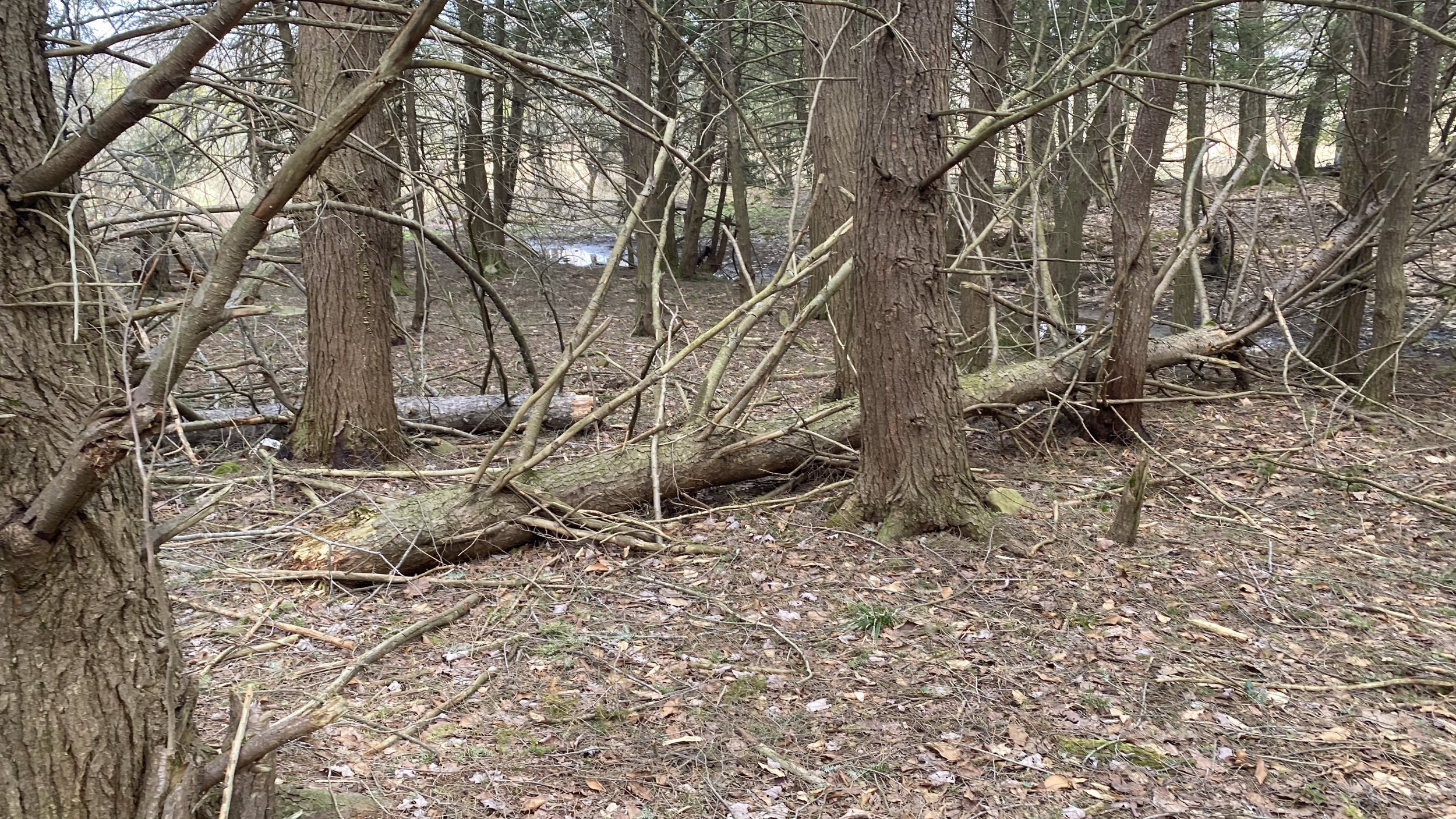

Some more pics of things I’d pick up

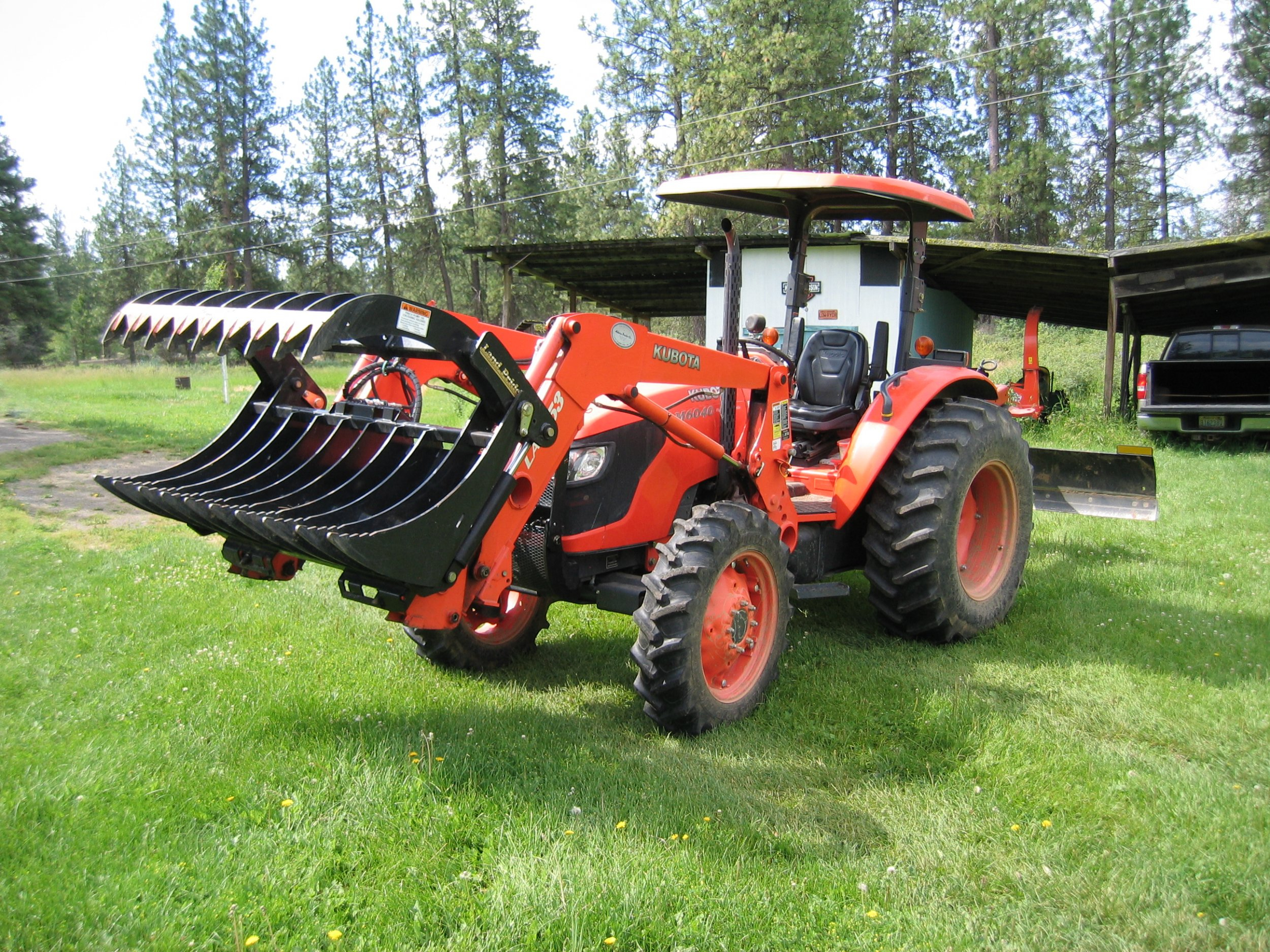

I really like my EA grapple. It is designed to rake up loose material, and it works really well.

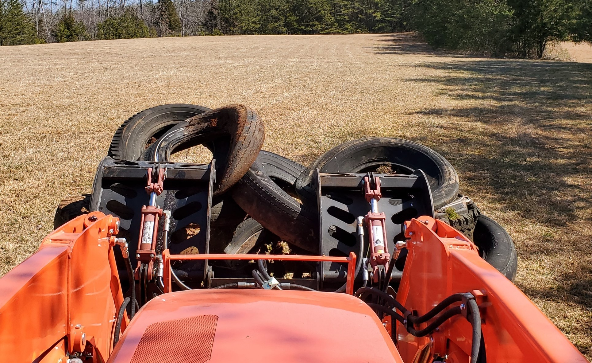

I got the long bottom tine style from EA. Mostly for brush and logs. I think the long tine style can carry a greater volume but it would not be as good for ripping out shallow roots. For brush piles I push the pile with the grapple tilted down, then curl it over and close the lids. One advantage to the long bottom tine style is that you can use it as a carry all- open the lids and tilt it back and you can load small logs into it. Sometimes it's easier to do that than to pick them up with the grapple.

I bought this one because of the raking ability of the tines; look at it in closeup... those front rake tines are no lie. I totally abuse that thing and it handles it perfectly. I don't handle a whole lot of wood with it, but it can do it. Oh... and it hauls old tires really good, too.

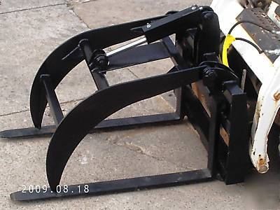

For that stuff? I’d get a set of adjustable pallet forks with a grapple. That way you can easily slide the (2) pallet forks under logs, then clamp down on them. The forks have adjustable width for different materials.
As a bonus, you also get a set of pallet forks which have multiple uses.

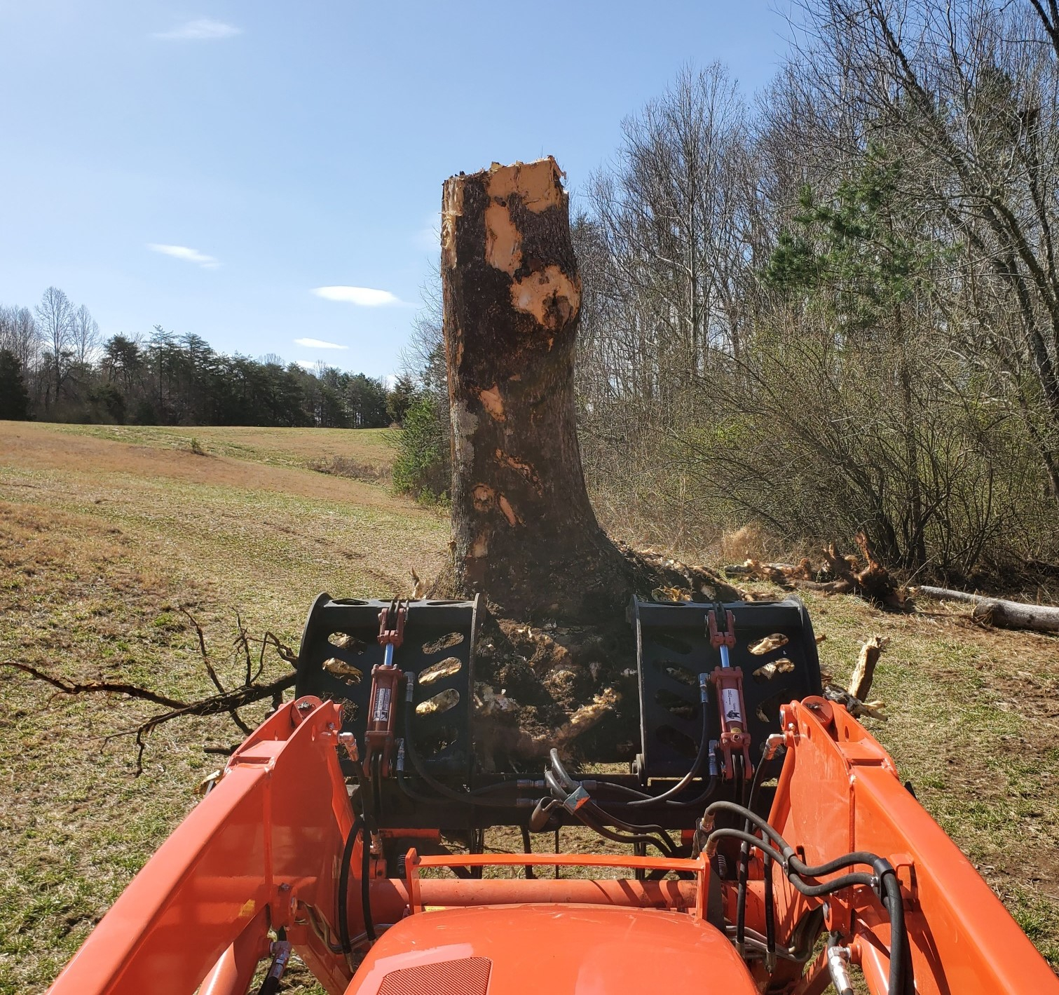

Really depends on the lift capacity of your tractor (once you get one). Any grapple is better than no grapple... for me, cheaper and lighter is better. It looks like to have tight spaces to maneuver so smaller one with a single lid would work better for you.

Clam shells are nice for rooting out things. If you want to carry things L style is better, even fire wood can be carried, not just logs or stumps.

Really depends on what else you want to do with it. Either is capable of doing the same tasks, but the short tine is usually more optimized for ripping through the ground to rake out roots & rocks (within reason since a tractor's FEL is still a tractor's FEL). The long tine does make it easier for also using it as a carry-all/bucket with the lid open or closed though....
Just to be clear, as quoted above, my issue with the first grapple was its use of round bar stock for the lower tines - not the fact that it is a "L" style grapple.
I suspect that the round bar stock will be prone to bending with any attempts at digging out roots.
If digging out roots/stumps is nowhere on your horizon, then probably not an issue.
yea I’ve been wondering about the design of that one, it’s unlike any others I’ve seen. I need to get specs on it.
i feel that i will likely be rooting smaller things with a grapple at times.
this is really helpful. You are saying the longer tines can still do the ground ripping/rooting though?
