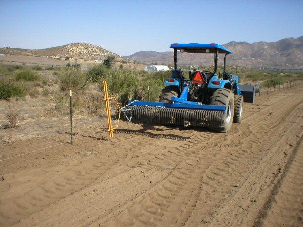

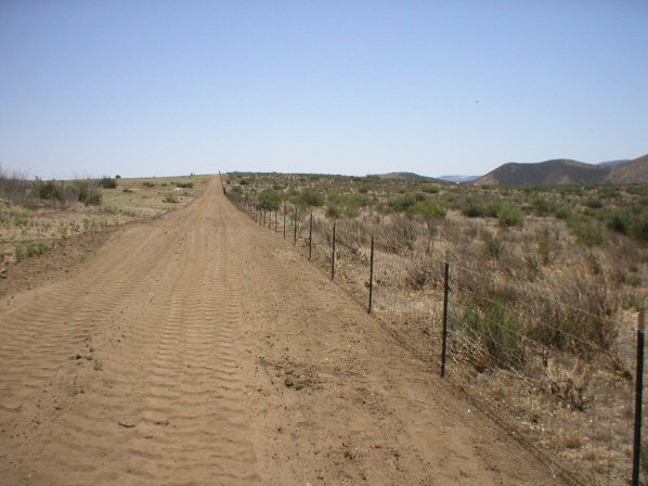

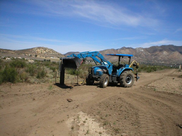

/ Best fence options #6
flusher said:
I have 10 acres, perfectly square, 1 furlong (660 ft) per side. Next year I plan to install new fencing. I'm leaning to an all metal design-T-posts, 4-ft high farm fence, H-braces from salvaged 4" dia steel pipe. Fortunately I have a corner parcel so I only have 2 furlongs (1320 ft) of fence to install. The South and West fences belong to my neighbors.
So you want a fence similar to this.:)
