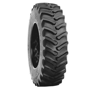

R-1's are typical agricultural tread.
R-2's are rice and cane tread. Deep lugs, not wide or flotation.
R-3's are Turf or Diamond tread.
R-4's are Industrial tread.

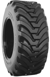

Dixidog.. Can you post a photo of your tractor and tires? I'm trying to picture how the chains get between the lugs.

Around my part of the woods, R-2's ARE deeper lugs AND wider and some refer too them as flotation type tires. Loggers use them when working in a wet area. So, do you have a smart answer for that. If so this will be my last post in this thread, Not interested in getting in smartA typing contest with someone who thinks they Know All.

beenthere, hopefully the OP will post a pic. of them. I haven't seen any 14.9 R-4's most of the 00.9 series are R-1's but I've been wrong many times before.

I can't post a pic of the chains between the lugs anymore, after a suggestion from Beenthere I removed my chain tensioners and they no longer get stuck in between the lugs. I will try to post up a pic of the thread pattern tomorrow so you guys can see if they are truly R-4's or if I am mistaken, it's too dark to get a pic tonight.

DIXIEDOG, I stand corrected. Those are a R-4 type tread, they look to me as an odd looking tire. What brand are they?
