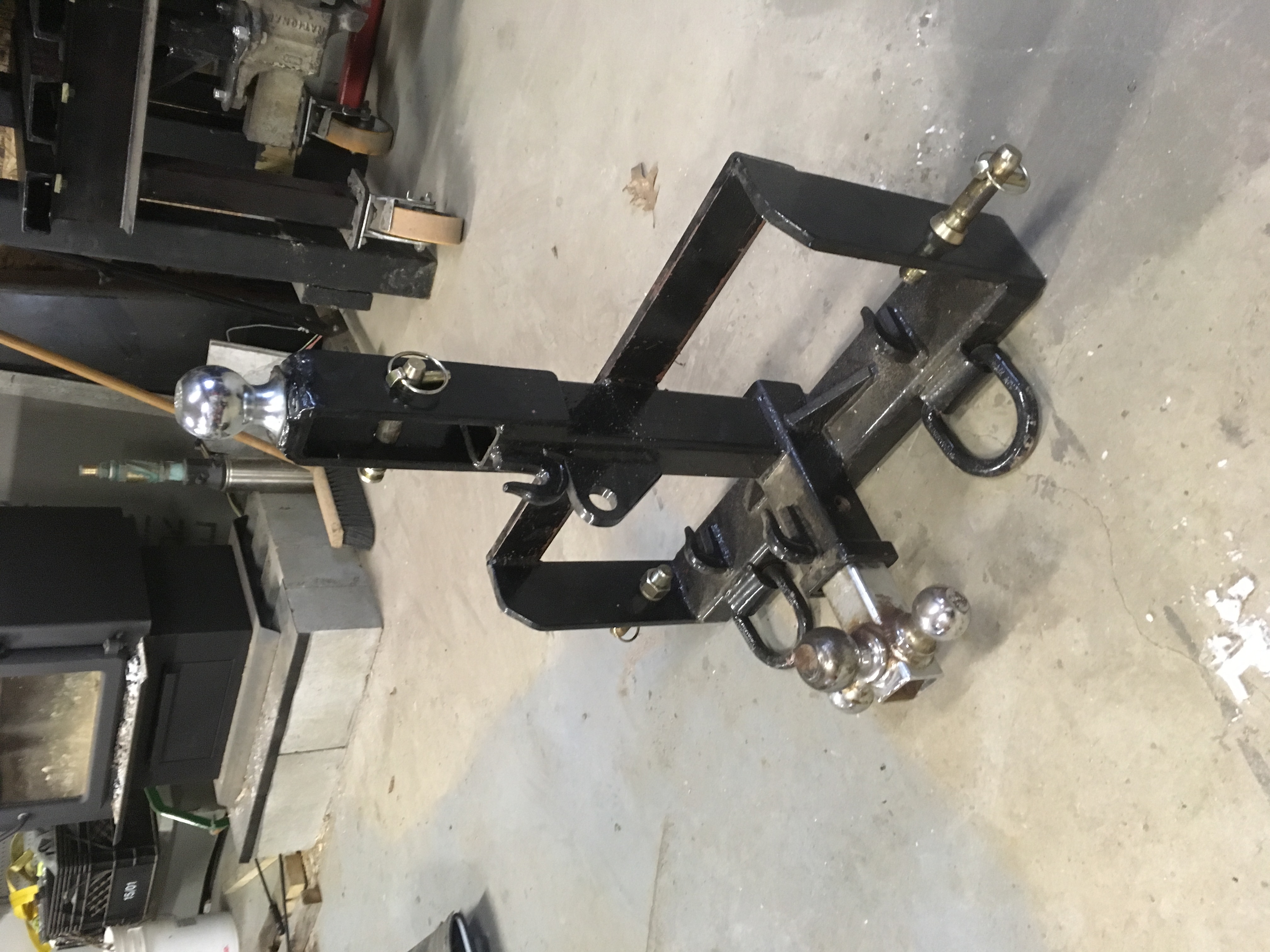

as requested, here's the trailer mover I built.
its all 3/8 or 1/2 inch material.

Have you found any secondary uses for yours?? :confused:
I have a forged hook that goes in the 2" reciever that I used with a brush grubber for pulling out small stumps
all the grab hooks and loops make it easy to drag anything behind the tractor (logs mostly)
I find the real value is being able to move trailers around the yard, without getting out of the seat. drive up, lower the 3pt, watch behind as you back up tot eh trailer, lift the 3 point, move trailer... drop 3pt. I've only seen one better option, and that was a hitch ball on the bucket of a back hoe!
/ Best Attachments to start with? #38
Mine is CATII,, it is designed to be used behind my 584 IH,,,
before I would use it for much stump removal,, I think I would need to add some gussets etc,,,
Mine was originally built for some simple trailer moving,, not high power yanking, twisting, and pulling.
if I hooked a stump to mine as it sits, surely the stump would tear it apart,,,
