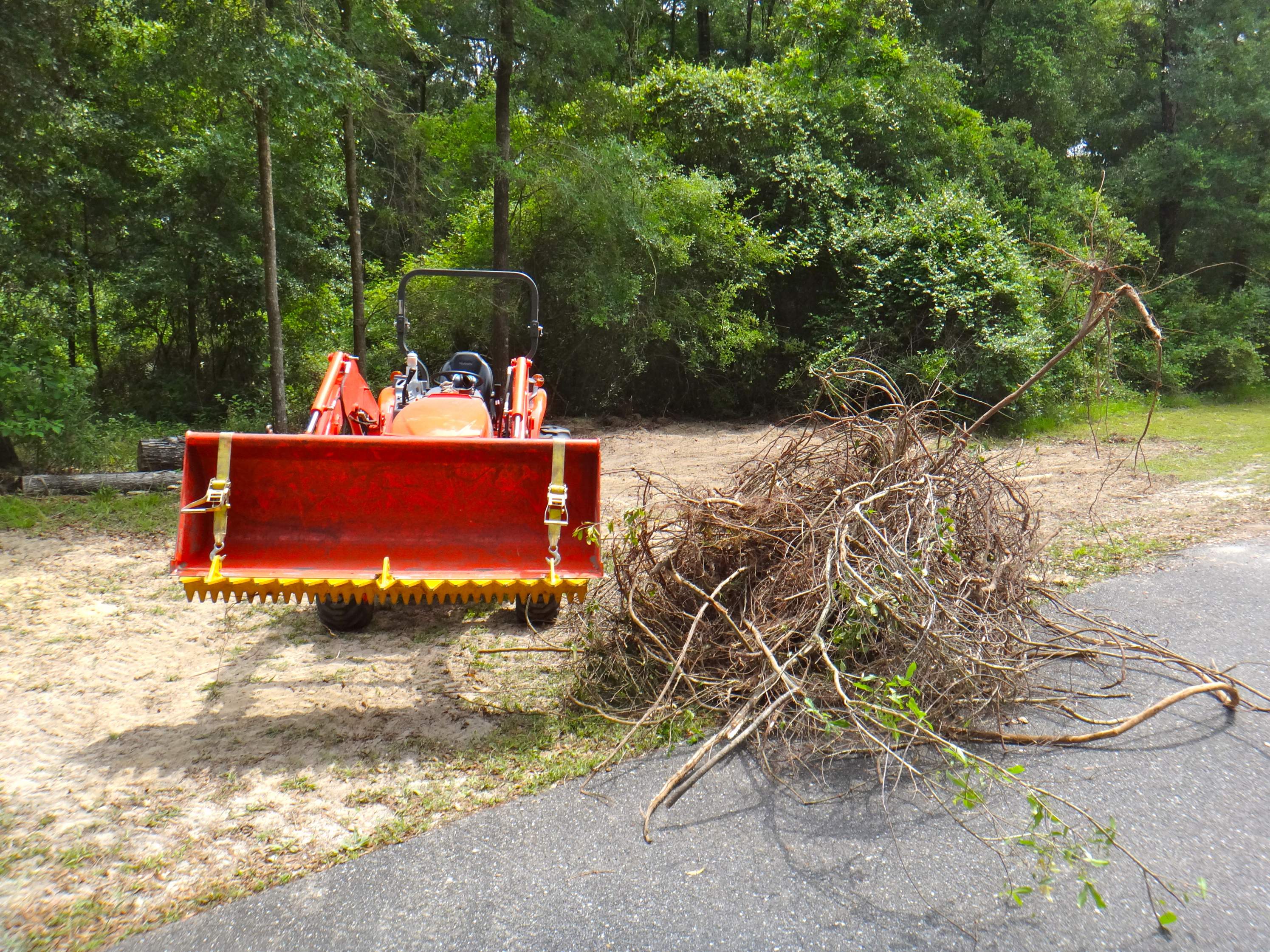

I suggest a Ratchet Rake bucket attachment as your first tractor tool.
Nothing better for tearing out and piling brush.
Good for light grading such as your driveway.
Can open a small garden plot.
Ratchet Rakes are sold by Tractor Supply Company, but TSC seldom has more than one length in stock.
The T-B-N store, button at top of page, is an agent for Ratchet Rake and ships every size. Convenient delivery by FedEx.
