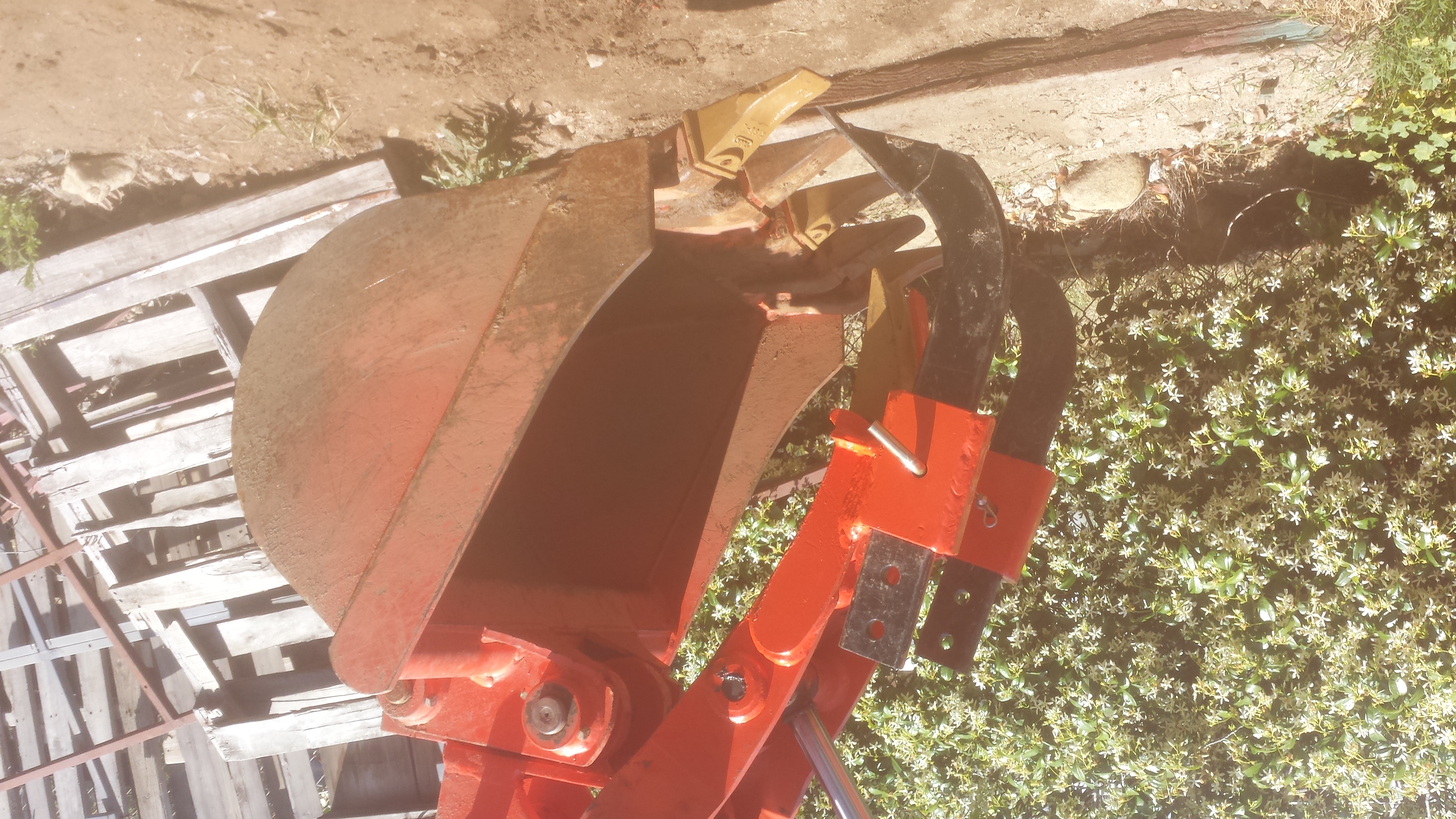

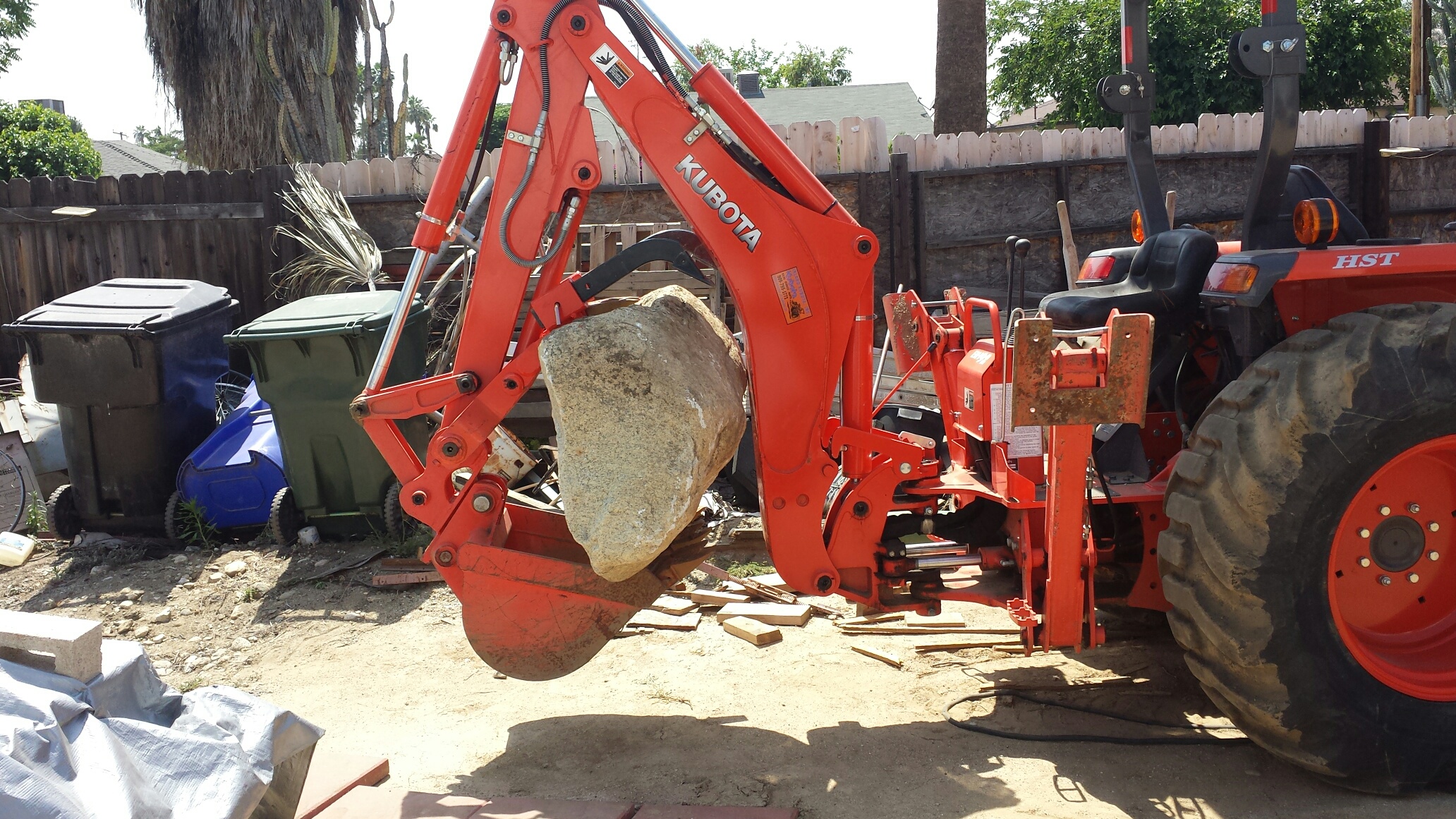

Backhoe with an Hydraulic Thumb worked GREAT for me20190616_145053.jpeg20190525_112816.jpg
I dug out some big rocks digging a new Leach field for my home.

Been there, done that like your first picture. One had the front wheels of the B26TLB off the ground trying to lift it. Had to finally skid it out of the hole. Only the top of the rock showed up in the driveway. Dug it out before spreading gravel. Jon
