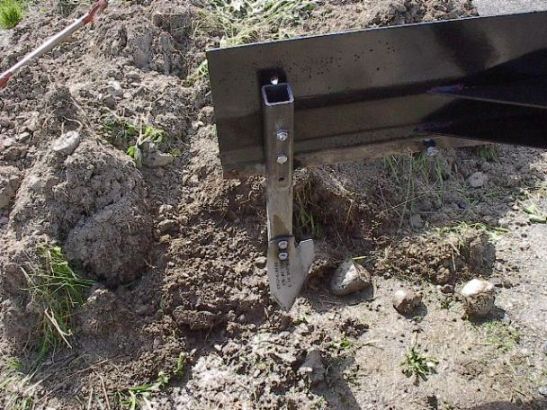

/ best attach to dig elect lines? #9
This is what I did. Works great. I made mine offset. G
