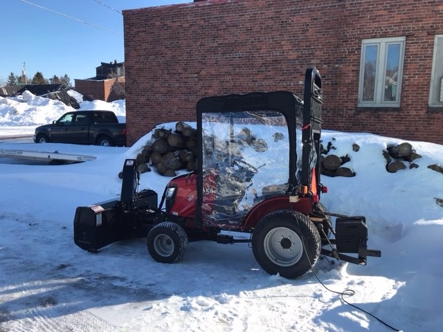

I've got their 56" on the front of my TYMT254. Have had no complaints for the one season I have used it. It runs off the mid-pto on my tractor and there is a belt on the back of the blower housing that drives the impeller shaft from the pto shaft. I have hydraulic chute rotation and added an electric deflector control. It throws the snow as far as my Honda walk behind can (30-50' depending), just twice as much. I live in an area that receives more than 250" of snow on average. Buffalo talks about all their lake affect, but their lake eventually freezes over, ours doesn't.

Well now 4 storms in and just did 9" of heavy wet snow, I'm very impressed with the Bercomac 56" front snowblower. Even the wet stuff it was pushing 30+ feet out.
/ Bercomac 56" snowblower vs Kioti 54" #15
For me distance is key and the Berco has delivered for my set up. I can get the end of driveway stuff across the street and into the Village snow dump, even into 15mph winds. I do wish it were a bit taller, we got a dumping around the 13th of January and it was about 6" above the bucket, so i pushed through, backed up and made a second pass to get what flowed over the blower. Got their cab too which although isn't ideal for vision, I am so much more comfortable than my walk behind. May do the Lexan mod on the front too help see a bit better.
