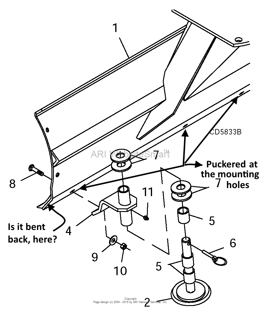

---- But my Mahindra 3016 with me driving it destroyed this current blade I have. Mounting bolt is broken. It even has puckers where the cutting edge bolts to. This is 1/4" thick metal with puckers. I don't know how that happened. ------------
The only way it could pucker the cutting edge mounting holes, is the force at the bottom of the cutting edge from hitting stuff while moving forward. The cutting edge would try to pivot, pulling on the mounting bolts, bending the metal in.
Did the bottom of the blade bend, where I added the arrow on the left of the drawing?
From: Pat's Power Eq.
Thanx Fax for all of your help with this including my pm to know if a shop press would work on this. No, to answer your question about bottom impact. There is a slight kink at the "top" pf the blade where the no.1 is. I think i did that a long time ago when it caught behind a tree. The force necessary or the cutting edge to "pivot", I would first think the tractor would have been stopped cold. At any rate, it is what it is. This blade seems to be weak for the tractor but before sold it, I would want to completely recondition it and that includes getting rid of the bends and puckers.
You are welcome, It would take a large press frame, twice as wide as the blade is high, to remove the puckers.
I would remove the cutting edge and try using a grade 8 fine thread bolt with a washer on each side and an impact wrench to flatten each hole.
Please post some pictures of it.
I shall and it IS rather strange.
