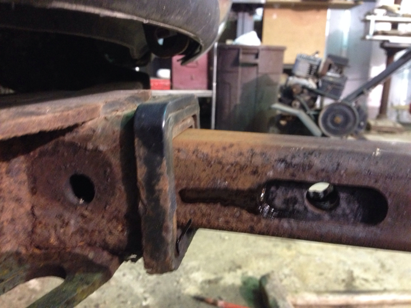

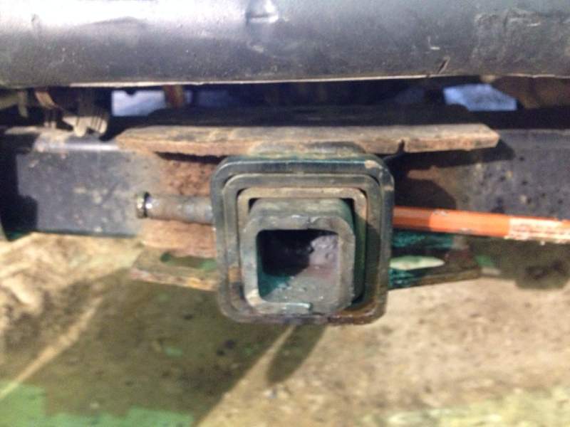

About 3 years ago I bent the hitch pin on the truck receiver using it to pull a stump with. I have learned my lesson on jerking on the hitch. I haven't been to worried about it til now because I don't have a bumper pull trailer. Well things are changing and I need to fix it.
I have cut the pin off and tried to drive it out. No go. It must be bent like a u. Tonite I took a razor wheel and cut the 2" tube off thinking I could get the torch in there and cut the pin from inside. There was a rubber cushion in it. When I got that out, there's a steel plate in it so you can't see the pin. The back side is capped also.
Does anybody have an idea what between the plates. Maybe another chunk of rubber surrounding the pin? Anybody got any ideas what to do next. I'm thinking if nothing else drop below it and weld a new 21/2" tube underneath. This hitch is on a SD with several sleeves inside it. Thanks for any help. The new 2 horse trailer will be here next week.

Can you line up a drill bit the same size as the pin and drill as deep as the hitch receiver on each side ,then drive the whole tube out?

The pin is inside of the receiver 2 x 2 inch tube and bent in a 'VEE'
How about locking it in place with vice grips with the bottom of the VEE facing rear.
Position a solid steel rod or bar and with a heavy sledge giving it a solid wack or two, that should reverse the bend and possibly then you could drive it out from the side with a punch.

I would just replace the hitch. All of the heating and banging can't be good..I certainly would not weld a new 2.5 under the existing..Way too much risk there..I have jerked draw bars until I nearly pulled the wheels off the ground or snapped tow chains and still never bent a pin...I wonder if there is other hitch damage related to this.

Thanks guys. I will try drilling it. If that doesn't work I guess replacing it is the only way to go.

I got that ucker. It had a solid bar in it. The pin and bar stock look like they slide in the slot and cushioned by the rubber in the ball end of it.

You have a much bigger problem my friend. In the first photo it appears you have cracked welds against the hitch frame. Is so badly rusted its hard to see but I think they are there. You also need to craw under and check your hitch frame bolts. I suspect based on the load it takes to bend the hitch pin you have probably started to deform them.
Please get yourself a new hitch and possibly save your life and those of others if it comes apart. A new hitch now will give you peace of mind. While you are at it you could also upgrade to a heavier one.

I double looked at it. The frame looks more scary than the hitch or bolts. I'm having second thoughts on a bumper pull anyway. I talked to the guy today and I can get a nice goose neck for a little more. I may just use the hitch for my winch I have three goosenecks now so one more won't hurt.
