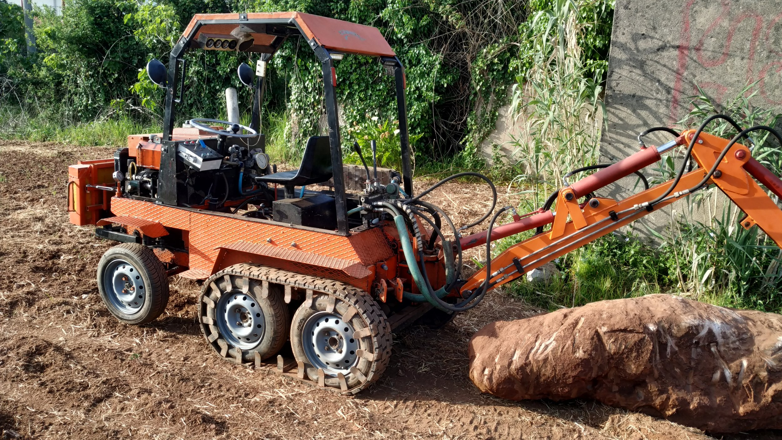

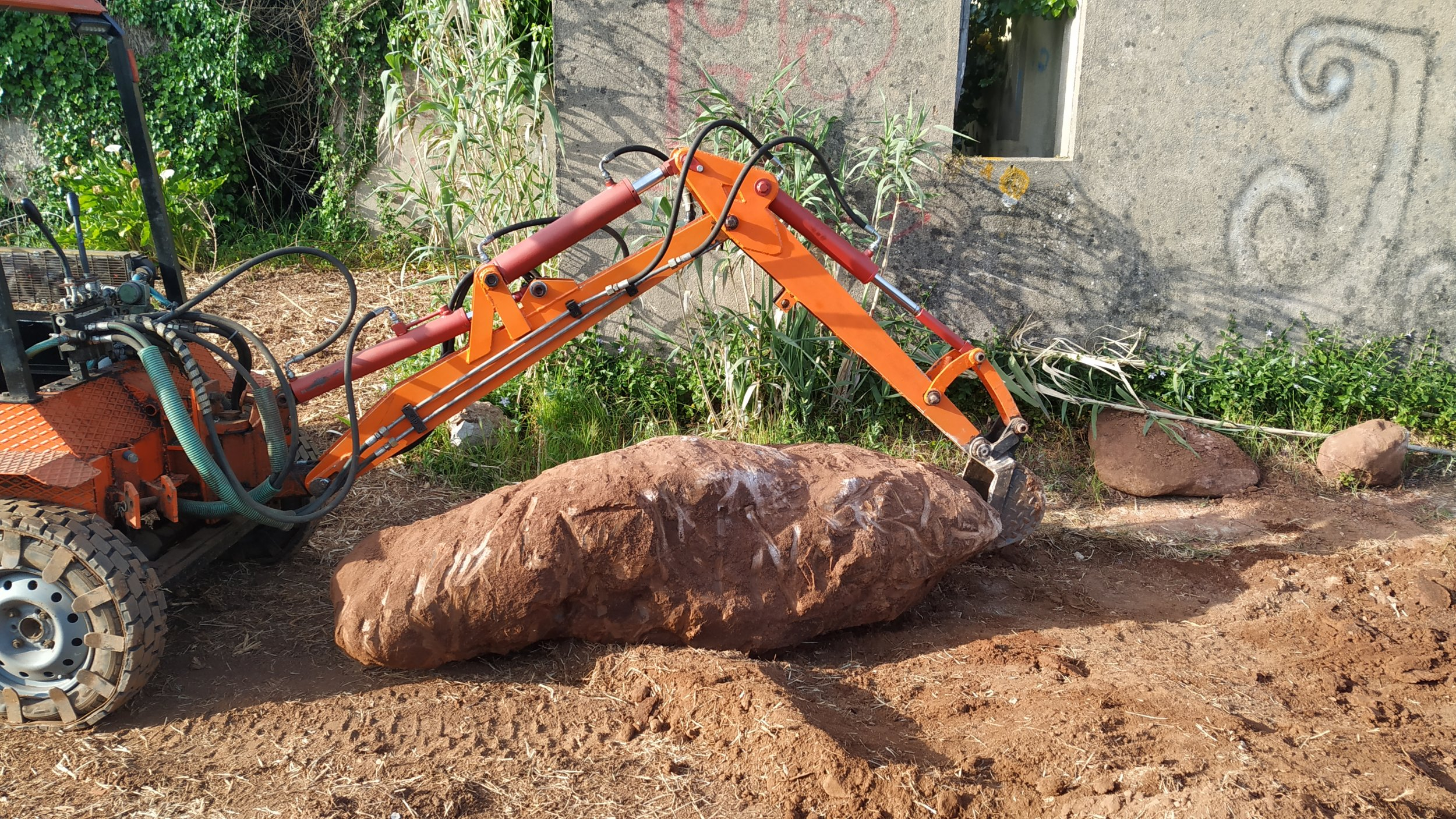

On my homemade backhoe, I used 24 mm (~15/16") and 20 mm (~25/32") pins, which are actually made out of 10.9 grade metric bolts with just the threaded section cut off. I have yet to break a pin and that thing is used and abused beyond it was designed for, but that was exactly why I built a backhoe from scratch, so I would be afraid of breaking the tractor, had I made a 3 pt one.

PT: very cool backhoe. That’s pretty amazing work. I think stabilizers would make it even more amazing.
   / Bent bucket cyl on model 48 backhoe #19
Thanks! Yes, it had stabilizers, although I had to manually apply those by lifting the machine, move the stabilizers down and put the pin on. This was not very practical, specially digging trenches, so I never really use the stabilizers much.
The machine handles alright without the stabilizers. Only tip it will lift the front, since it has a pivot point in the middle of the 2 rear axles, is when I'm digging stumps or rocks, or lifting something heavy. In those cases, I just put two blocks of wood between the subframe and the main chassis to prevent it from pivoting.
I think a rear blade would be more usefull and that's future plans for the machine.

The mini excavators don’t have stabilizers, but have a blade that can serve the same purpose, so your comment makes a lot is sense. I think maybe their tracks are wide and stiff enough to handle the load.
Looks like you dug up a dinosaur turd.
