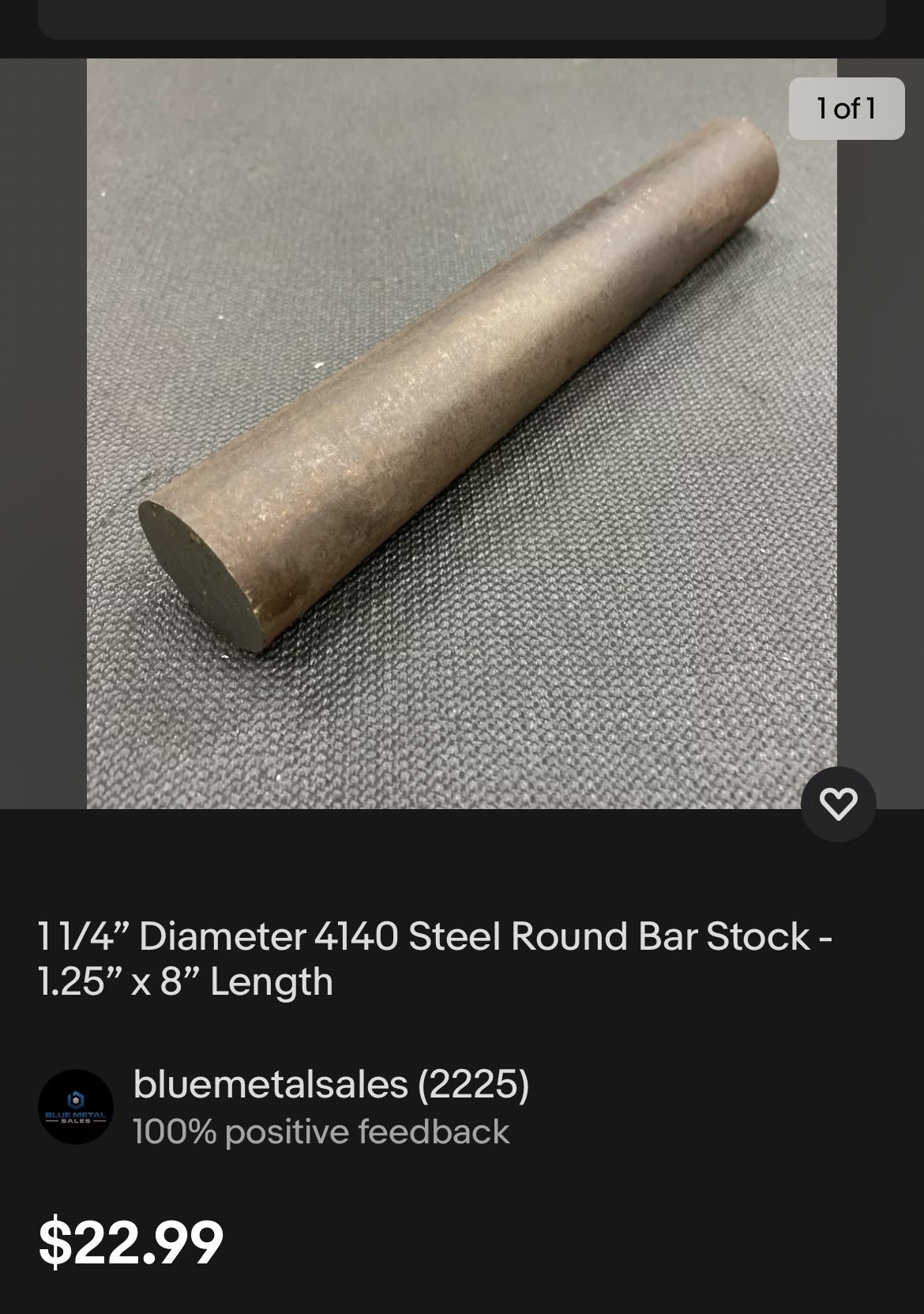

What will you do about the cylinder end cross tube bore?
   / Bent bucket cyl on model 48 backhoe #56
I purchased a 1.25 “ x 8” piece of stock steel and some bushings. I’m not sure if I’m going to use the original bolt hole to hold the pin. When the new cylinder is in place I can determine if I need any shims
   / Bent bucket cyl on model 48 backhoe #57
