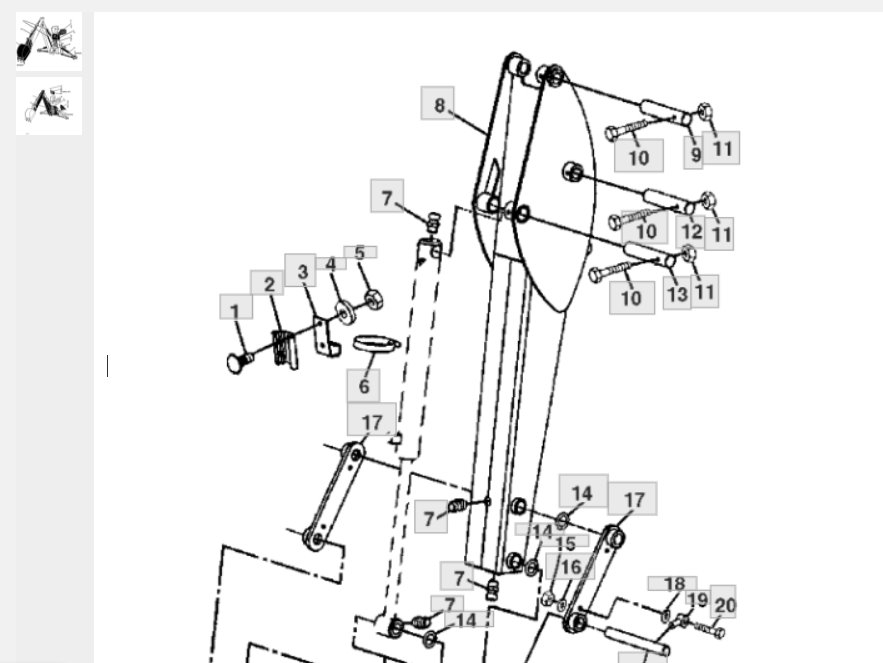

I need some help from somebody with one of these model 48 backhoes. I need the length of the upper cylinder pin, #13 in the attached exploded diagram. I received the replacement cylinder and will need to make a new pin. JD used a 1 1/2" pin, but the new cylinder has a 1 1/4" bore in the body pivot, so I need to make a new pin and machine some bushings. I live in MA, but the machine is in NH at this time. I failed to measure the width of the dipper up by the pivot. The JD dealer doesn't have any info on the pin dimensions, so I'm left guessing. I could make the pin long, then cut it down shorter later, but if I had the exact width of the dipper, I could eliminate that step. Thanks!!!!!!!!!
Here's also the URL for the parts catalog page:

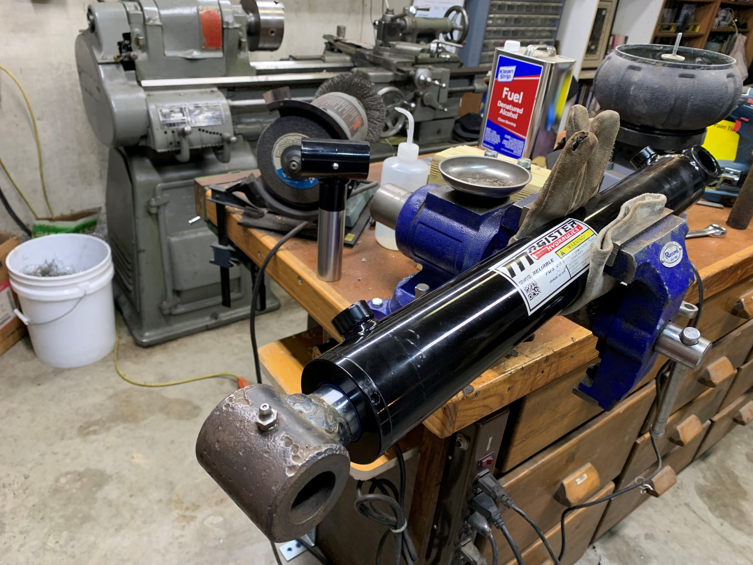

Yeah, I called JD on replacement parts. They said the replacement cylinder is $1500, and it's not available. They do have a replacement rod for $500. I'm not doing that when I could get a complete new cylinder from Magister for $177, including shipping. I just need to do some minor machining to make it work. I just went through the same thing with one of the stabilizer cylinders. I have no desire to "keep things original". In my case, I'm adapting things so the machine is compatible with common off-the-shelf parts, rather than getting screwed by JD. In the case of the stabilizer cylinder, I just needed to stretch the stabilizer arm 2" longer to make it compatible with a cylinder from Magister. In that case, I didn't have to make any changes to the cylinder, so if I drop another rock on the chrome rod, I can just pick up another cyl for a couple hundred bucks and I'm back in operation. I'm looking at options for a shield to protect the stabilizer cyl rods.

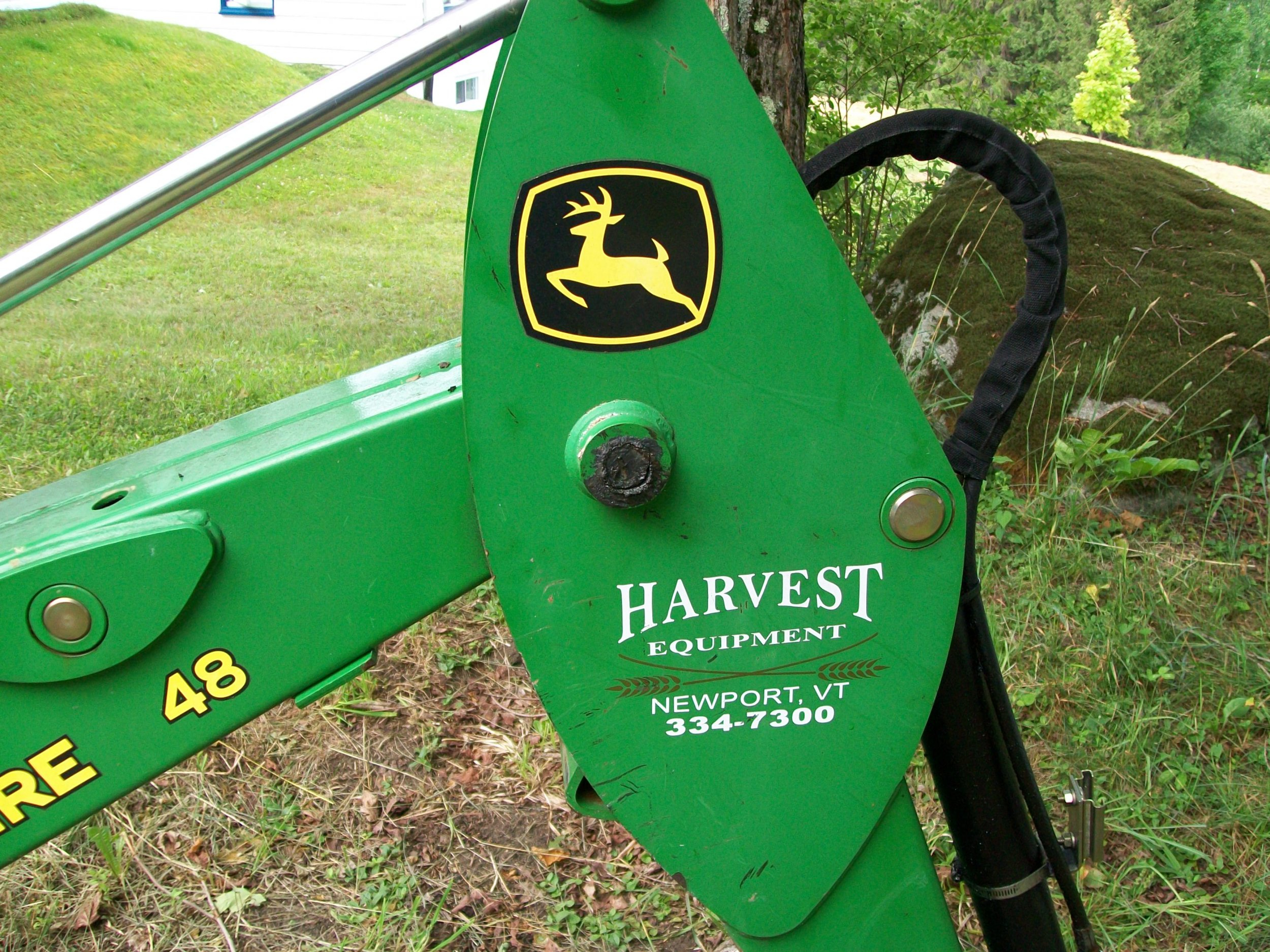

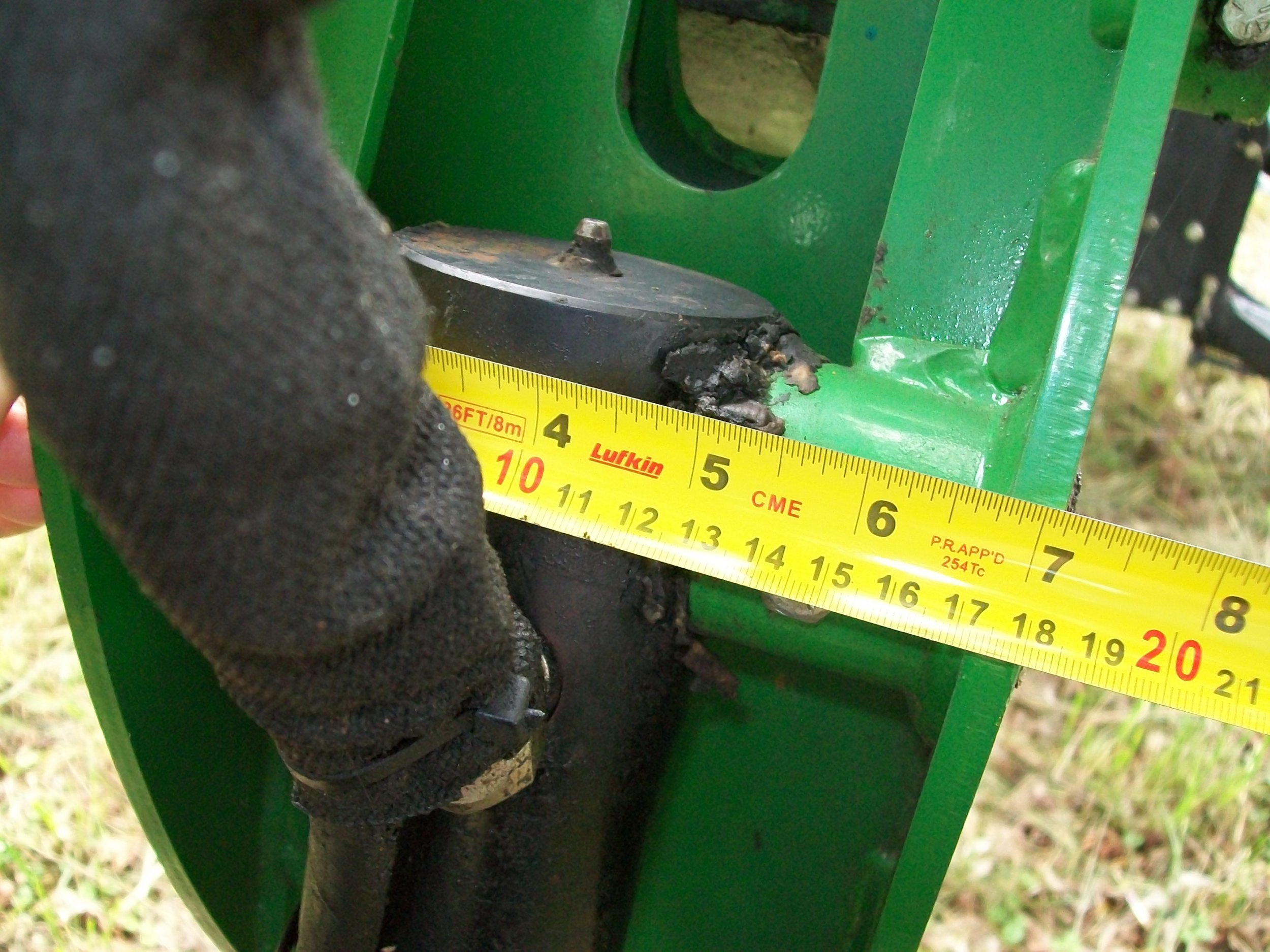

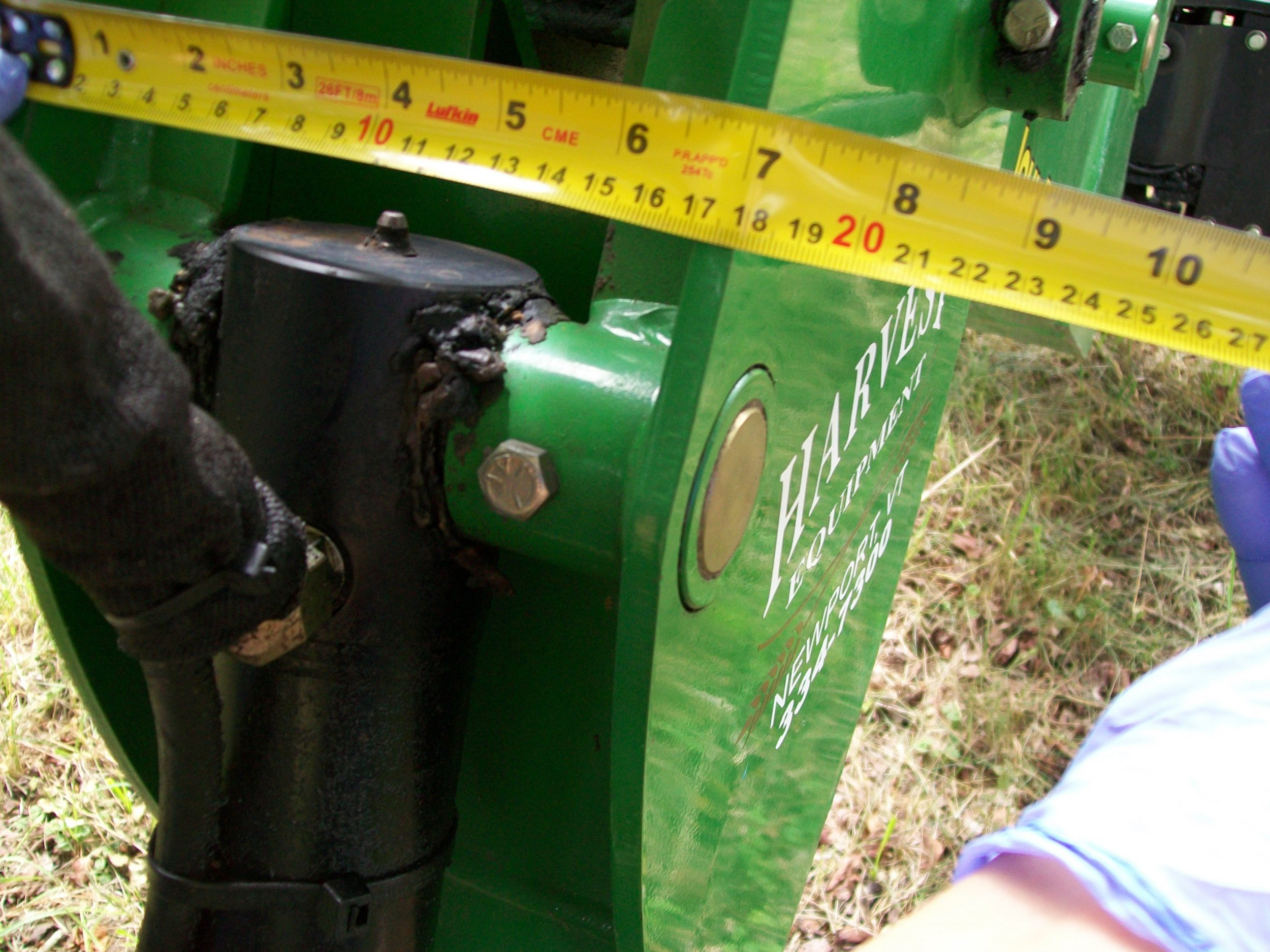

On my 48 Backhoe the overall length of the pin looks to be 7 3/8" while the width of the dipper measures 7 1/16". If you want photos let me know.
   / Bent bucket cyl on model 48 backhoe
#26
FANTASTIC!!!!!!! THANK YOU SO MUCH!!!!!!!!!!!!!!!!
Photos wouldn't hurt, if you have the time to do that.
   / Bent bucket cyl on model 48 backhoe #27
When I measured again for the photos I found that the width of the dipper is more like 7 1/4" at the level of the pin. Higher up it is more like 7 1/16".

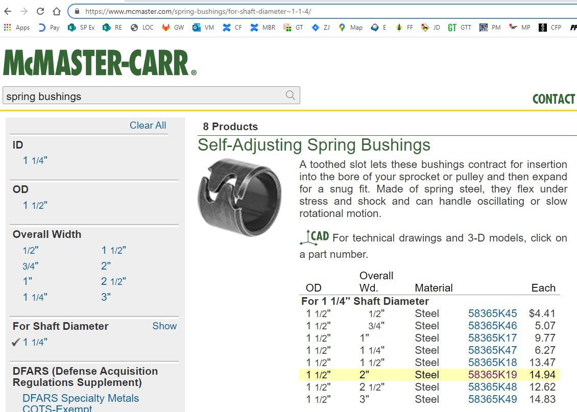

Many thanks to QuebecGuy for the photos!!!! Yesterday I met up with my buddy who's a better welder than I am. We cut the rod on the new cylinder and welded on the eye from the bent one. The cut off end can be seen in the background, in front of the grinder.
When I bought this backhoe, it had been sitting outside for a number of years. You can see that there's some pitting in the original eye. I'll put a coat of paint on it before assembly.
We discussed options for bushing the 1 1/2" dipper bore to the new 1 1/4" pin size. McMaster Carr has some spring bushings that will be perfect: 1 1/4" shaft to 1 1/2" bore, 2" long. This will be easier than making them.
