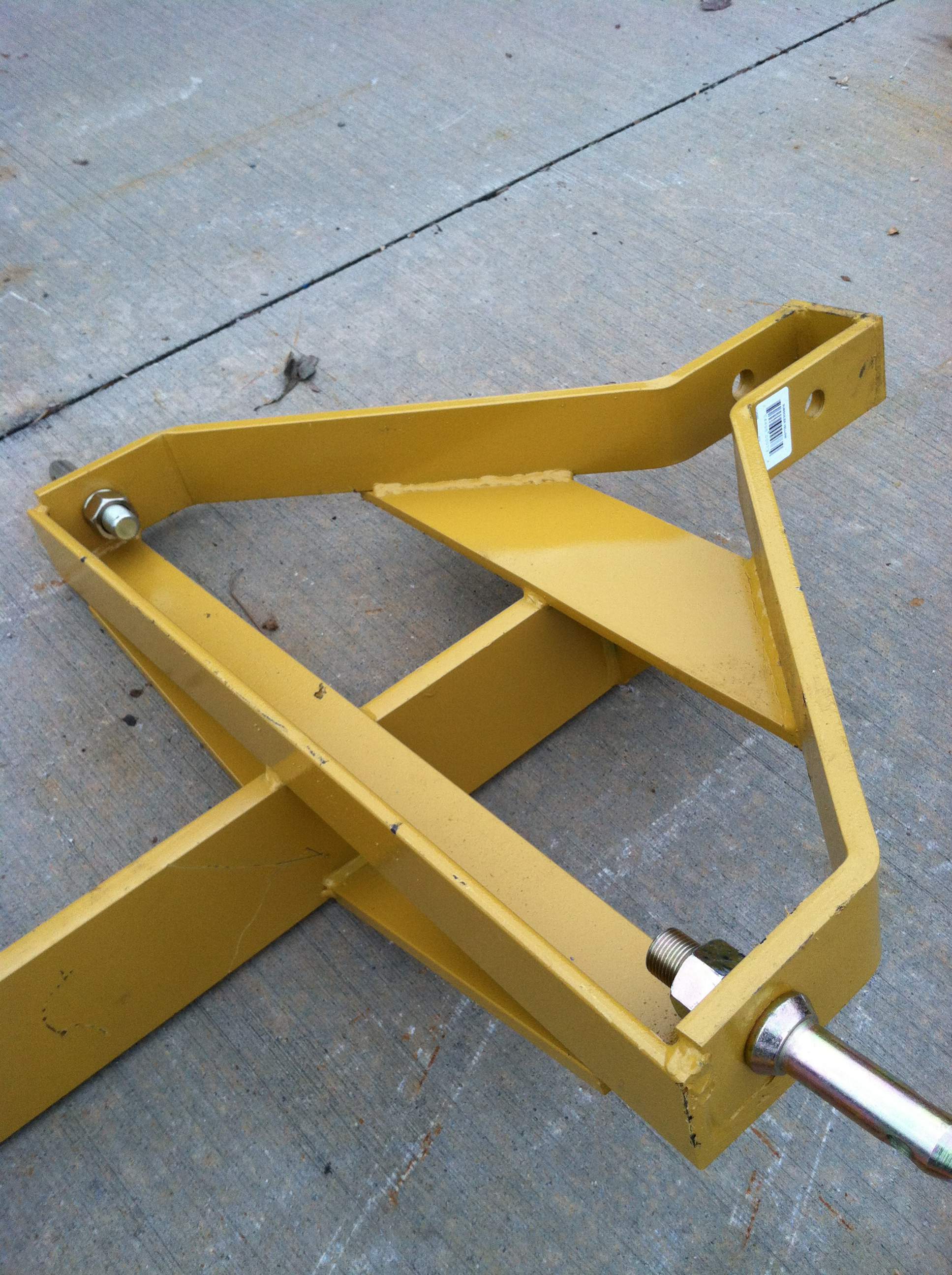

I want to make bends with a small DIY press brake with bottle jack and would like to know how many tons it would require to bend 1/2" plate. My guess is that I'd never exceed about 3" wide. Thanks.

Thanks guys. Looks like a 20 ton would be more than enough for what I need to bend. I will just be making some brackets for 3 pt hitch like in the photo below. 015.jpg

1/2" is what I have on most of me implements so that's what I was going by. Maybe 3/8" is plenty though.
/ Bending 1/2"x3" to 45-90 degrees #9
Make a bottom die that is 8 times wider than the thickness and you wont have a problem. 8x.5=4" across the top. you could probably do it with a 3" die as you wont be bending 90* just 45* or so. On a side note hot rolled steel will bend easier than cold rolled!
