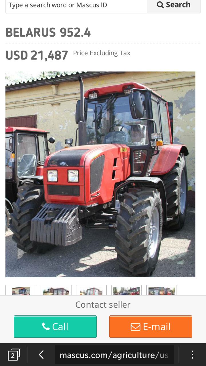

New 2016, no loader though. Lots on the web for sale, easy to find prices on internet forums as well. I was quoted $74,000 for the same with loader from NB dealer.
Matt though this tractor is listed in US$ I think it's in Europe. Maschio agricultural operates there and often uses US$ pricing.

74,000 $ Can with a loader is a fair price for USA / Canada
Thank you for the link. 28,921 Can $ (21,690 $ US) is a very suspicious price. That's bellow factory cost.
You know what they say: if it's too good to be true...
If you trust the seller, and it's not a con job, see if you can buy it.
Make sure it is a new unit .
Make sure it has correct labels on the engines for USA/Canada emissions compliance.
Check for AC availability, improved hydraulics, joystick in the cab, synchronized transmission, new electrical system, block heater and other improvements implemented on USA/Canada tractors.
Allow $$$ for shipping and customs clearance.
Make sure you have a good mechanic nearby, because USA/Canada warranty will not cover this unit.
