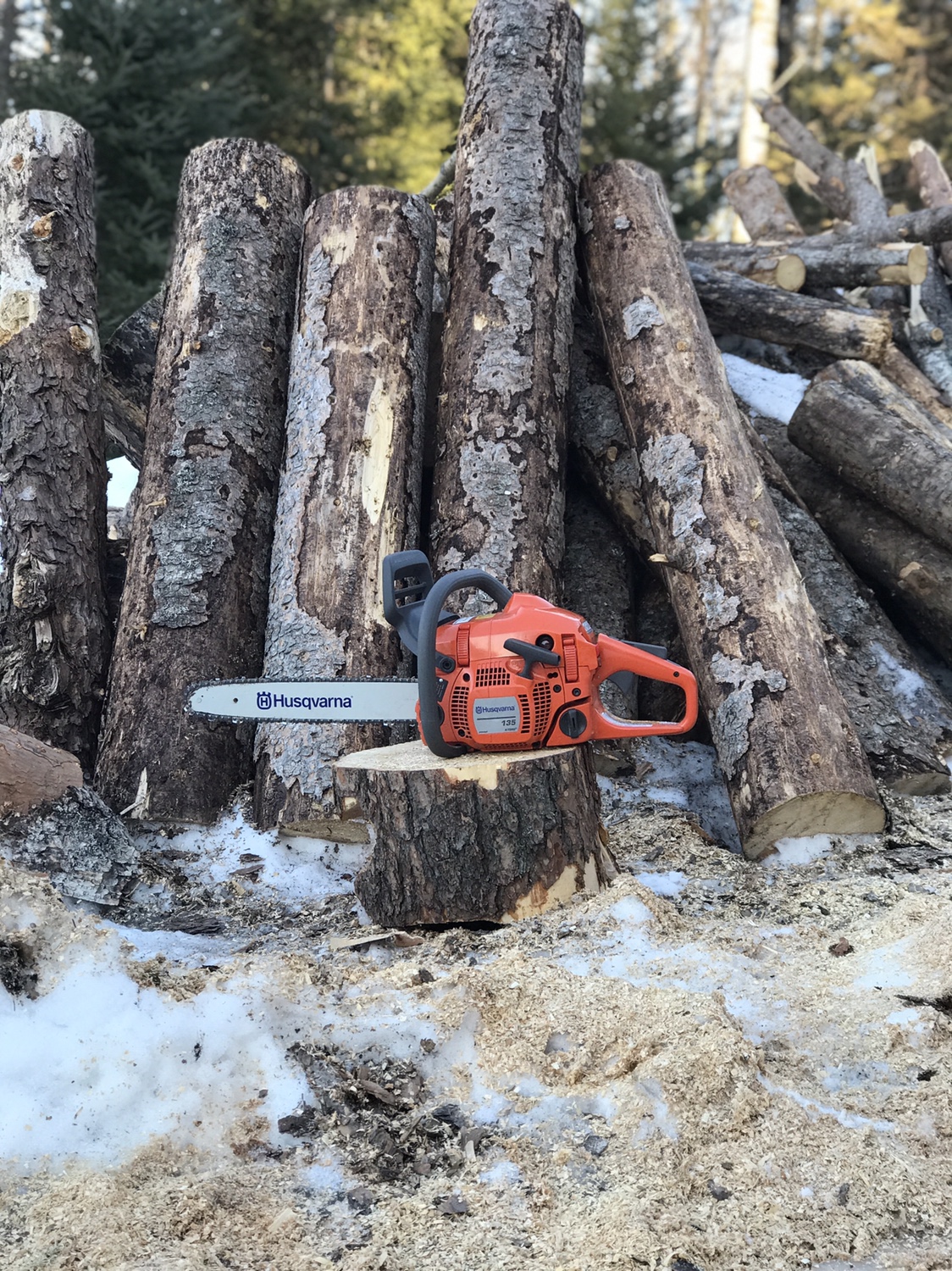

Thanks for the replies everyone! I went down to the chainsaw dealer today and ended up buying a Husqvarna 135. Really appreciate everyone’s input, thanks again! IMG_3245.jpg

Thanks for the replies everyone! I went down to the chainsaw dealer today and ended up buying a Husqvarna 135. Really appreciate everyone’s input, thanks again! View attachment 596992
Let us know how you like it. One thing about the Husky versus lower budget saws like my Poulan is the vibration dampening... the latter doesn't have it, and I really notice the difference.
I watched all the manufacturer safety videos on YouTube before using mine for the first time.
Eventually got three chains, and have the dealer sharpen them. And flip the bar with each chain.
Did you buy chaps and a forestry helmet?

I’ve used it quite a bit now and I love it! I have no complaints!

I watched a few videos myself and have learnt a lot. and yes I did get the chaps and helmet!
