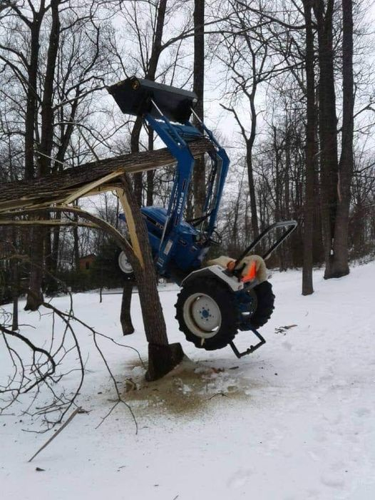

You know the tree you partially cut and it would not go down, so you tried pushing it over with your tractor....
And no it was not me, don't own a blue tractor...

Haircut to go with the barber chair?
Chain above the cut prevents that on species that like to do it. Little hard to see how deep that wedge was actually cut...

So wait, this dude cut halfway through the tree, then started pushing on it up high? Yeah, that's dumb.

I kinda looks like they didn't get the wedge cut, just started, im guessing and the tree settled onto it, before they could complete the wedge or maybe they did it backward, with the wedge cut being second?

Myself, I am guessing the person didn't cut the wedge deep enough, they also obviously didn't take the back cut far enough.
Likely the tree started to barber chair and instead of chaining it, they decided to use the tractor since they figured it was safer.
I am guessing all that based on the lack of wedges in the picture and the depth of the back cut.
More than one poor choice happened to create this situation.

Quick google took me to ODWTM, some actual video of the recovery in there at about 6 min mark.
Thanks for that.
The original photo was not clear as to how this could happen, but the video shows the larger tree barber chaired and caught the loader bucket, and lifted the tractor up off the ground. Actually a believable event.
At first look my mind said PHOTOSHOP FOR SURE...but now I do not think that is the case...after viewing the last bit of the posted video link.

Looks like there's no discernable undercut/notch - looks like there was the first upper cut of a conventional but no bottom on the left side, and then a back cut on the right; in he comes with the tractor to give it a shove, and the tree shoved back.
Without a notch, the tree couldn't rotate on the hinge; and then with the tractor pushing from up above, he got what was coming.
