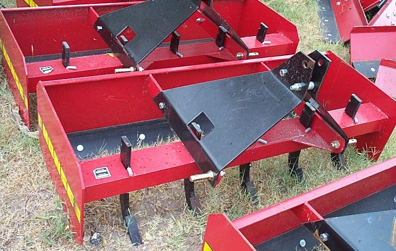

Tscott9330 said:
It seems the week links are the scarifier mounts and the "A" Frame that attach's to the 3pt.
This is the only kind of A-frame that I'd ever consider for aggressive boxblade work. And the tubular scarifier bars are at least twice as sturdy as flat or angular. Your local machine shop should be able to fabricate an A-frame and scarifier bar on this order - to beef up your current box.
//greg//
