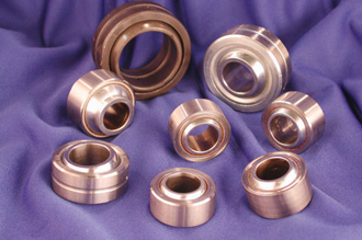

Here's a picture. They are called spherical bearings as Mr Ferguson guessed. Sorry to all for the confusion. Some are ptfe lined but most are metal to metal. Just looking for a general way if any exist to loosen them up. "Stiction" is a great word for these out of the box.

A while back I used lapping compound on some fairly large all metal ones (1" dia shaft) and it worked well. Seems like I started with coarse and then shifted to fine for the last bit. I did not take long. I did not use a drill; I just rotated the ball from side to side with a shaft through it once I got the lapping compound into the joint. Then I cleaned it out with mineral spirits.
But I am concerned that lapping compound could get embedded in the plastic liners of the lined bearings.

Those bearings are not really meant for spinning, but do allow for pivot and some lower rotation rate conditions. It may be seals causing the drag or just dead snug metal to metal. For metal to metal see if you can work some Militec-1 into the ball-socket area.

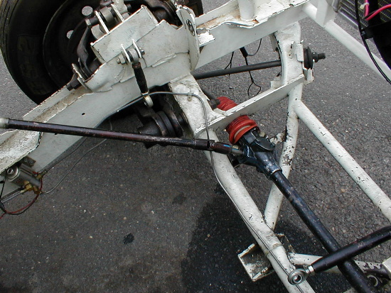

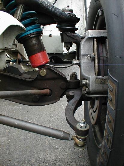

SPYDERLK is right. Spherical rod ends are not supposed to be "free" or "loose" but will have some friction to them. I'm quite familiar with them, but as used in race car suspension systems in place of ball joints, tie rod ends, & other component bushings. "Open" rod ends have less friction than the ones with the teflon seals, but also allow dirt to enter easily & will wear faster. If you must lube them, use a dry lube like graphite, so it won't attract dirt/dust.
Attached is a couple pics of rod ends on a friend's drag car. First is 3/8" rod ends as tie rod ends, second shows two of three 1/2" rod ends; one that keeps the engine located fore & aft (on right) & two (one shown hanging from frame rail) that tie the frame rails & engine together. Shock absorbers also have rod ends top & bottom.
