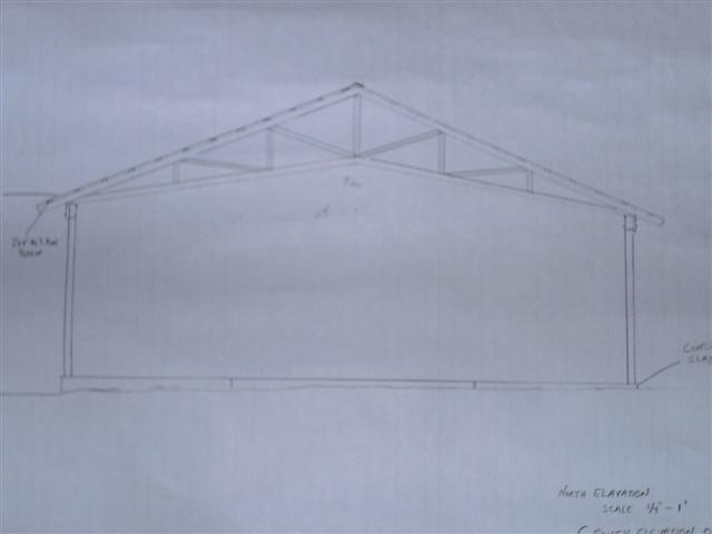

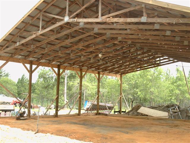

Mudcat,
Thanks for the picture. My understanding on sissor truss design is that the bottom cords have to tie straight into the top cords. As in a straight line to have it's maximum strength. In your picture, I can see that it was done differently. The company that built them for you did a standard pattern inside the cords, but didn't maintain that straight line on the bottoms that I thought was necessary.
There are allot of things that I do just becuase that's how it's done, and has always been done. Not that I fully understand or know why in every instance.
Kind of like putting studs on 16 inch centers. I do it because that's code and the way it's always been done. I have no idea of the math or engineering for it, and obviously the same applies to your truss design.
Thanks,
Eddie

sissors are annalized with a roller on one end so they are forced to be self supporting with no horzontal "tie".
as a concequence you can see "significant" horzontal deflections under full design load.
for instance if i ballparked his trusses right. (60', 2x8 over 2x8, 4 over 2) with 25,5,1 @ 2' OC (about as light as your gonna get) your looking at something like 3/4" horzontal deflection at full load and almost 1.5" vertical deflection. (meets L/240L, L/180T, ie fairly "squishy" truss)
the other food for thought the top beam carring that truss has to support nearly 1000 PLF gravity load. Addtionaly based on 90mph wind, and an "open" building design each truss would need ~654# uplift connection. Else youll find your shed in the next feild over should you get a down burst out of a thunderstorm. :D

schmism,
Any chance of translating that to english???
Sorry, you kind of went over my head there. Are you saying that sissor truss's will move 3/4 of an inch, 1 1/2 inches or just plain keep moving around?
I'm planning on using them in a future project and have allot of interest in what works and what I can do to make it work better.
The lack of horizontal tie, translates into not having a straight bottom chord. Is that right? So the design of the truss allows the walls to move out and in as the truss flexes, or am I making too many assumptions?
My understanding of it revolves around the bottom chord holding the side walls together. This stops the walls from bowing out. It's also why you can use smaller material on the bottom chords than the top chords.
The top chord is tied to the ends of the bottom chords and held in place, creating the angle of the roofline. When the top ends of the top chord come together, you have a complet triangle and the majority of your strength.
Then the bridging is there to eliminate deflection of the chords and tie it all together.
With a sissor truss, I thought the bottom Chord has to run all the way through to the top chord to hold it together. It was my understanding that this is what stops the truss from opening up and allowing the walls to bow under load, or just over time. If the bottom chords are not anchored to the top chords, then there is nothing to stop the truss from opening up.
Thanks,
Eddie

Close, 40' 2x6 tc & bc, .36" horizantal due to live load, .11" due to dead load.
I have 1200# uplift connections.

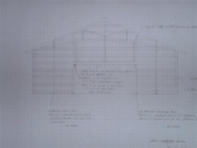

ok guys check it out. (i work for ALpine engineered products and provide engineering services to the truss induistry)
so on a structual gable end (non weight bearing) then the header has to hold pu the sheathing above it. (all roof load is carred by the last stuctual truss)
so at 5psf * ~8' tall = 40PLF on the top of the header.
punch that in the puter and it says a 2ply SP#2 2x8 will work fine.
Technically speaking loaded to 62% capacity with a .66" deflection from dead load at mid pannel and .72" total load (with addtional live load) or L/328 dead L/295 total which exceeds the 480L/240T default defection crytieria
see http://www.snjschmidt.com/pics/header1.jpg for a pic of the actuall computer output
so at min i would use a 2ply SP#2 2x8 beam. Any addtional size will make the beam stiffer and still work.
PS although i dont want to get bombarded with 8million requests i can run any shape, size, loading etc beam or truss configureation you can come up with with any kind of material including TGI's for beams and LVL for both trusses and beams.
(yes i have access to fun toys)
