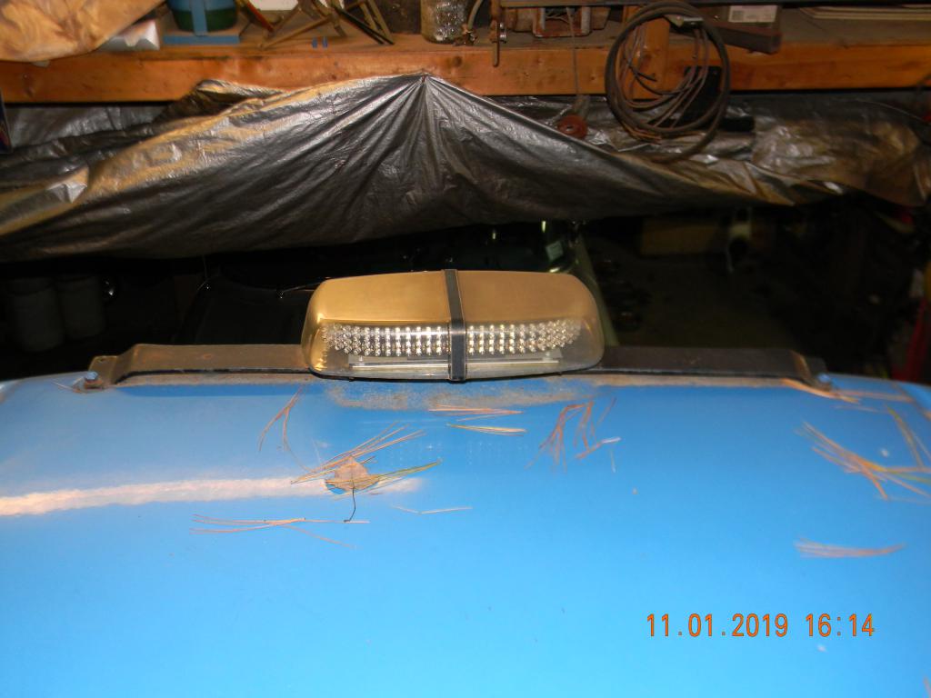

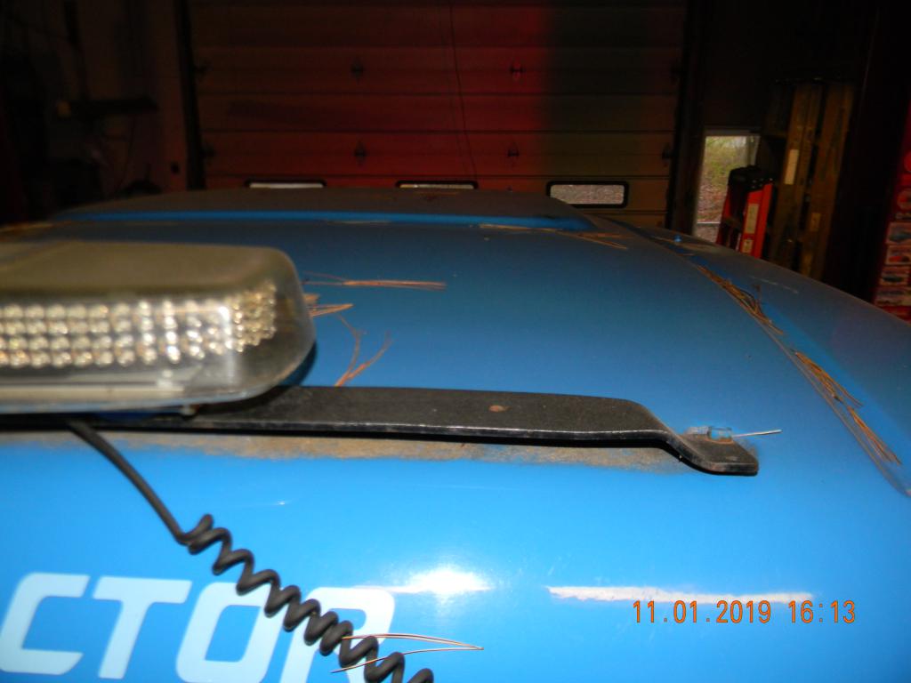

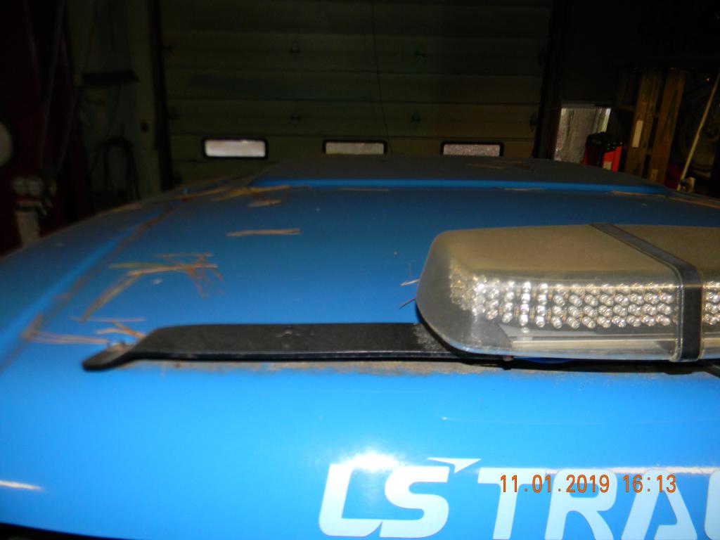

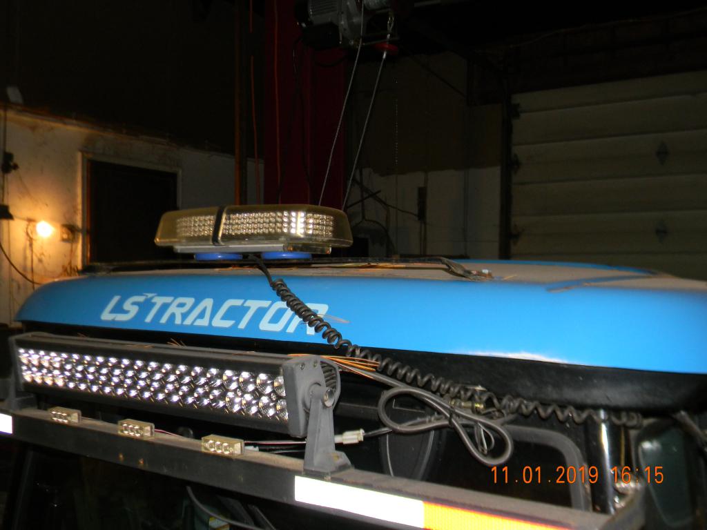

I have an LS with fiberglass roof. It has bolts going thru where the roof hinges up. I made a bracket to fit those holes for my magnetic strobe to stick to. My magnetic LED strobe has 6 different strobes and cost was under $50. I also have flashing strobes under the light bars front and rear. Plus added reflective tape strips all around. If I'm in the road plowing and people don't see me they must be blind and shouldn't be driving.
