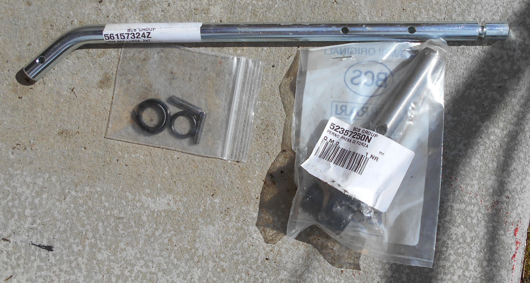

My parts arrived yesterday in a BIG box - I never think of EarthTools as a 'big box store' :laughing:
I bought a new PTO shaft and seal just in case, didn't need them but I may one day.

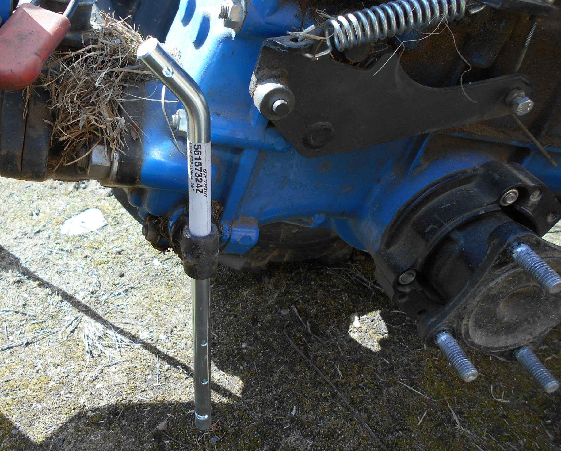

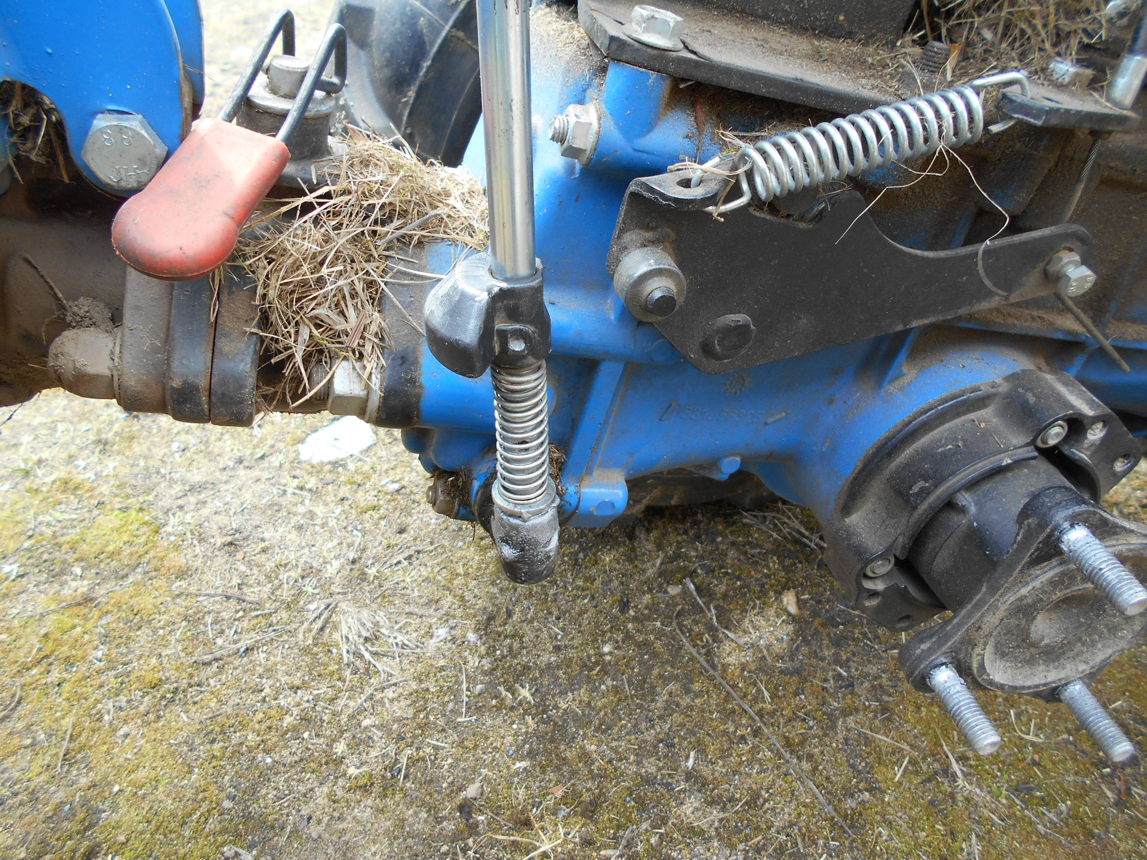

Took a while to clean things up so the lever was free to turn. Coated everything with a generous layer of never-seize, I was able to push the new pin in with big ChannelLock pliers - bit different to taking it out!!
All good now, spent the day flail mowing with no problems.

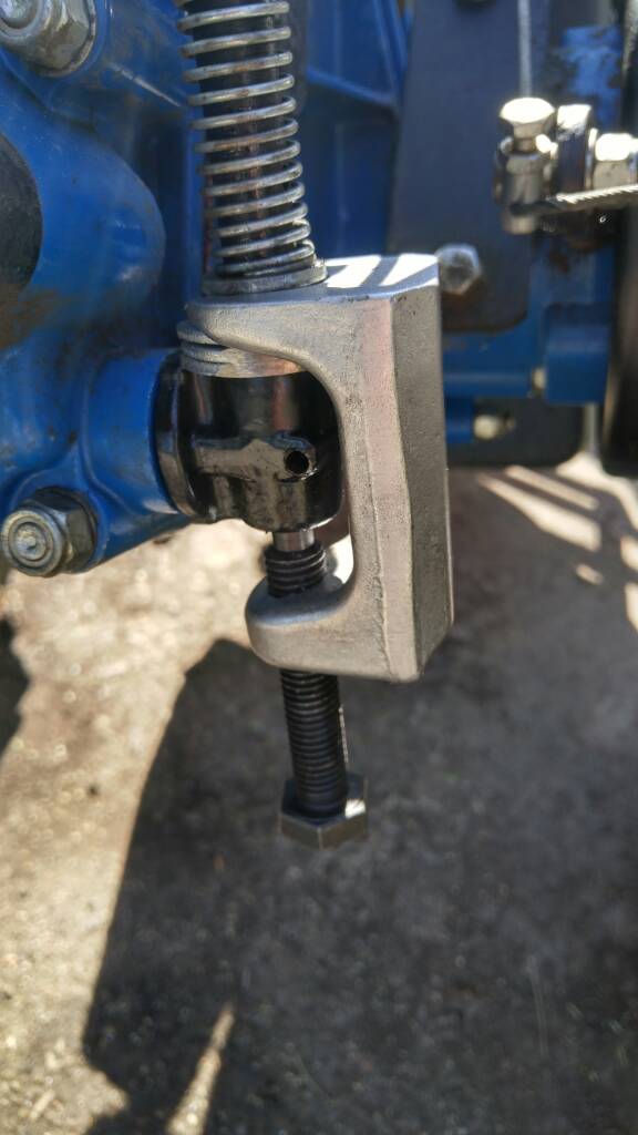

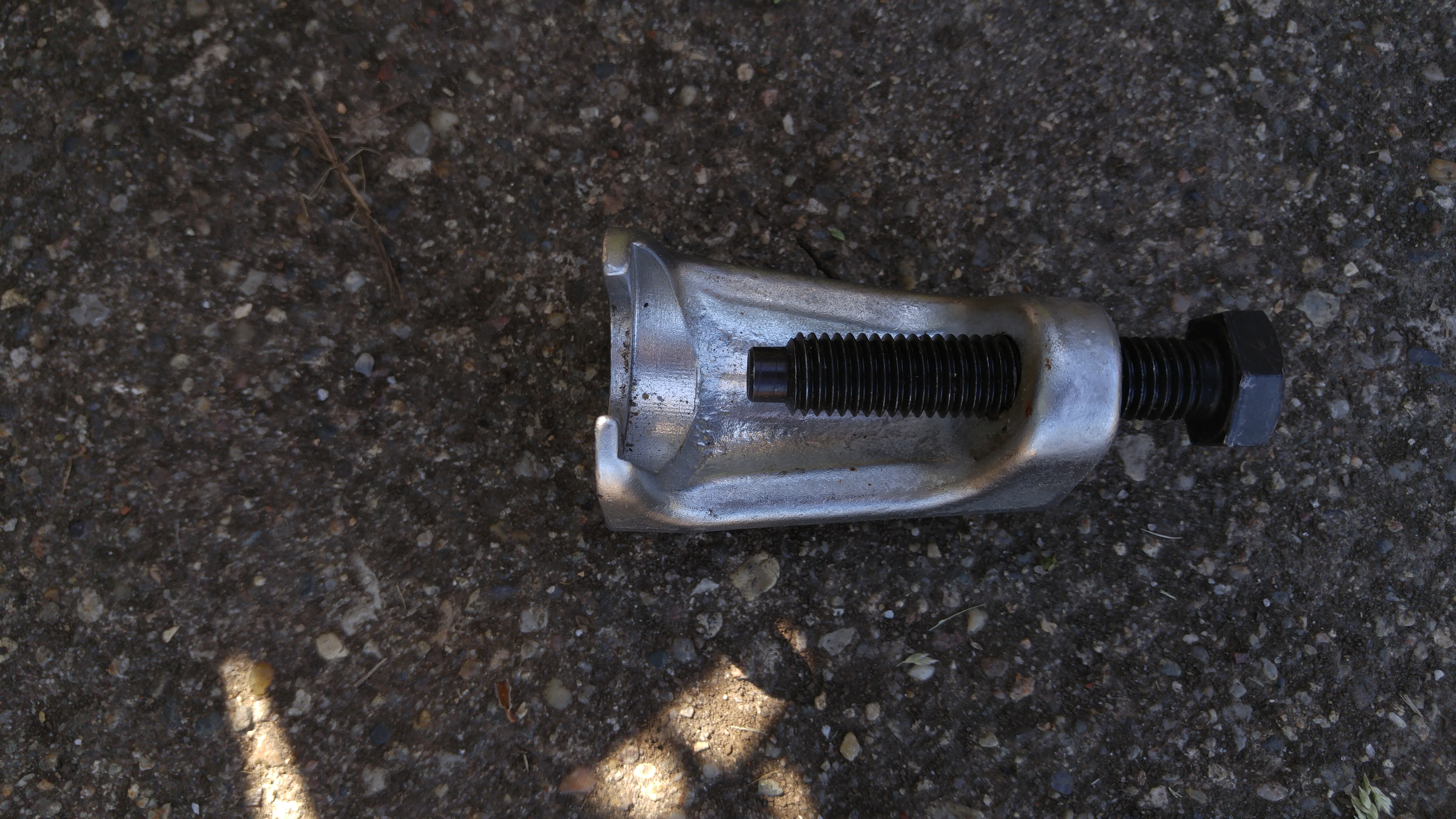

Success! I finally got the PTO shaft out of its socket. I was giving it a few wacks with a hammer, per the instructions from EarthTools download, and not getting anywhere, so I looked at tools that I had purchased when working on the front end of my pickup. The pictured tool with the cut out washers did the trick.DSC_0217.JPG0514191641_HDR.jpeg
