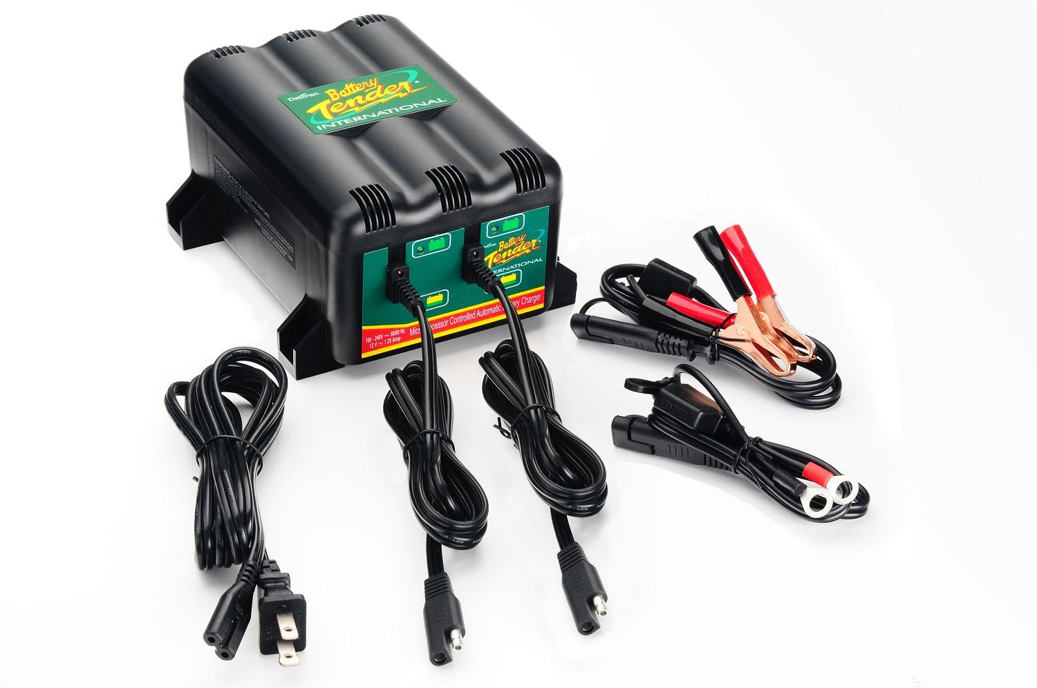

We'll be leaving our 2012 GMC diesel in our unheated garage for a couple of months this winter. Temps often get well below zero and I'd like to able to fire it up when we return so I've been been looking at these battery tenders as an option. Deltran seems to be one model recommended often. Would one of these tenders be a worthwhile/effective option?
Also, the truck has two batteries and I'm actually not sure how they interact. Would I need a tender for both?

Typically they are isolated when the vehicle is off so either two battery tenders or you will need to figure which one is the primary one for starting.
Any of the chargers that have a float option will be fine. I’ve used $10 models and have used models that cost hundreds! As long as they are a smart/float type charger it should do the trick.

This unit will maintain both batteries. You can find it for less than $90 online
22-165-DL-WH

I installed one of these on my Ford diesel, just mounted it to the inner fender well and ran the cord down to where the block heater cord meets the bumper. Does a great job of overcoming parasitic drains and it won't overcharge.
Not sure about the GMC diesels, but the Ford has cables connecting both sides, so only one tender is needed.
