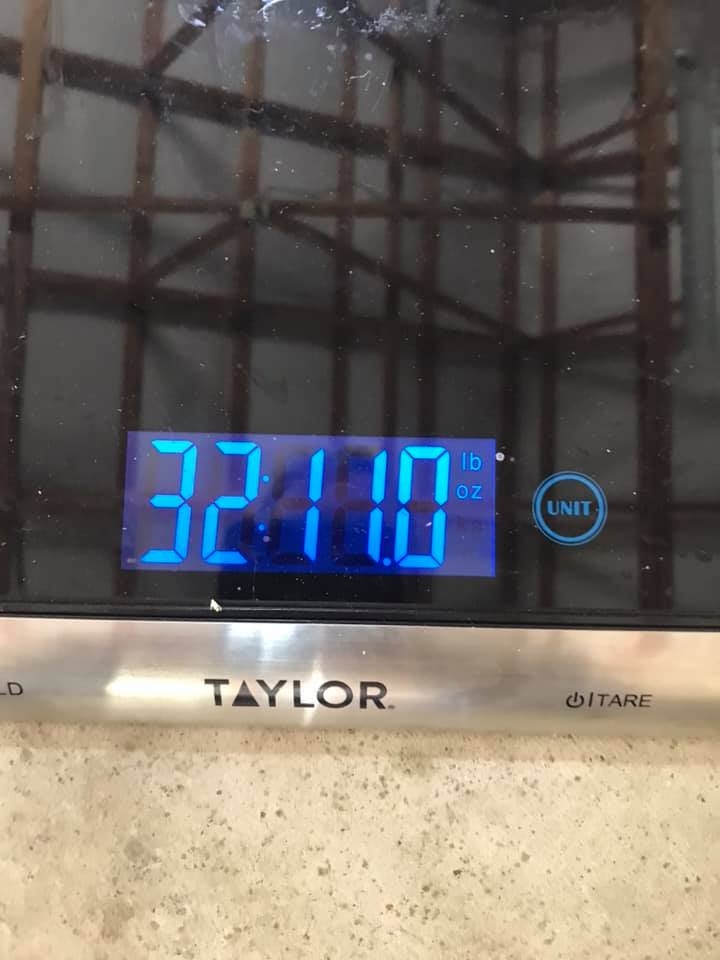

My 88 goes from 22lbs 6oz PHO dry to 32lbs 11oz full of mix and oil and 36" b+c.
You say your saw holds 10.3 lb of fuel and oil? That’s 1.7 gallons, based on most fuel/oil mixes running about 6 lb/gal! The 088 had big tanks, but nowhere near that big. Or was first weight without b&c? If so, what size and type bar?

You say your saw holds 10.3 lb of fuel and oil? That’s 1.7 gallons, based on most fuel/oil mixes running about 6 lb/gal! The 088 had big tanks, but nowhere near that big. Get your scale checked.
Wow ok here I go again. Like I said in post. 🤦‍♂️ :rolleyes: 😂;)🤷‍♂️:ROFLMAO:
First weight is PHO dry like OEM saws weigh them.
2nd weight is as used. Full of mix and oil plus the 36" b+c.
Dang just read my post it is all there first time.

Wow ok here I go again. Like I said in post. 🤦‍♂️ :ROFLMAO:
No. You didn’t say first weight was without bar and chain, and you also didn’t say what size bar. We were comparing 20” saws of half that power, so this is completely irrelevant, even if you had been clear about it.

No. You didn’t say first weight was without bar and chain, and you also didn’t say what size bar. We were comparing 20” saws of half that power, so this is completely irrelevant.
Yes it does. ;) PHO
/ Battery powered chainsaw #690
Yes it does. ;) PHO
Got it. Sorry about that. Missed “pho”.
But again, the 088 is a huge 6.3 kW milling saw, way outside the range of the little 2-3 kW / 20“ saws Greenworks is selling. Is there any battery saw on the market that actually competes with the 084/088?
