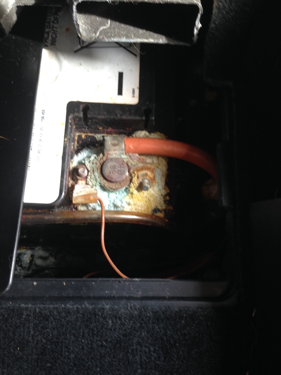

Not just an "I heard" but hard fact. One bad cell causes others to overcharge because the only practical means of limiting charge is voltage. The charging algorithm says, "I need to see 13.8V and I'm going to hammer it until I do."
This is a Mercedes-Benz Original Equipment Bosch AGM with a bad cell which M-B's much touted bad battery algorithm missed. Battery is under front passenger seat and is installed before the carpet. Carpet must be cut to access battery for the first time, has perforation, owner's manual says as much.
That's the first time I've seen an AGM battery with corrosion on the terminals.
