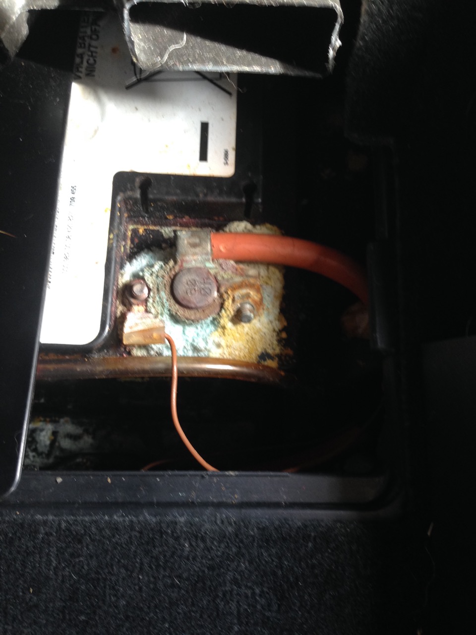

Not just an "I heard" but hard fact. One bad cell causes others to overcharge because the only practical means of limiting charge is voltage. The charging algorithm says, "I need to see 13.8V and I'm going to hammer it until I do."
This is a Mercedes-Benz Original Equipment Bosch AGM with a bad cell which M-B's much touted bad battery algorithm missed. Battery is under front passenger seat and is installed before the carpet. Carpet must be cut to access battery for the first time, has perforation, owner's manual says as much.
The Germans do get some things wrong.

That's the first time I've seen an AGM battery with corrosion on the terminals.
Not sure that's an AGM battery with the vent hose so close.
Most certainly is an AGM. Was the original factory battery. Had to cut the carpet on provided perforations to get to it. AGM batteries have vents too. Look up Group 49.
