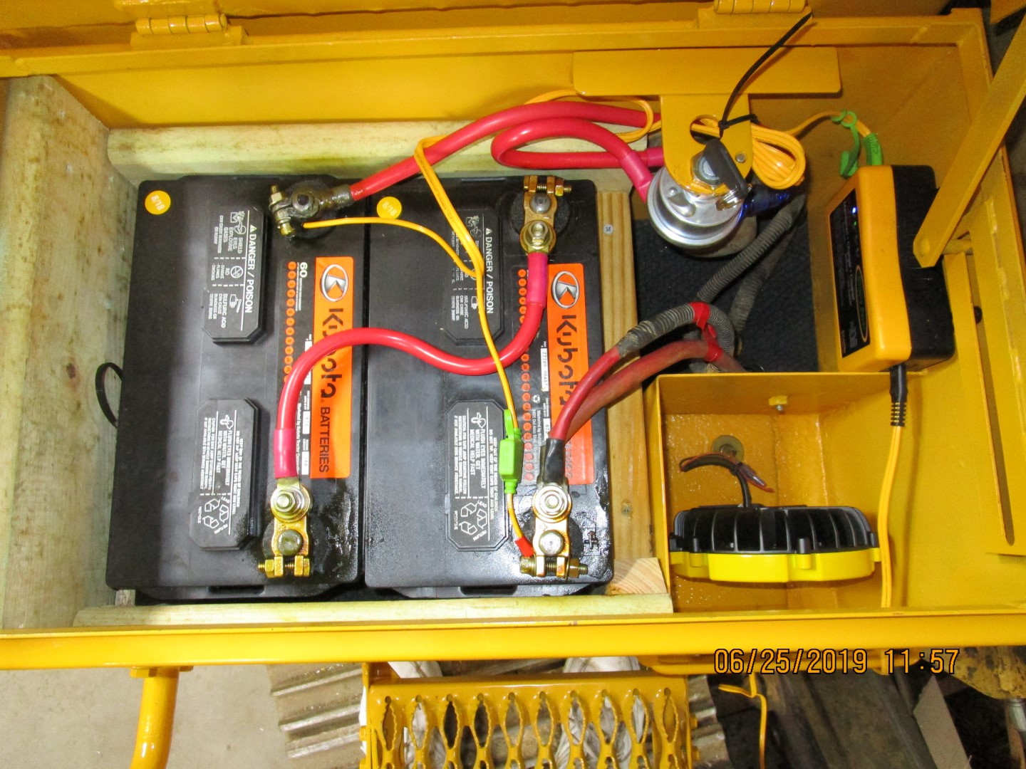

It's on my list of things to do, add disconnects. Especially on my Steiner, where the battery cables go through the articulation point along with the fuel lines.
Good to know that the OEMS are putting it on the GND. Usually that's just easier and safer for exposed terminals.
Note, cheap chinese disconnects (like from Princess Auto/HF) can give you grief.

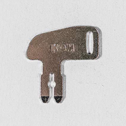

On all are komatsu equiptment its on the ground side, also it is a keyed switch

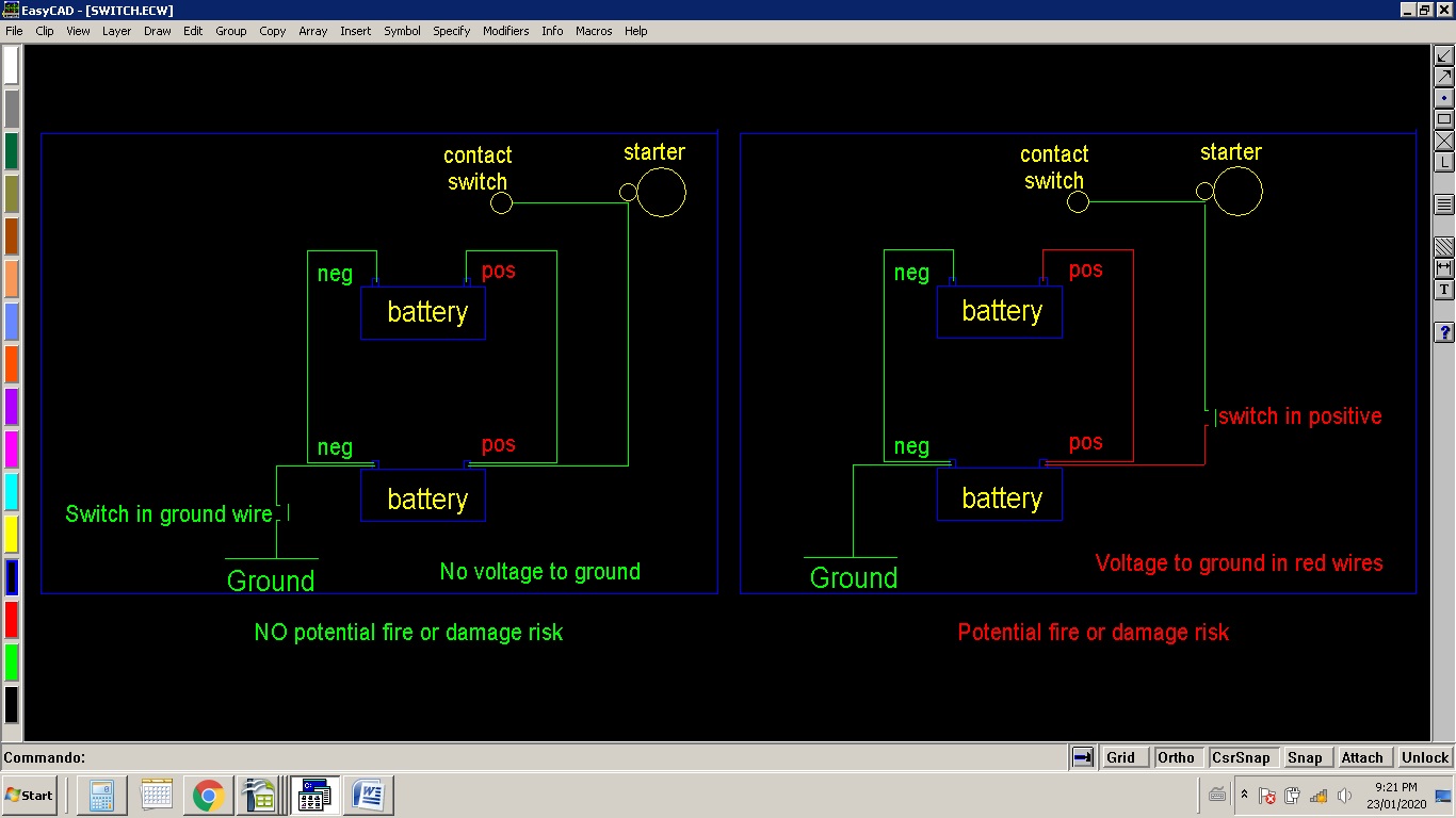

Keep in mind people this whole thing started when OP objected to fact in some applications it is necessary to disconnect positive side of battery and alternator/generator output to shut down a running engine....
Not merely to disconnect battery from electrical system to prevent theft or battery drain or to remove short circuit hazard when wrenching around battery... To remove short circuit hazard ALWAYS remove negative (ground) cable first also avoiding crossing negative and positive terminals with wrench when disconnecting.....

Keyed? Or a Generic key or just a plastic paddle thing?
no a real metal key key.jpg all the keys are the same even the ignition keys a different key but fits all the machines

Could be.
In that case I would still place it in the ground line as it provides the best protection from electrical shorts that could cause fires and equipment damage.
If needed or desired for computer or even radio memory retention a low amp fused line can be added.

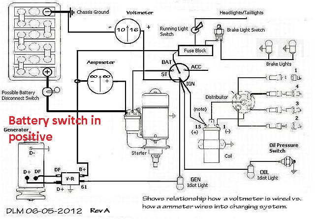

One thing I haven’t read in the thread yet is the effect of cutting battery power if the tractor is running. Not an issue if you only want the switch to prevent parasitic drain, but if you want the switch to disconnect the battery and kill the tractor (gas tractor- Diesel may still run depending on it’s fuel delivery system etc) you can damage some more complicated tractor ignition systems.
There is a kill switch made that performs three actions in one selection - disconnect battery positive line, disconnect alternator output, and send alternator output to ground thru a resistor. These are used as safety devices on most race cars, with a few benefits. Primarily, they can prevent damage to electronics that may be sensitive to sudden power fluctuations. And they shut the engine off when activated.
Commonly referred to as an FIA Kill Switch. Here’s a description “four-post master kill switch is built to FIA specs, This switch has three sets of contacts for cars with alternators. The main contacts disconnect the battery while the auxiliary contacts disconnect the ignition coil and short the alternator output to ground through a 3 ohm resistor that is furnished with the switch. A removable actuating key with splash guard, weather-proof cap, resistor and installation instructions are included.”
This types of switch were mentioned in ammeter thread where this thread was a diversion from...
https://www.tractorbynet.com/forums/owning-operating/421257-ammeter-question-8.html#post5635718

Resurrecting an old post . . . I need to leave my tractor at my land, 10 miles from my home and am interested in a battery disconnect as additional theft deterrent. I am an electrical novice (that's being generous. I know next to nothing about electrical systems). Will the inexpensive plastic keyed disconnect, wired to the negative side of my battery do the trick? Several posts in the thread suggest that these disconnect switches can add problems, but they don't indicate what those problems are.
/ Battery disconnect switch #40
If I ever have the need for theft protection I’ll try replacing the main fuse in the fuse box with a dummy or blown fuse. I figure most opportunistic thieves aren’t going to take the time to diagnose the problem or carry the proper fuse with them.
